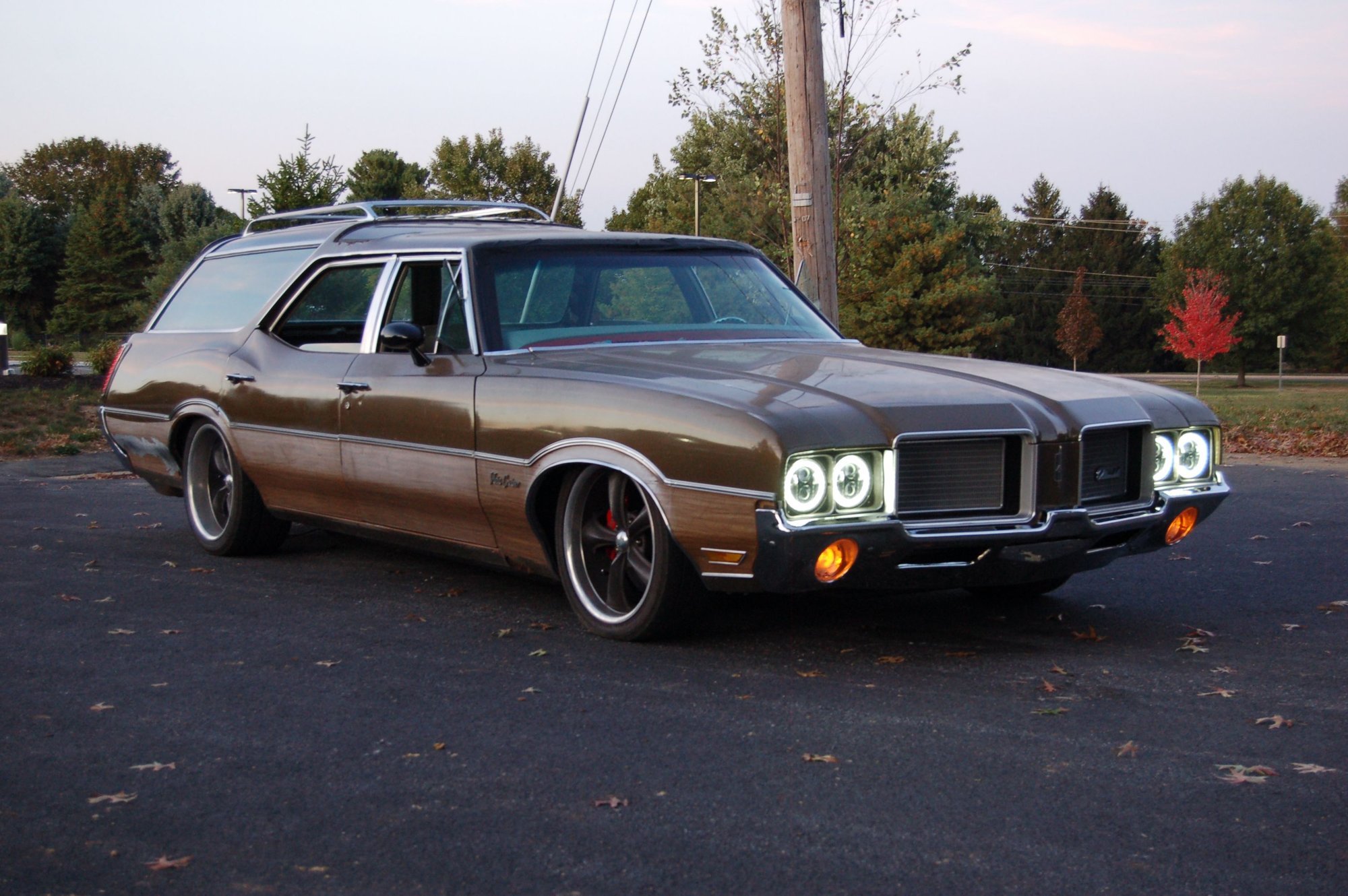

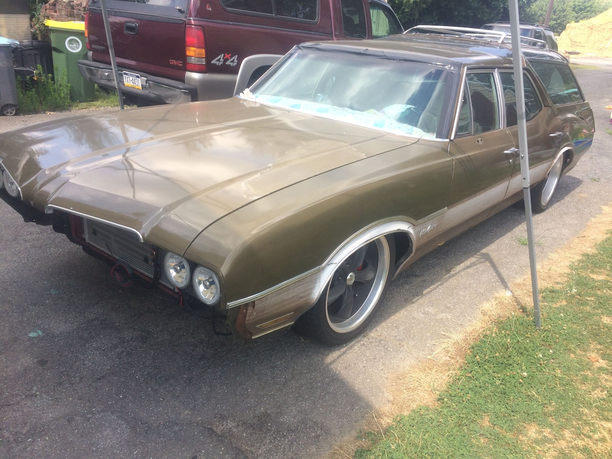

At only $100/set they are a great choice if you want a modern look. The pics below show them in my car "in progress" and finished. They perform great, the high/ low/ and halos are all super bright, but I had to cut the original buckets to where there is almost nothing left due to the large heat sinks on the back.
Before those, I had these. https://www.ebay.com/itm/33353119559...sAAOSwoSxeWqKX They are also super bright. The halo can be set to any color and they do not require as much cutting as the ones shown above. At $250 they do cost more. I got rid of them because I wanted a true white halo and the RGB mix just could not doo that.
Before the above lights I was running the ones below (similar to the ones in this add: https://www.ebay.com/itm/30407864510...gAAOSwpfZg-0nZ). The headlights were nice and bright but the halos were not very bright. In the photo below the halos are on (amber color)
