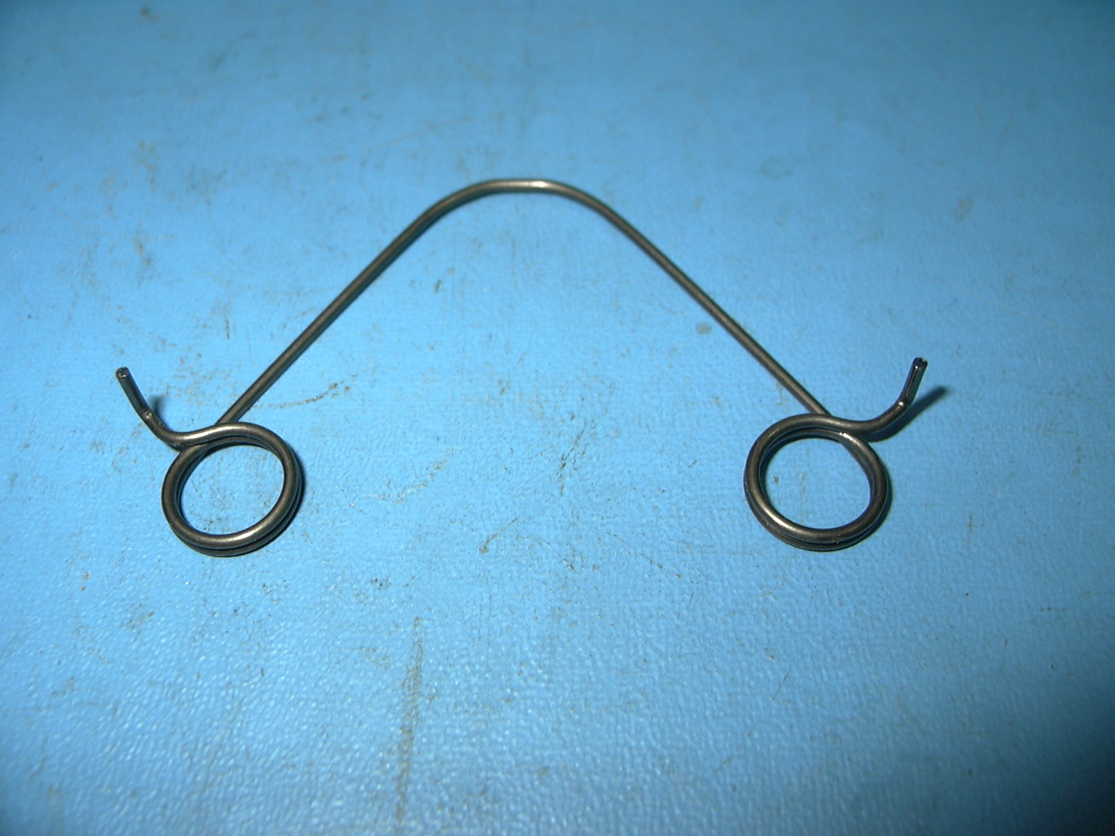

Upon further review, it appears that Octania is correct. It looks like the spring is weak or a little tab that holds it has broken off. Now I need to find the correct spring!! It is like the ones that Octania linked to, but it is one full spring all the way across.

Eric, it's not a "spring" that you would normally think of. Look at Octania's link on ebay. His link shows two springs, but this one is just one spring that has those two curly Q's on the end like those.

Here is what I need. I found it on oldsobsolete: http://www.oldsobsolete.com/products...g-nos-1929955/. Pretty expensive for a spring! Anyone know where I can order one cheaper, I haven't found anywhere else yet.
I'm really hoping that I don't need the whole piece, they list that for $275!!

Interesting. Definitely different from the commonly available springs for later models.
I'm sure someone on here will have one, or else you may be able to find one elsewhere online or in a junkyard.

This is not the kind of part that is sitting on a shelf somewhere, just waiting to be bought. Therefore the high price.
If you can find one at a salvage/jun/bone yard, grab it!
See the msgs posted here by BigBlue63. He is acquiring a '63 parts car. It will have this spring.

$30 for that spring does not seem too bad.
It's just music wire, you could bend one yourself. That'd take a couple hours to get it right. I could extract one from the parts car, but that's $20 in gas and an hour or two to get at it, plus an hour of driving... now the $30 new part looks pretty cheap. It's not like any of us can dash to the local boneyard and get one from a partially dismantled car these days.
You could always try "millions and zillions" and pay oh maybe $400 for a broken one.

I'm thinking about purchasing the ones you (Octania) linked to on ebay. I think those may work the same as this one. The wire in between the two "curls" doesn't seem to serve a purpose and the ones you linked should fit securely in the place where it mounts. I'd only be out $7. The only question is "are the curls the right size?"

It's a cheap gamble, but, frankly, I doubt if the TS switch will have the proper holding tangs for the other style. I reckon that connecting piece serves a function. Any chance your original part is just out of place on one end? Something easy?

I can't figure out exactly what is wrong with it. If it is not the spring itself, then the hole in the cam has gotten "wollered" out. I didn't want to risk breaking the spring by removing it. The TA springs are supposed to be in on Monday, so I'll let you guys know!

The spring in question is made of a pretty substantial gauge of wire. It is very unlikely that removal would cause it to break.

IT WORKED!!! You can use the springs in Octania's link. Once I took the old one out, I checked it out. It wasn't broken, but I think it had just lost its tension. When the rod would come back by to cancel the signal, the spring just didn't have enough "uumph" to move the cam back into position. I put the new ones in and it works like a champ!! Thanks for all the help guys!! Now on to pulling the engine next week

This is an important factoid that needs to be filed away: Newer-style cancel springs will work in place of the hard to find older springs.
