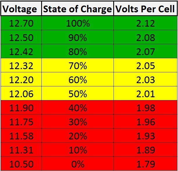

hey so in my 75 88 , its been sitting a while and i get no spark. do you guys think that battery dropping to 10.5 volts during crank would stop the coil from making any spark?

I drove my car with no alternator until the battery was so low that the engine died (below 9 Volts) , so I doubt that 10.5 Volts would result in no operaton at all.
But that is a very low battery (practically dead) so connect a charger and bring it up tp full voltage and try again.

Dead battery....

First, since you're in Alaska, make sure the battery didn't discharge so low that it froze. I've never known anyone to save a battery that had frozen. Jumping it could cause a battery explosion which you do not want.
If the electrolyte is verified to be liquid, slow charge the battery till it starts taking a charge, 2 amp rate or at as low a charge rate as your charger can be set. Preferably out of the car.
Once battery voltage is up to about 11.5v, you can then charge it normally.
