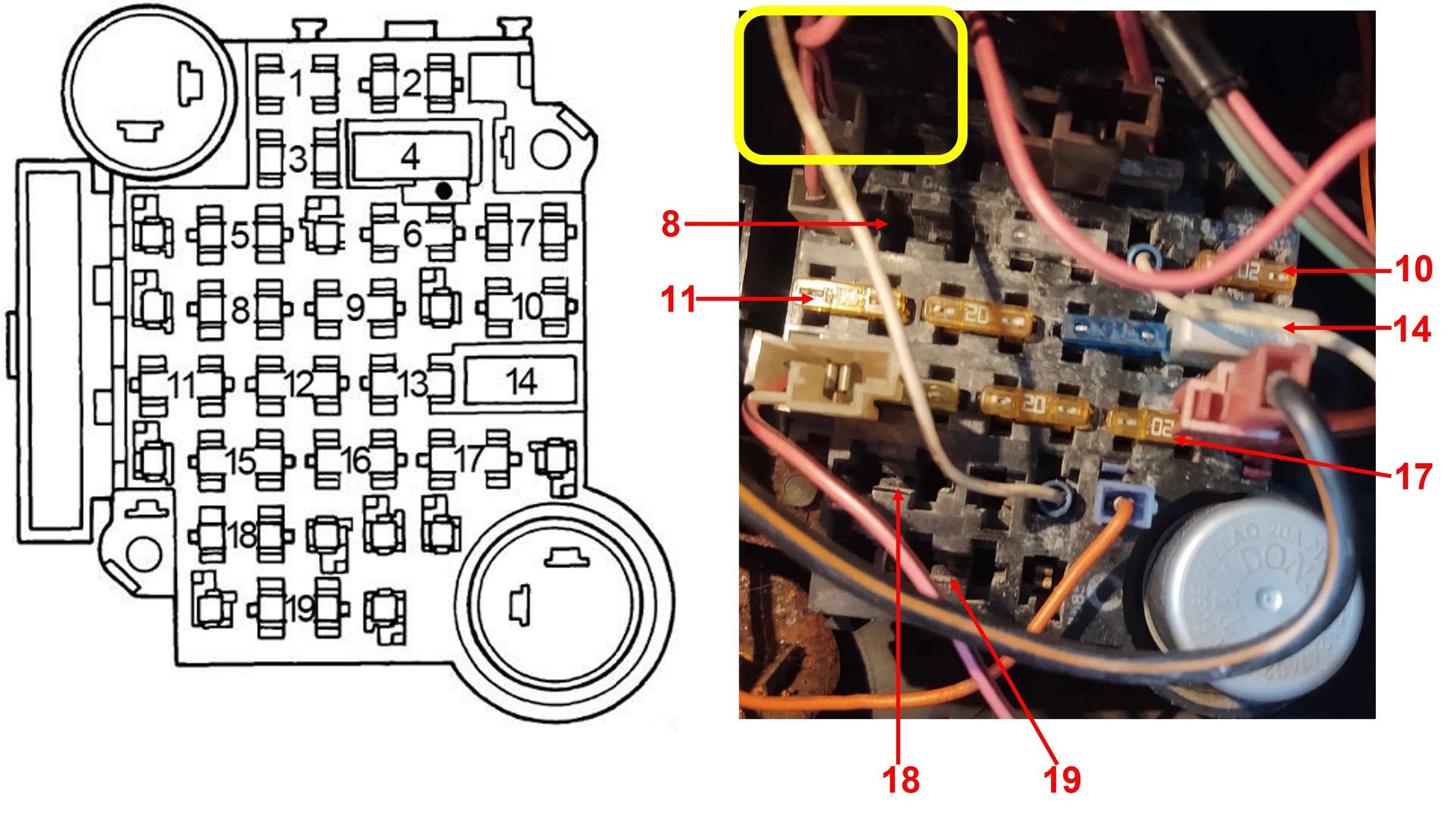

Take a picture of your fuse panel/box/block & post the picture.

If the OP would post a picture of the fuse box, it can be validated whether it resembles this image of a non-authoritative fuse box - waiting...

Old Jul 14, 2023 | 05:17 PM
htrdlncn's Avatar
Joined: Jun 2023
Posts: 24
The one in the picture is for the turn signals.
You take it out : no turn signal
put it in : turn signals work
I see no other spot to put another can in.

Where is the top half of the fuse box?
Old Jul 14, 2023 | 06:05 PM
htrdlncn's Avatar
Joined: Jun 2023
Posts: 24
Thats as far as I could get in today to take picture,,as I mentioned my back is killing me,,Ill try and get camera further up tomorrow..
If my back is not too bad Im gonna pull out the drivers seat to fix the slider on it (its rusted tight) which should let me get in under dash easier.
Old Jul 14, 2023 | 06:35 PM
Posts: 26,063
OK. What I was attempting to discover is whether this is the correct OEM fuse box for the car. "If" it is, then there should exist an additional flasher in the upper left-hand corner of the fuse box (identified by yellow box) - but that yellow box area is not visible in your image. That's why I asked where's the top half of the fuse box. Same as what Bill was suggesting but the fuse box we're working with is not an authoritative source - so, we're trying to validate. It sure looks like the same type of fuse box - more research evidently. You don't have the Owner's Manual or the CSM for this car?

Thanks to everyone that helped, the position for the can is as the picture shows in top left,there was nothing plugged into mine which made it hard to find ,crawled in there this morning and found it,terminals looked a little toasty so cleaned them well with electronic cleaner and got a new can in there and Voila,hazards work again!
