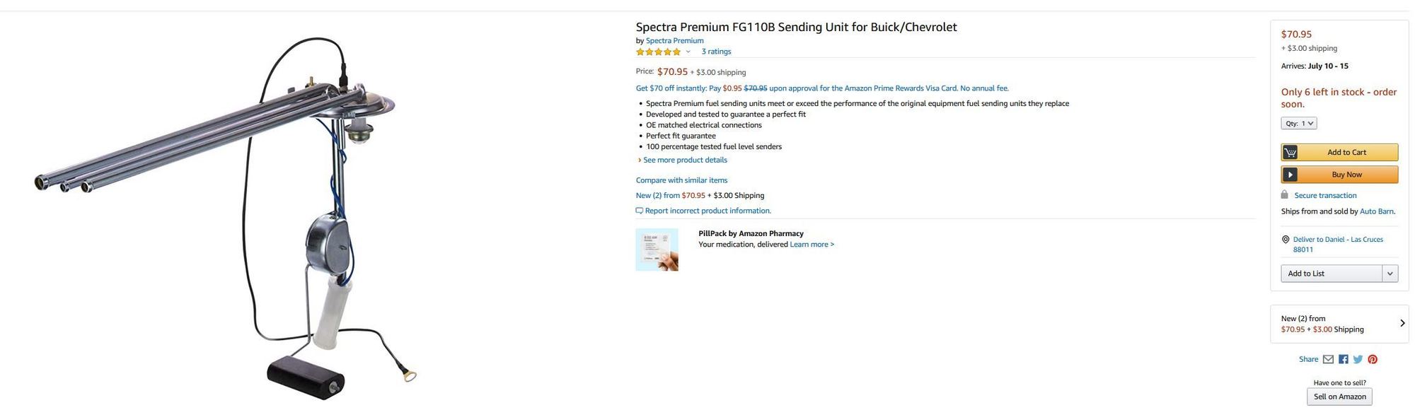

If Rockauto has it, it's likely your local auto parts store can also get it. Check with O'Reilly or Autozone or NAPA or whatever. You'll likely have to order it and have it delivered either to you or the store, but someone is likely to have it.
Old Jun 30, 2020 | 01:01 PM
jaunty75's Avatar
Posts: 15,187
From: southeastern Michigan
Amazon has it in stock. It turns out that this is the same sending unit that my car ('78 Toronado) uses. I bought one of these in 2017.
