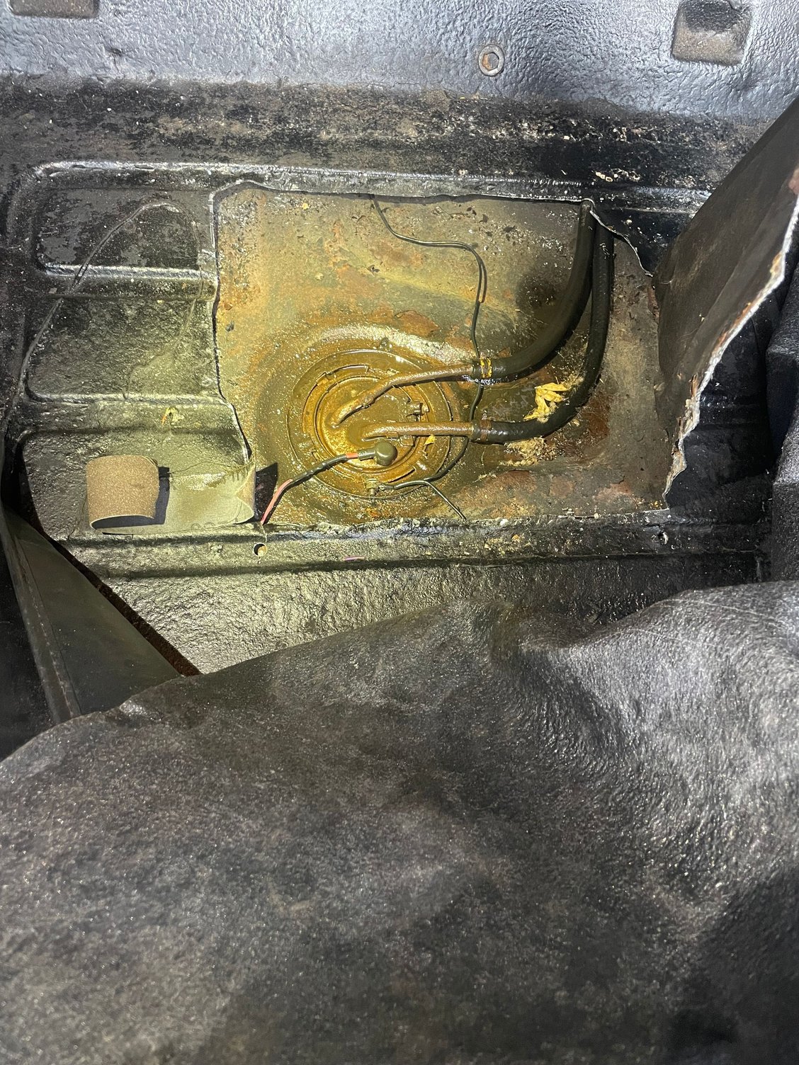

Bringing back a old topic here
I’m sure my sending unit is acting up
what is the best way to remove this
drop tank ?

i really don’t wanna drop the tank but I think there is a bad wire
i may cut a square on top of tank in the trunk and see if I can see anything

Yea, I considered your option. May or may not work. Dropping tank isn’t that bad of a project. Getting the fuel out is one of the biggest parts of it. Run it dry like I did, carry a gallon with you. Just enough to get you home. Then, the tank is just 10 pounds or so. I will encourage you to remove the tank, and check everything while in the area. Old rubber fuel and vent hoses likely need new ones.
If you do need to remove replace the sending unit, it will be difficult working through a hole in trunk. The locking rings on the sending units take something like a punch and hammer to turn them sometimes. Tough to do working through a hole.

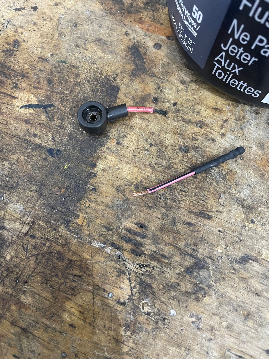

Well decided to tackle this tonight
Sender wire connector on top of sending unit is bad. Not sure how that goes bad but
replaced it and now it works fine

Ahh, the guys are having a little fun with this. I get it. Not what I would have done. But it did work for you. Clean up the cut lines all four sides. Make a 20 gauge patch 1” bigger all the way around. A few Sheetmetal screws…..Silicone will be hard to take apart if you wanna get back in. Some butyl tape would work great.
Maybe you can clarify for me? I thought you said that the fuel line was on bottom of tank? Have you abandoned the fuel lines in your picture? Just using fuel level part of the Sender?
Old Jun 20, 2025 | 05:58 AM
79cut's Avatar
Joined: Sep 2024
Posts: 321
From: Canada Ontario
yes. I have electric fuel pump. Not sure. Where the existing hoses go
