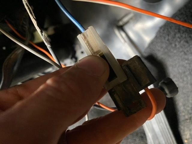

Electrical connections under dash
Trying to finish up my install on my M&H harness under the dash of my 67 442. It was so long to get all the back together I don’t remember where some of these go or how they are routed.
I also can’t read the correct amperage for the fuses anymore on the fuse block. Some references would be great
Should these go together and there is another spot for another wire to go in this junction?

Does your car have a console? That connector with the orange wire probably plugs into a cavity labeled batt. It will only fit one way, and into only the proper cavity. Then any other accessory that needs constant power (clock, under dash courtesy lamps, etc) plugs into that connector.
If you have a assembly or service manual there are detailed illustrations.

I’m not sure what the blue wire /clear connector plugs into.

The blue wire looks like a rear seat speaker wire. Does your radio have the fader **** behind the right hand station ****?

Actually, the connector on the orange wire is a "piggyback" connector. It's used to splice an accessory into an existing circuit. Orange is always hot and powers the courtesy light/dome light circuit. I'm betting that wire runs to something like the under dash courtesy lights. Find a single terminal male/female connector in the orange wire circuit, unplug it, and plug that in between them. Clock feed is one such connector.
