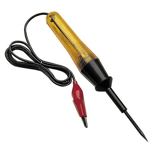

Do the taillights work? The taillight circuit provides power to the dash lights. Blown fuse for the taillights=no dash lights.
Get a common 12 volt test light. Pull the headlight switch, check for power on both sides of the dash light fuse. Make sure the dash reostate is turned all the way up.
Old Yesterday | 03:47 PM
Posts: 25,654
x2
Like this...
