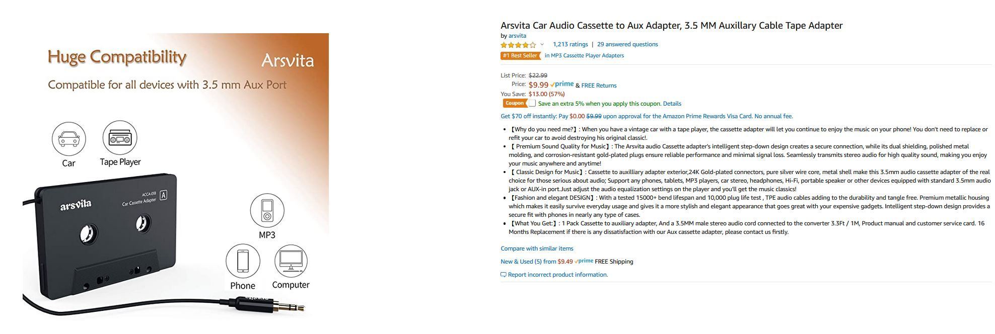

I didn't know you have an aftermarket cassette player. Does the cassette player part work? If it does, you might be able to skip the whole FM transmitter thing by getting one of these. $10 at Amazon. You slide the cassette-looking part into the cassette player, and you plug the jack on the end of the cable, which sticks out of the cassette opening, into your audio source. So your line-in is through the cassette player.

The cassette to aux adapter while interesting does not appear to offer me what I am primarily looking for which is hands free calling capability or phone charging. Or am I missing something?

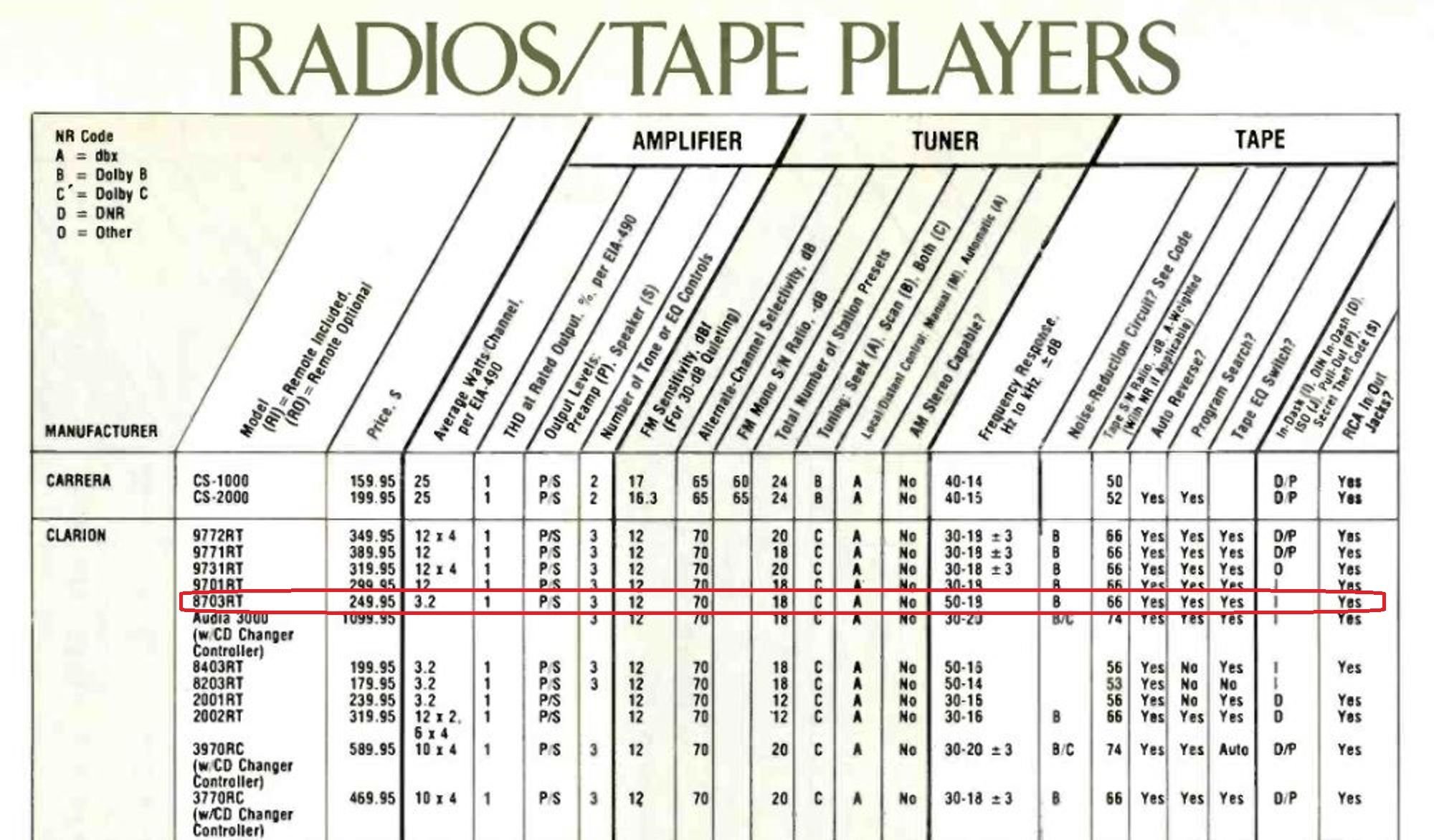

Now what you really need to see is this. Here's the section for Clarion car audio, and your model, 8703RT, is listed (and originally listed for $250).. I've circled its line in red. Look what is says in the far right column under "RCA in/out jacks?" It says YES.
Have you ever looked behind your radio? These radios sometimes had RCA jacks, often at the end of a short cord, that extended from behind the radio. If they weren't used, they were often taped to the back of the radio to keep them out of the way. You might crawl under your dash and see if you can see behind the radio. You might very well have RCA connectors at the end of short cables.
The cables will often look like this. They'll be reversed (female) so you can plug in standard male RCA plugs. They'll be at the end of short (6-inch?) cables.
If your radio does have these, all you need is a cable like this to plug into it, and you can run a cable from your phone or any other device right to your radio. You don't need Bluetooth.
Having said all of the above, I do have a question. In looking at your radio, I don't see a button or anything to select the RCA jacks as the audio source. But I don't know what all the buttons mean. (What's "AS/PS" or "R/T?" I'm guessing they're not for selecting the input, but I thought I'd ask.)
But I should also say that the radio in my car does not have a button to select the AUX input as the audio source. Rather, the radio automatically senses when something is plugged into that jack and automatically switches to it. If I want to listen to the regular AM or FM radio, I have to pull the cable out of the jack. Maybe yours works the same way.
Or maybe your radio doesn't have these jacks at all and that magazine article is mistaken.

Jaunty, I crawled under the dash today to look for the RCA cables or jacks. After a fair bit of contortion I spotted what appeared to be a white and red RCA jacks on the back of the radio. So your research on the unit is quite correct. Although how I would ever get up in there to plug them in without dropping the lower dash is beyond me at the moment. If there was an easy way to just drop the entire ash tray assembly it would make it possible and easier to do. Gotta check the manual to see if just the ashtray assembly can be dropped.
I assume that this radio would be like yours and automatically switches to the AUX channel if something is plugged in.

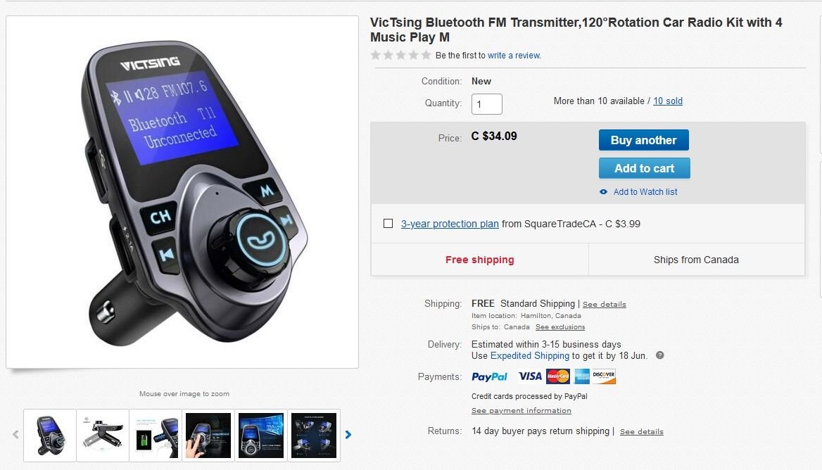

So I did order a bluetooth FM transmitter. Was a good deal at $34 Cdn which equals about $25 US and it was free delivery. Seems to offer everything I am looking for. Will handle bluetooth, USB, micro SD card and has an AUX port. It gives me hands free calling and charging and has the added feature of being adjustable to change viewing angle with a decent size screen. Heck it apparently even shows car battery voltage which is kind of neat. Here is what I ordered a VicTsing T11.

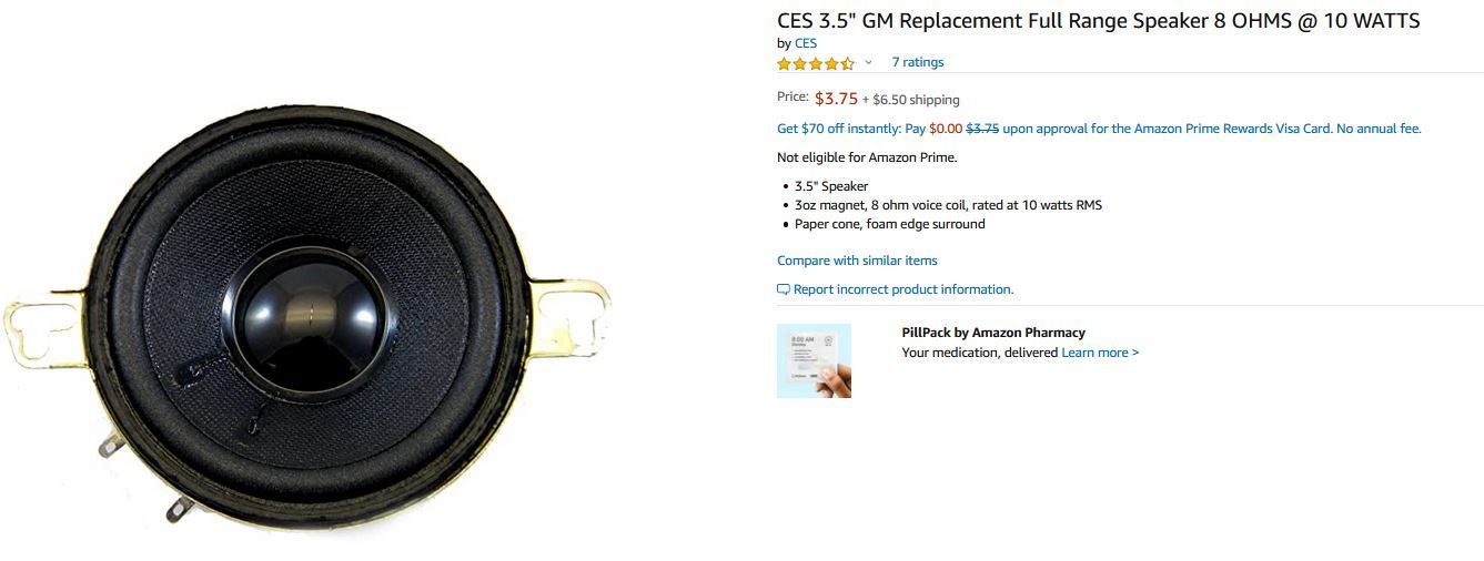

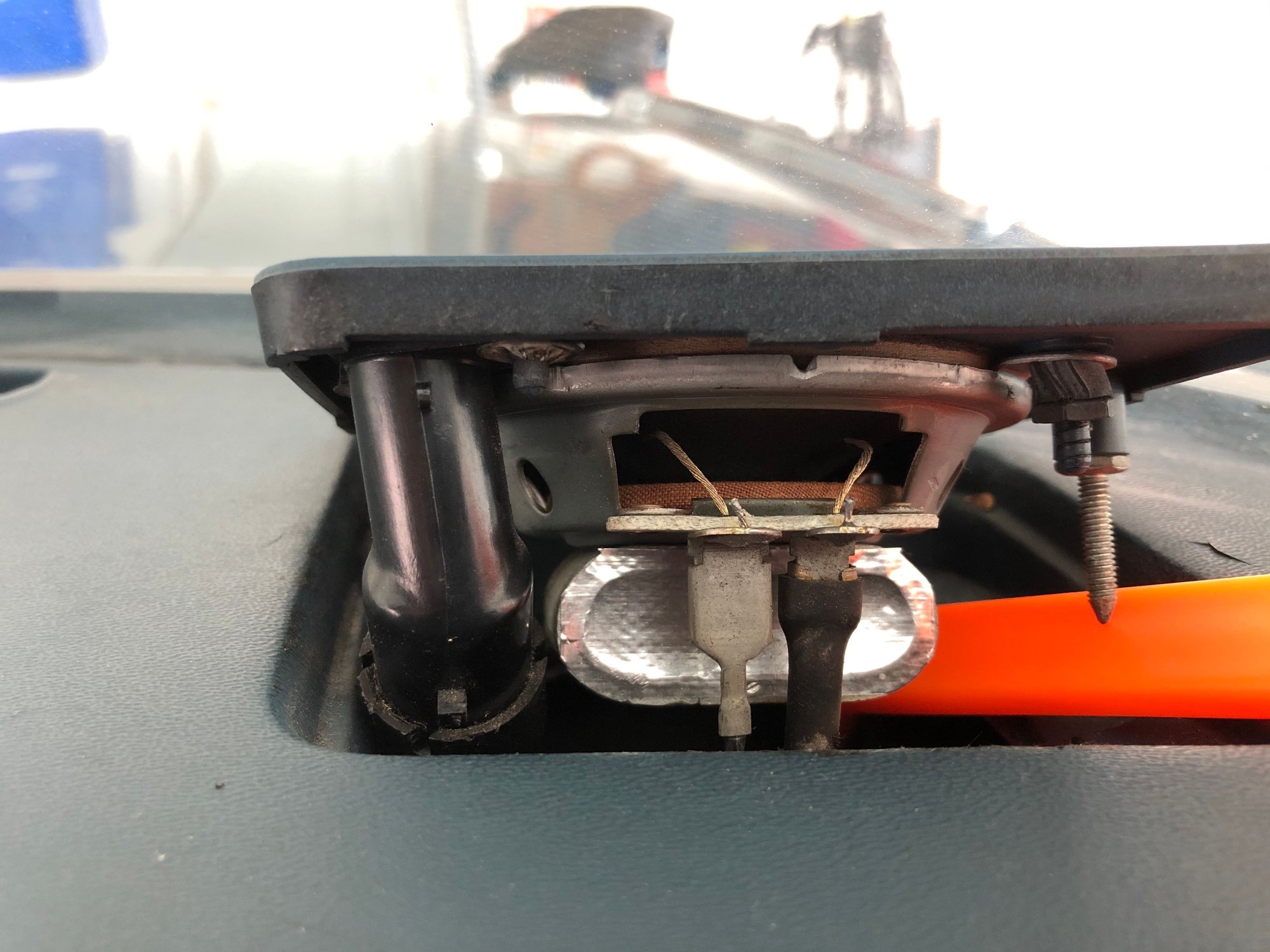

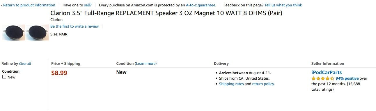

As far as the front speakers, I replaced both of mine with these from Amazon. Very inexpensive and work great. If you're going to replace one, you might want to just replace both. Your originals are equally old, and it's good to have a matched set.
Getting at the speakers is easy because you do it from the top of the dash. It's a little tight to get in there sometimes because of the slope of the windshield, but just get a 1-inch wide putty knife or something like that and go around the speaker grille cover and pry it up. It will come off with the speaker attached. You can pull of the connectors and remove the speaker and grille completely from the car. Then unscrew the screws that hold the speaker to the grille. Then, as the manuals always say, installation is the reverse of the removal process.

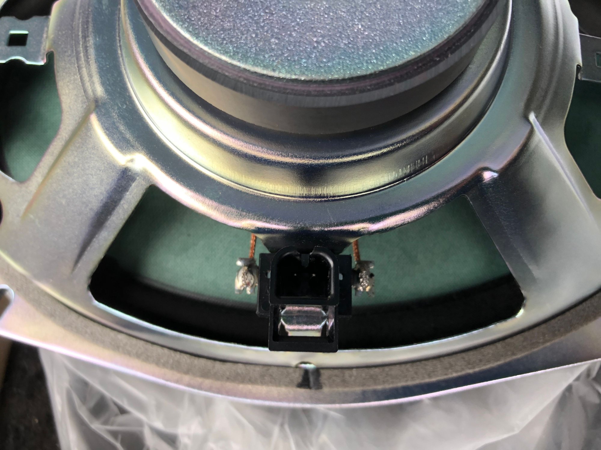

One thing to note is that the connection points on these new speakers are smaller than the connection points on the original speakers, so the spade-lug connectors on the wires you pull off likely won't secure nicely to the new speakers. What I did was to solder a short length of wire to the connectors on the new speakers and crimp onto the other end of each wire a male spade lug of the same width as the lugs on the original speakers and connect those lugs to the radio wiring you pulled off earlier.

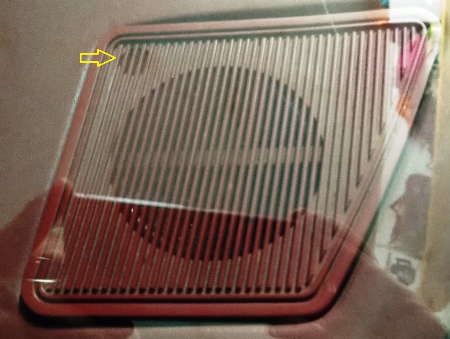

One other thing to note about speaker removal is that the right side speaker is also the location of the temperature "sensor" for the Tempmatic and Comfortron air conditioner. This is easiest to see if you look straight down at the speaker from outside the car. See the photo below. The yellow arrow shows the location of this sensor. It's not really a "sensor" in the sense of being anything electronic (this is the late 1970s, remember, not the 2020s). It's just an opening where a tube attaches underneath that leads down under the dash to the A/C system. Air coming through this tube is how the system knows what the cabin temperature is. When you remove this grille, that tube will be connected to it as well. Just pull it off. It's just a press-fit rubber tube. Remember to hook it back up again when you reinstall the grille.
If your car has the standard Four Season A/C system, it might not have this sensor, so the tube might not be present. I don't know for sure. My car has the Tempmatic, and this tube is there. Whether or not your car has the sensor or not, the the little opening in the grille shown in the photo might still be there because they probably saved money and made only one grille in these cars, with the opening for the sensor, and just left the sensor unconnected on cars that didn't have Tempmatic or Comfortron. Remember that the same upper dash was used on all full-size Oldsmobiles from 1971 through 1976 and all Toronados from 1971 through 1978, so that's a lot of cars that might or might not have needed this tube.

I went out and checked and I have that little circle in the speaker grill you pointed out. Once I get it out I will know if there is a tube attached. Thanks for the advice on how to pop out the speakers and the lead on what to replace them with.

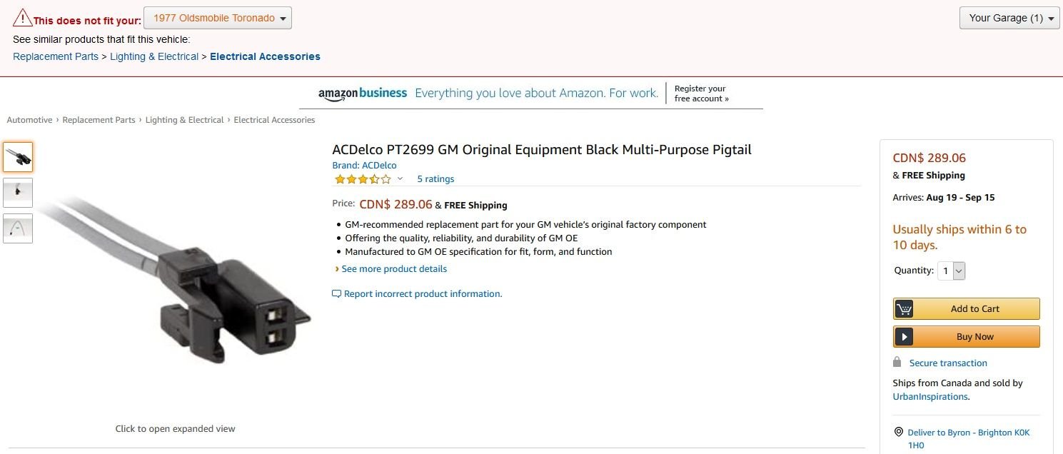

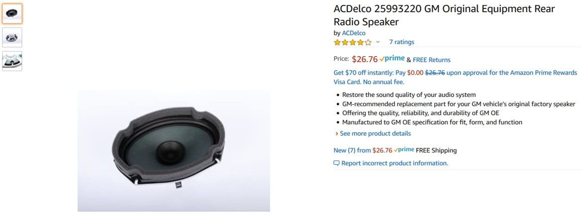

My problem with A/C is nowhere near as costly as yours at this point, I hope. My issue is finding someone who can crimp the hi and low pressure lines and work around the bends coming out of the muffler. I can find the right hose and the ferrules but no one can crimp with the bends in the lines from the muffler. So now I am looking to cut the metal tubes just before the bend, have new hoses crimped on which they should now be able to do because it will fit into their crimping heads and then get the aluminum tubes welded back together, without the heat destroying the new hoses. I have a friend who is pretty good at welding aluminum and thinks he can do it. In fact he would prefer that I try and track down a length of the aluminum tube, have it crimped and then he will bend the tube and weld to the back of the muffler and thereby stay well enough away not to have heat bother the new hose. Then the trial and tribulations of purging and refilling the system and hoping it all holds together. But that comes after wipers, power locks, mufflers and now new speakers.

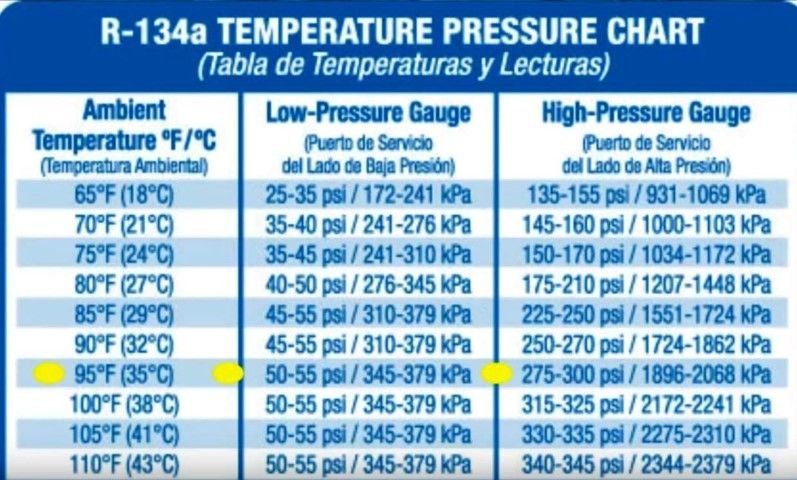

As far as refrigerant amount, I had read something similar to what your mechanic said, but the number was a little different. I read that the amount of 134a you need about is about 90% of what the listed R12 capacity is. But I was not able to get anywhere near that much into the system before the compressor started squealing.

The refrigerant amounts are not comparable between R-12 and R-134a. You should be able to search the internet for a starting point. You will need a set of R-134 gauges to get it right though. Charts are available for the pressure vs. outside temp so you can get the refrigerant right. R-12 is very frogiving and easy to work with compared to the 134 stuff. If you don't have good air flow through the condenser, the head pressures can spike dramatically. You need to have gauges on the high and low side to know exactly what is happening. R-12 systems can be over-filled without much concern but the R-134 systems need to be charged almost exactly right or you can damage parts. Most of the oil will reside in the compressor so to remove it, the compressor needs to be removed and drained as completely as possible then the new PAG oil can be added, reseal the system, vacuum the system to evaporate moisture, then charge with R-134a refrigerant. There are a few other important items to consider but that covers the major events of a conversion.
I know. I have one. Here it is.
I did. See my posts above.
I do appreciate your advice, but I'm not looking for advice. I only talked about the saga of my A/C system because Byron asked. I'm not interested in trying to resurrect the system now because I would likely need another new compressor, and I don't want to buy one now, especially since I don't know what I would do differently, and I don't want to send another one to the graveyard. With the one I put in the car most recently, I did everything the manufacturer said to do about the type of oil to put in and how much.

The pressures on that chart seem extremely high! When I worked in an A/C shop in Phoenix I dont remember ever charging a system up to that high pressure. There are a bunch of different charts available, I just looked, and there seems to be two different scales for R134. If you ever get back to it, find one of the charts with the lower pressure scale. Even in Phx, we only saw pressures 10 or 20% above R12 when working right. 🍺

Well my VicTsing T11 Bluetooth FM Transmitter (as shown in an earlier post) arrived today. Ran out and plugged in to the car and set about setting it up. Was a piece of cake to pair it with my iPhone 8 and to select an unused FM frequency. Tested out tunes and hand free calling and both worked great. I did not drive far so can't really comment on FM frequency issues at this point but that is something I can live with. Just having hands free calling in this old car is a real treat. Based on my short test I would say this is a great little unit and would recommend it.
The one thing I did notice is that my front speakers are really sad, the right one especially has a lot of crackling. The backs don't sound too bad with no apparent crackling. I tried to order the CES 3.5 inch front speakers Jaunty found on Amazon but they won't ship to Canada. Found another pair of Clarion 3.5 inch speakers that will ship. Kind of like the idea that these front speakers will be the same brand as the radio.
Would also like to do the rears but finding something affordable that ships to Canada seems to be a challenge. There are a bunch of used ones on eBay but i would rather have new. So will start with fronts and see what may come along for the rears.

So after waiting almost 6 weeks all my new speakers arrived. I could not get the CES 3.5" front speakers that Jaunty recommended because the seller would not ship to Canada. But I did find a set of Clarion 3.5" 10W @ 8ohm front speakers that appear to be a perfect match for the aftermarket Clarion radio (Model 8703RT) that is currently in the car. This is what I got.
Installation was per earlier advice pretty straight forward at least on the driver side. That crazy tube on the passenger side is giving me grief. It has to separate. Just have to keep after it. If anyone has any tips or tricks would love to hear them. The one mod that I did have to make to these speakers was to bend the tabs down 90 degrees in order to get the speaker to drop in the hole. The tabs on the speakers were a nice fit for the existing wire ends so no extensions were necessary. Here is a picture of the crazy tube that is driving me nuts. It is on the left side in the photo.

Those speakers look fine! To get that tube off, can't you just stick a wide, flat-blade screwdriver into the gap at the top of it and twist the screwdriver to force the tube to slide downward?

I don't know how well that would work as there appears to be clips on the posts that it mounts to. If I force them off by prying then I will probably lose/break the clips or mounting posts. I am wondering if I grip the lower portion of the tube with vise grips and then try twisting the whole grille and speaker assembly off. It seems like that hose assembly should come apart at that point.

Also had a go at replacing the rear speakers. I ordered the GM #25993220 speakers from Amazon that was referred to earlier. But while they mount ok the speaker wire connector does not match the connector that is currently on the car.
This is what the new speaker connector looks like
But the existing speaker wire connector looks like this
I have looked all over the internet to no avail. So my question is has anyone done this conversion and where did you get the new connectors and is there a manufacturer and part number that you can share.

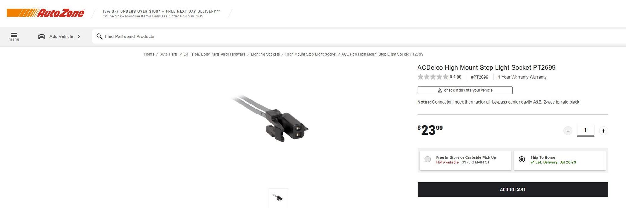

Byron, we got ya covered! I installed these same speakers in my car, and they had the same female connector plug on them. You need this item. One end plugs right in to the speaker. The other end terminates in bare wire, and you can cut the connectors off the end of the wiring in the car and splice this connector to it. Then just plug this into the speaker.
It's called a high-mount stoplight socket by this vendor, but if you just search under the part number shown (ACDelco PT2699), you'll probably find other vendors.

I'm trying to remember how I found this. I think I started by looking for speaker connectors for 1978 GM and then started moving up a year at a time (1979, 1980, etc.) until I found one that fit. As I recall, it was something for a mid-'80s car.
Amazon calls it a "multipurpose pigtail," but they don't seem to carry it any more. They show one external vendor who wants $126. I don't know what that's all about as it is certainly available cheaper.

Thought you would get a chuckle out of this. I checked Amazon for this connector and check what they want for this part. Absolutely crazy!

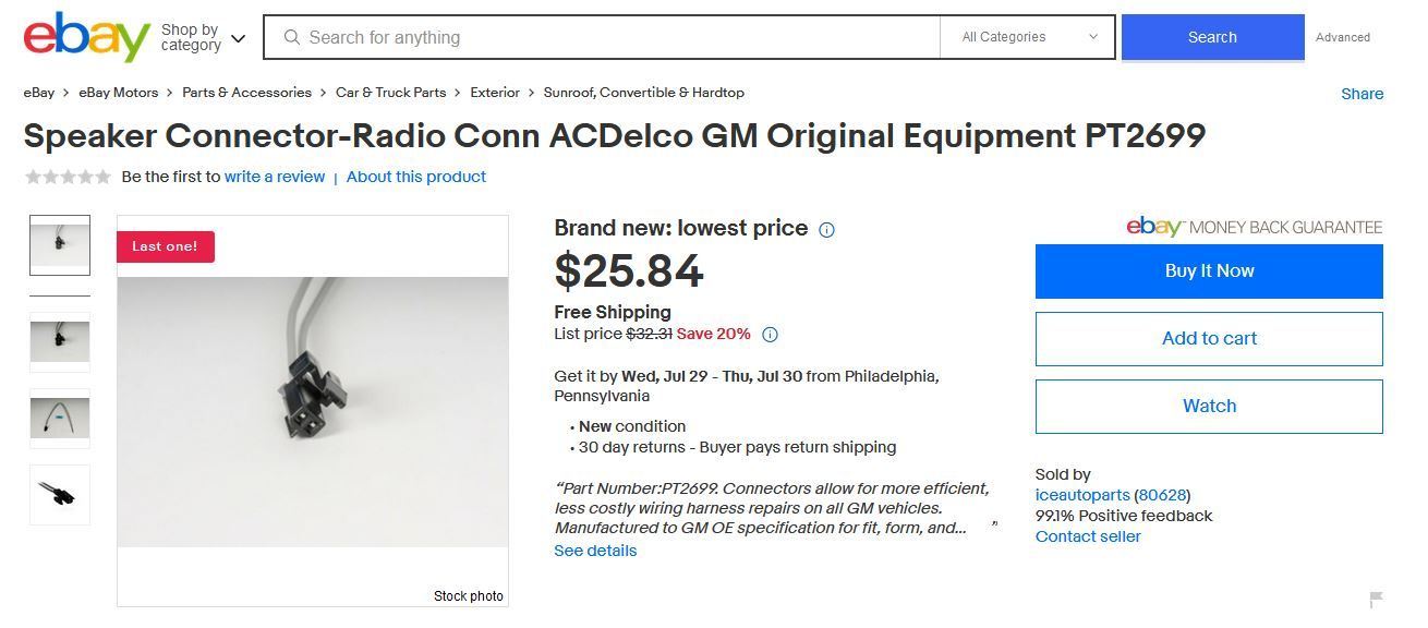

Yes, I saw the high Amazon price, even on the American side. I bought mine back in February of last year, and I paid something like the Autozone price, about $20 apiece for two of them.
Here's one on ebay right now. Seller says he will ship to Canada. He's got only one, though, but it would get you half way there.

I saw that on eBay as well but really want 2. Getting halfway there really doesn't help much. I called Autozone but they won't ship to Canada and they have no stock in their warehouse in TN. They suggested I get a US zip code and then check store by store. Why on earth I would do that if they won't ship outside the US is beyond me. Summit Racing list the part for like $15 each plus shipping and will ship to Canada but they are not shipping domestically or for export until Aug 24th, so I am guessing they are waiting for stock. Maybe I should go to few wrecking yards and see if I can find some older GM vehicles that I can cut the parts out off. The listing for these rear speakers refers to 2005-2010 Chevy Cobalt. Maybe I can find one.
