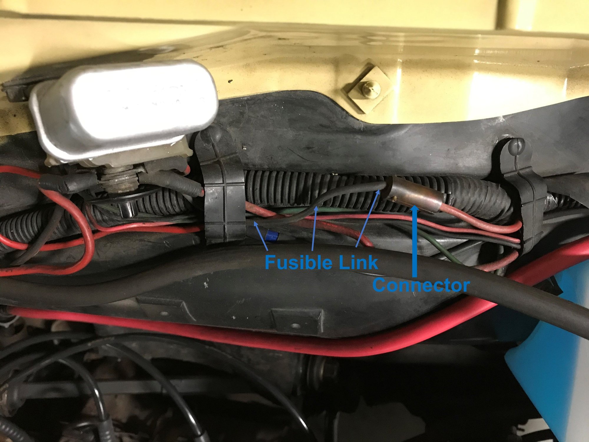

Image of the OEM factory fusible link in my 1971 CS. NOTE: The actual fusible link is the short black wire in this image.

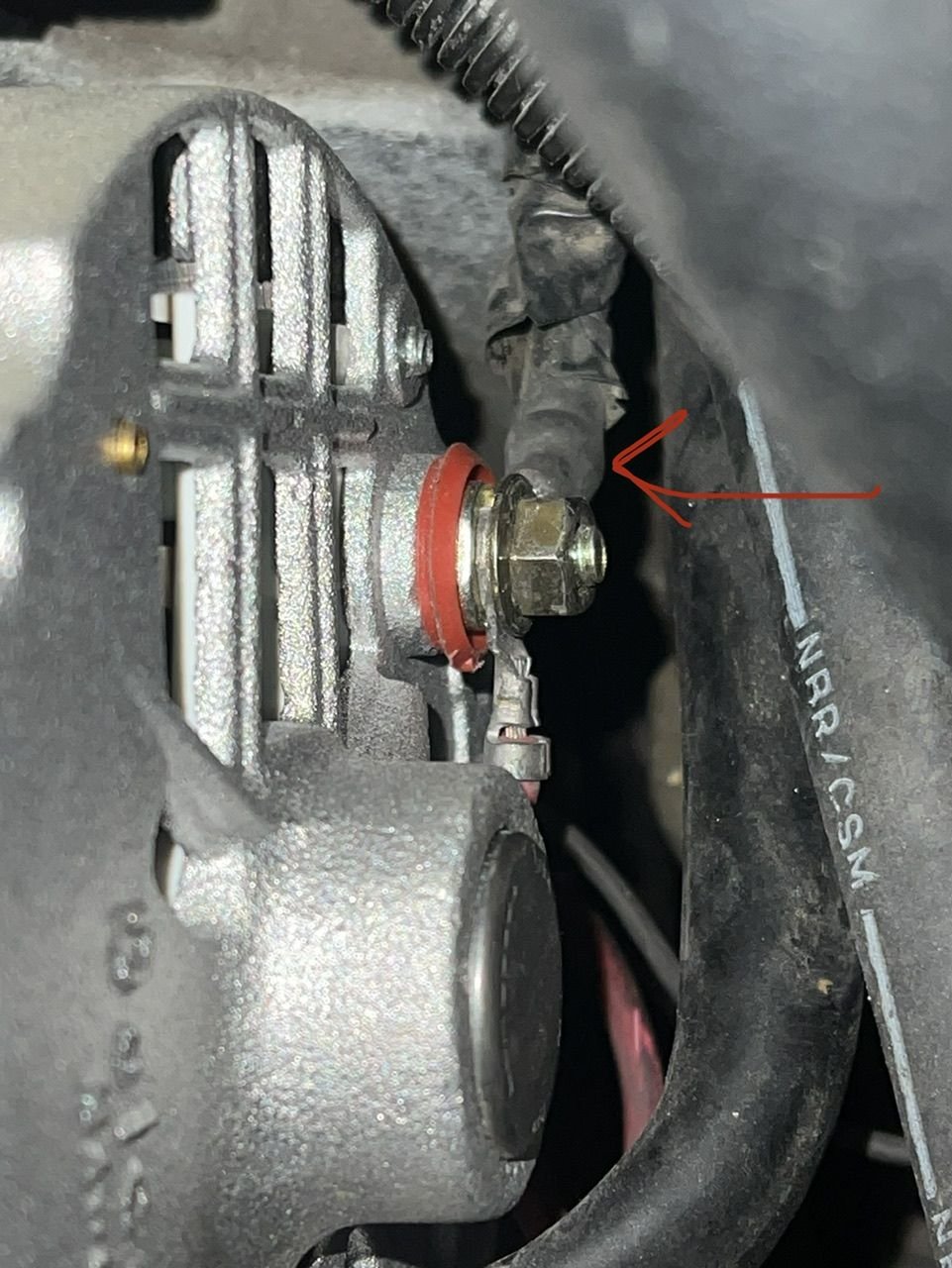

upon further inspection, of the two small cables that attach to the post on the back of the alternator, it looks like one of them (the one that goes to the positive battery terminal), instead of having a circular connector at the end, had a “C” shaped one. At some point when re attaching the nut, the cable fell off of the post. When I then reconnected the battery, the loose cable arced on the alternator and a big spark was seen at the battery as well. I have the battery out of the car and am going to test it tomorrow at work, (I work in a parts store). Voltmeter should be waiting for me at home once I’m off.

Originally Posted by mrtoronadoman
upon further inspection, of the two small cables that attach to the post on the back of the alternator, it looks like one of them (the black one), instead of having a circular connector at the end, had a “C” shaped one. At some point when re attaching the nut, the cable fell out. When I then reconnected the battery, the loose cable arced on the alternator and a big spark was seen at the battery as well. I have the battery out of the car and am going to test it tomorrow at work, (I work in a parts store). Voltmeter should be waiting for me at home once I’m off.
You're not out of the woods, yet; but, hopefully you'll come through modestly unscathed. Two considerations: (1) Always disconnect the (-) negative battery terminal cable anytime you're working on electrical; and, (2) you'd be well served to change out the "C" terminal end w/ a proper enclosed circular end terminal wire connector.
Apologies. Rereading your statement I missed the point where you actually had the battery disconnected. $hit happens, eh?

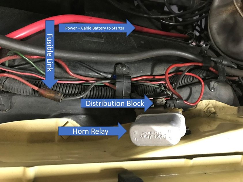

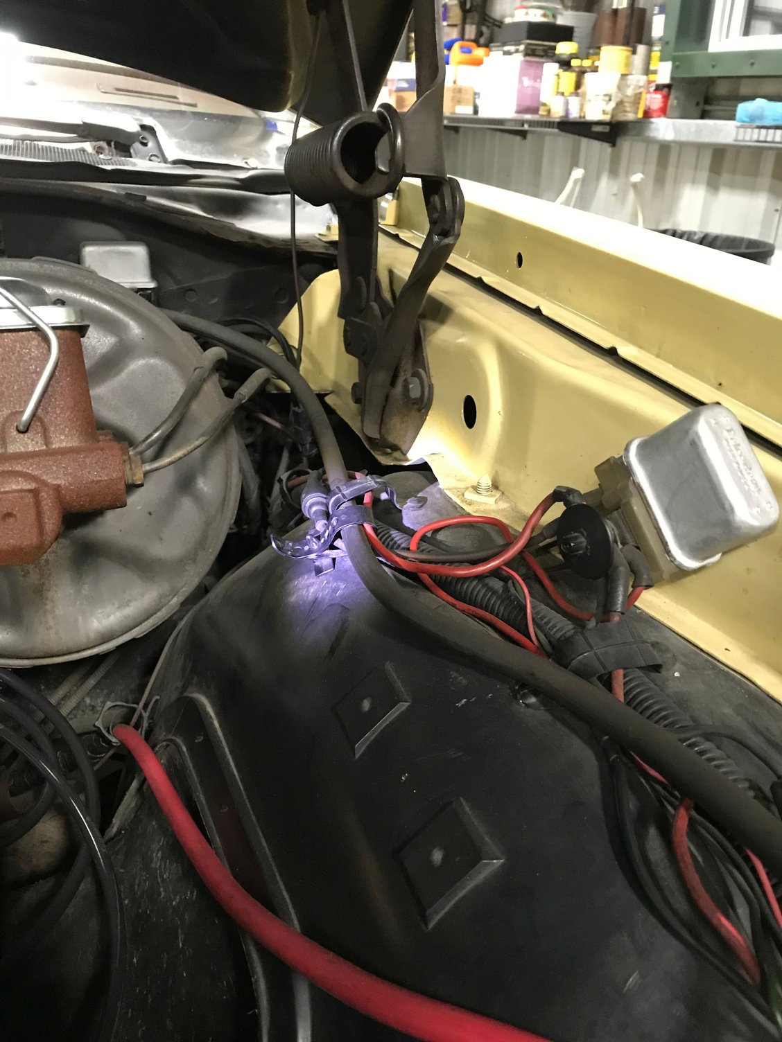

Just a couple images of my '71 horn relay/junction/distribution block (if yours resembles anything like prior years).
thank you. I’ll take a gander when I get home. Really hoping to find the remedy soon.
