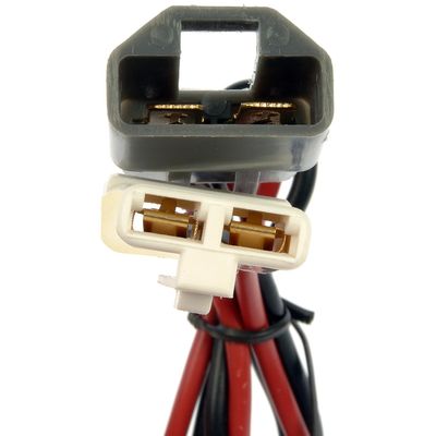

Sorry, but I still don't understand where the spacers go. Use a nut an bolt where the housing isn't threaded. You can buy an extension harness for the terminal clocking problem.
