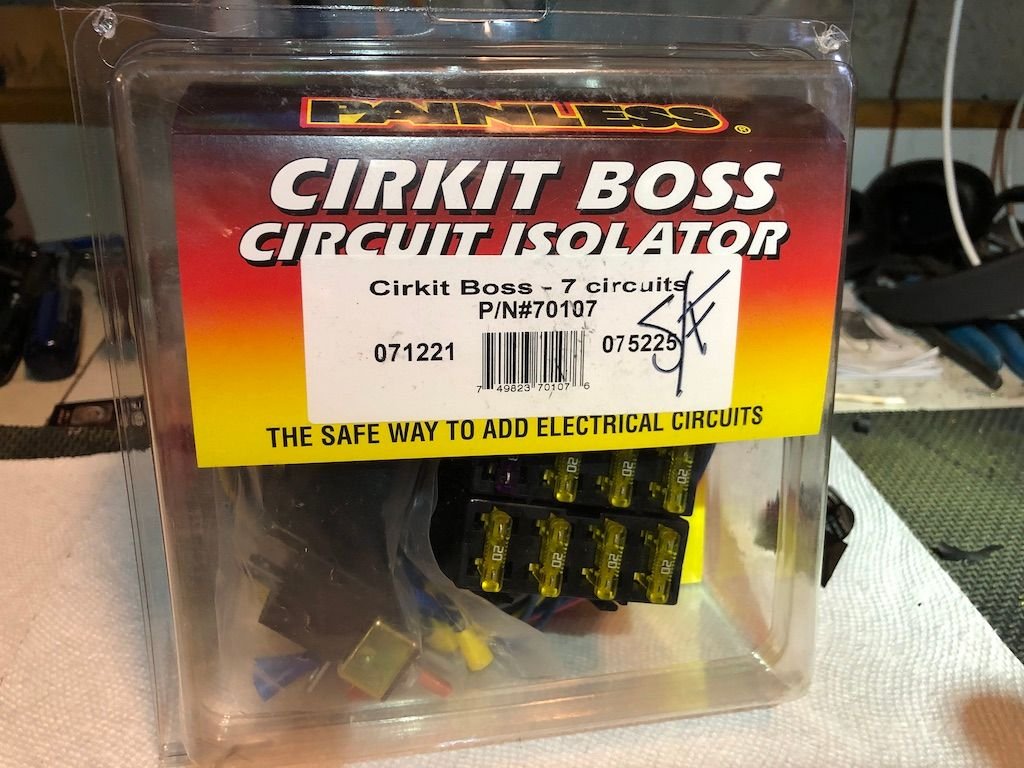

I like my Cirikit Boss from Painless, easy install, has both keyed and always on options. I installed mine behind the kick panel.

Many thanks for the steer on the Painless Kit. Just put the order in for a 4 switched circuit 3 constant part. Painless makes a good variety of these kits from modest to high amperage 7 circuit. I liked the idea of the modern fuses and relay looking different from the factory stuff. It will remind me that I’ve hived off these circuits separate from the factory harness. Colored wires will help too.

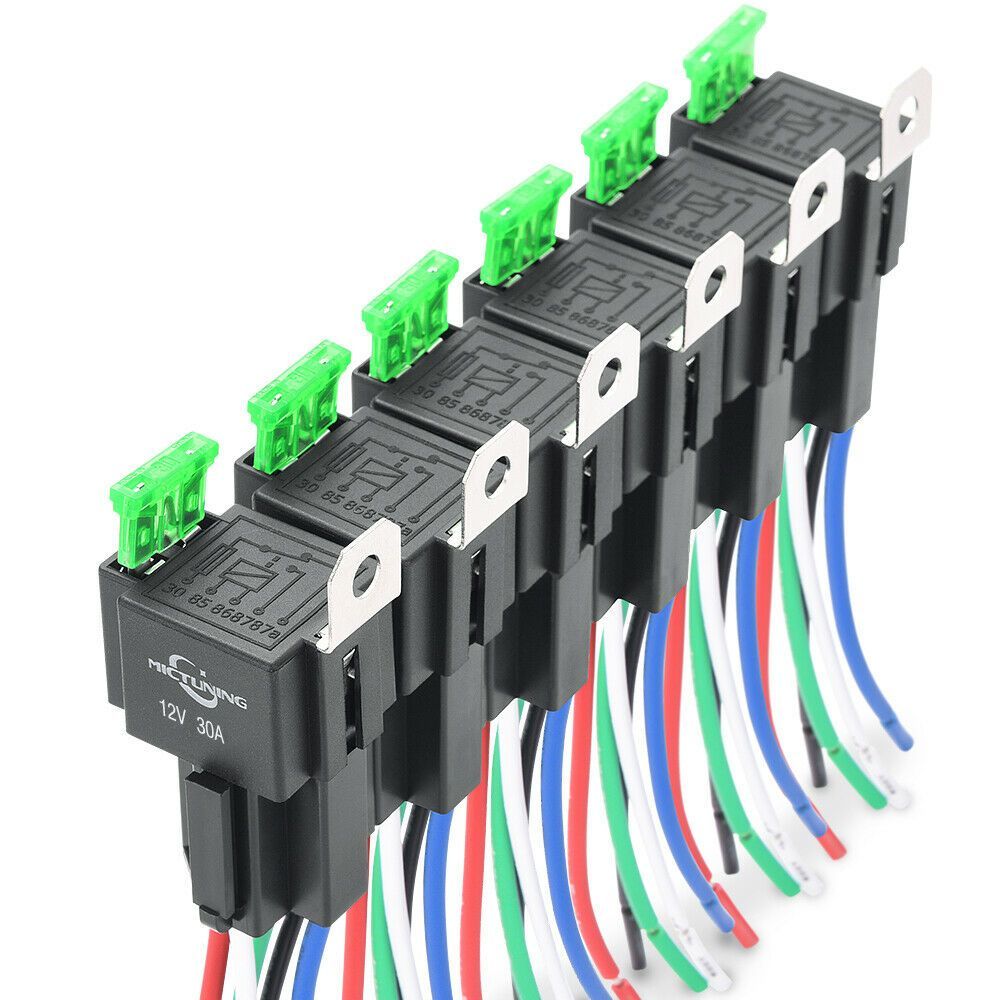

Go to Amazon or ebay and search for "fused relay" and these things pop up. Pick the one that fits your needs, pay, and they come to you. Connect the load lead to the horn relay, battery, or other such heavy duty power source and the trip lead to whatever circuit you want to expand. The power out can then be connected to whatever accessory you wish. Clean and dress the wiring to your own satisfaction and you now have a fused, switched accessory circuit(s). It's as easy as that. The relays can be installed where ever they are needed or grouped in a central location for easy inspection and maintenance.

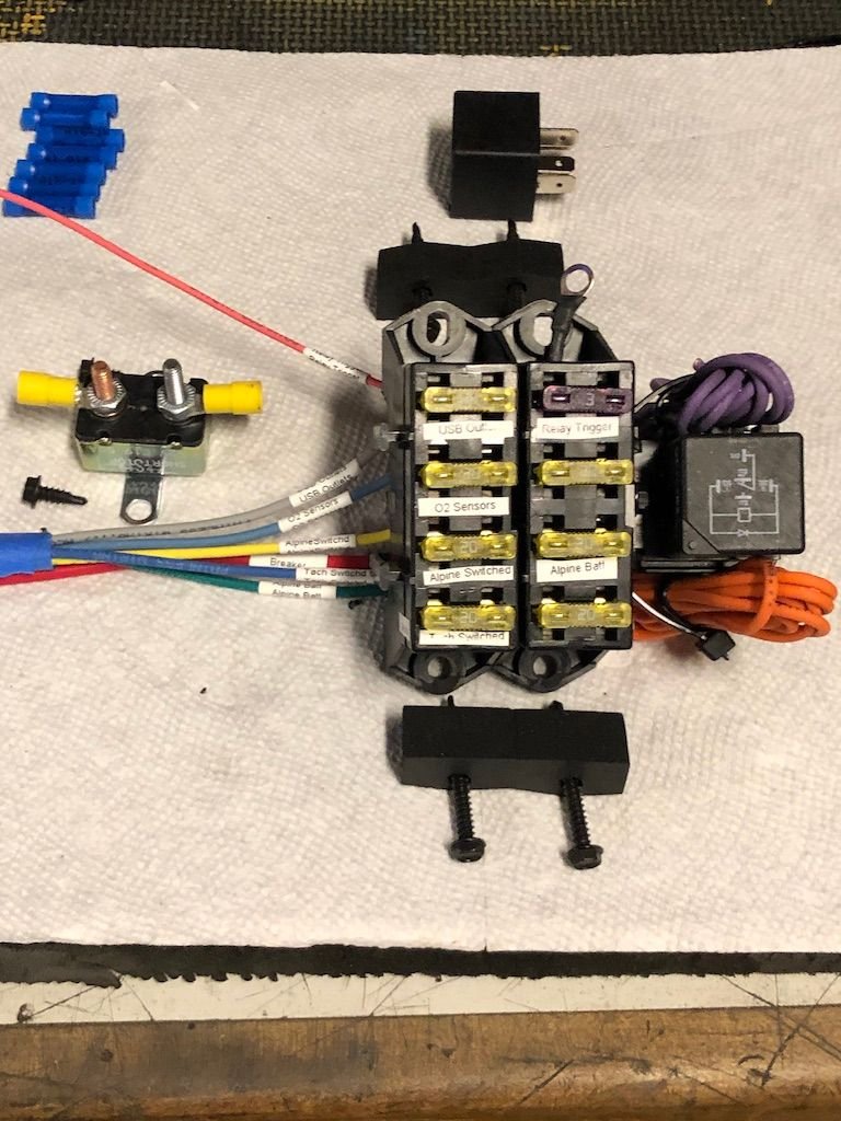

Someone here suggested the Painless Kit 70107. This provides 4 switched circuits, 4 unswitched and a convenient ground on the firewall mount.
Unboxing the Painless Wiring Kit. I'm not affiliated, just a happy customer.
The wires come in a nice neat roll with very disctinct colors for each circuit. That helps us color blind people. The Red main power in wire (goes through circuit breaker to battery) is both heavier gauge and much longer than the output wires. They didn't cheap out.
Having said that I did use a few Packard 56 shells & terminals, plus a few universal electrical connectors and a bunch of 3/16" shrink tubing in several colors. Point is, you'l need just a bit more than the kit here.
I mounted mine with the realy on the right and flipped the fuses. The ground mount is hidden in upper right corner here.
Delivering my daughter to college gave me a chance to make an actual wiring diagram and was kind of a fun airplane/hotel room project in itself. If anybody wants to see that, let me know. Turns out doing the project in my mind helped me discover challenges before doing the install.
A little mounting trick. I use blue tape & a sharpie through the mounting holes to make a sticky template for the circuit breaker & the fuse block. Then you stick the tape to the firewall and drill exactly where you need. Mocking it up first is great for safe & clean placement.
Make your own sticky mounting templates with blue tape & a sharpie.
I've had these cars for long enough that sometimes I curse myself as the previous owner. Over the past few years, I've gotten more careful about labeling changes to the wiring harness with a Dymo Rhino 6000. When things are labeled, it saves me hours of trying to figure out what I did 5 years ago, or maybe did wrong 5 years ago.
Here is the fuse block & wires labeled for easy reference later. Each circuit on the fuse block is labeled so when a fuse blows I know which circuit went wrong. I alse made 2 sets of on-wire labels: one for the fuse block end + one for the connection to each modern component: USB outlets, O2 Sensors, Radio, and Tach. Unused circuits are safely ziptied out of the way for future use. I like the fact that this relay & fuses look different from '66 Olds vintage electricals. Makes it very clear that this is not factory.
Circuit isolater labeled to make maintenance down the road much easier.
So that's the bench stuff. The on-car stuff is actually not that hard, mostly since the systems I'm powering were already in place. At heart, I was just switching power sources to things that were already operating correctly. It was less work than I was expecting. As you can imagine there's a bunch of soldering and crimping. I've gotten in the habit of using the Packard 56 system of terminals & shells like GM did in the 60's. Feels more correct to me than generic universal electrical connectors. See the Auveco catalog if you like the approach.
Here's the final install:
Modern accessories powered by modern relay. Isolated, easier to maintain, and safer than lots of amps through 55 year old wires.
Guessing it took me a day or 2 from start to finish, but I was in no rush on the diagram or labeling which are distinctly optional. Nice weekend project. Comments, suggestions or thoughts most welcome. I haven't driven too many miles yet, but I like the way these are performing so far.
Hope this helps,
