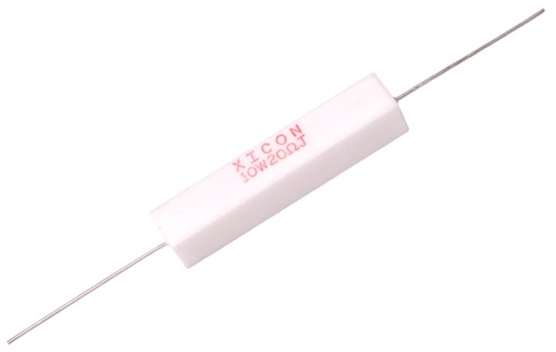

The resistor pictured above will not work. It is a 1/4 watt resistor and in a speaker system you would need at least a 10 watt resistor. You would need one like below. But for the purpose of increasing the dynamic impedance of the circuit, it would only reduce the output of the radio by half. Not a good idea. Like I mentioned above, I have never seen a factory radio quit working because of lower static impedance speakers. Just hook up new speakers and be done with it. Or like Eric says, install a modern stereo system in a stealth fashion and enjoy your cruisin' tunes even more.
