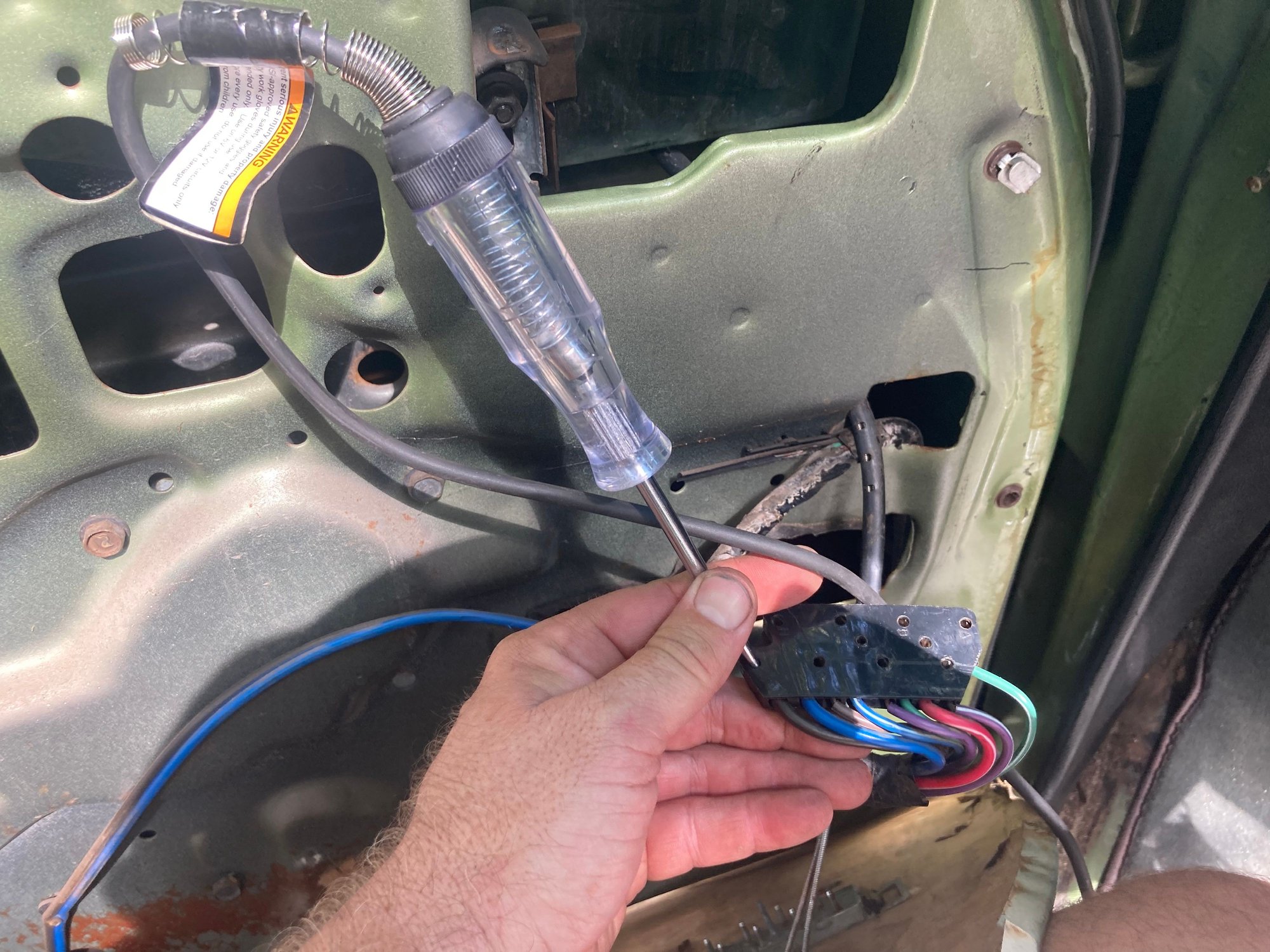

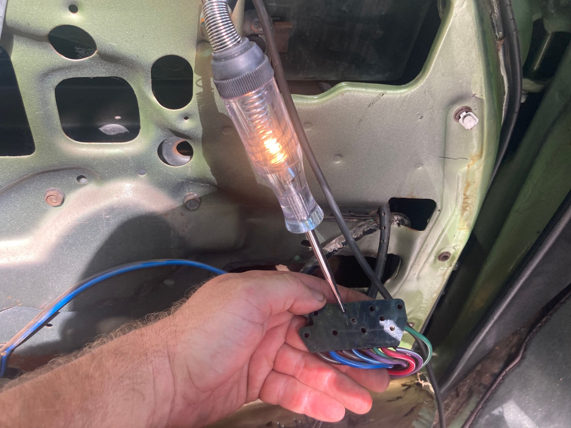

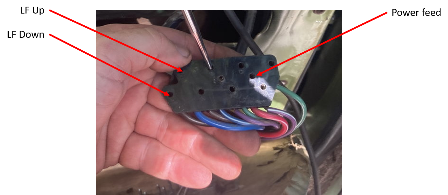

Wow am I needy lately 😩 omw to frankenmuth mi auto fest the driver power window quit working half way down - from the master switch I can still roll all the other windows up and down but not drivers - I removed the door panel and tested the pad that attaches to the switch - I have power to all but the blue and blue with black strip contacts (H and J on the back of the black connector) that is the “bank” that controls my driver window - is there a way I can roll my window up or down til I fix it? And what would be my best step in diagnosing it? Thanks in advance!

You can run wires directly to the motor to power it - just watch for wires (or fingers!) in the path of the window regulator as it moves. On the 1972 cars, the motor has separate UP and DOWN windings with a common ground. The brown wire into the motor powers the DOWN winding, the dark blue wire powers the UP winding. The red wire with the white stripe is the power feed into the master switch and the only one that will have power in that connector so long as it isn't connected to the switch.
