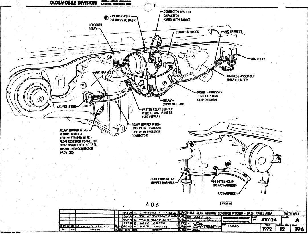

You might review the diagram I posted here, as well - I list the two VR part nos.
Post >>> 4

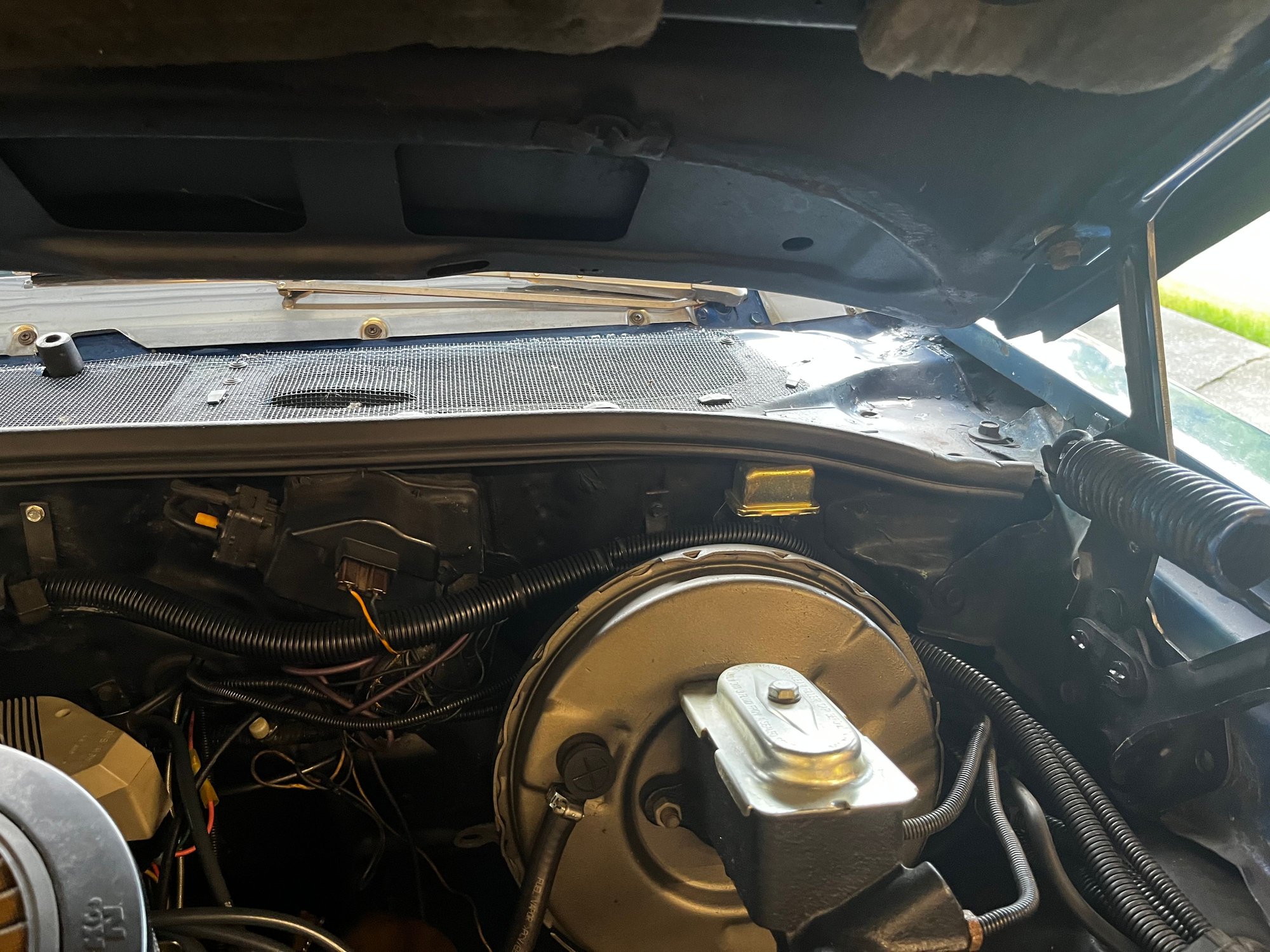

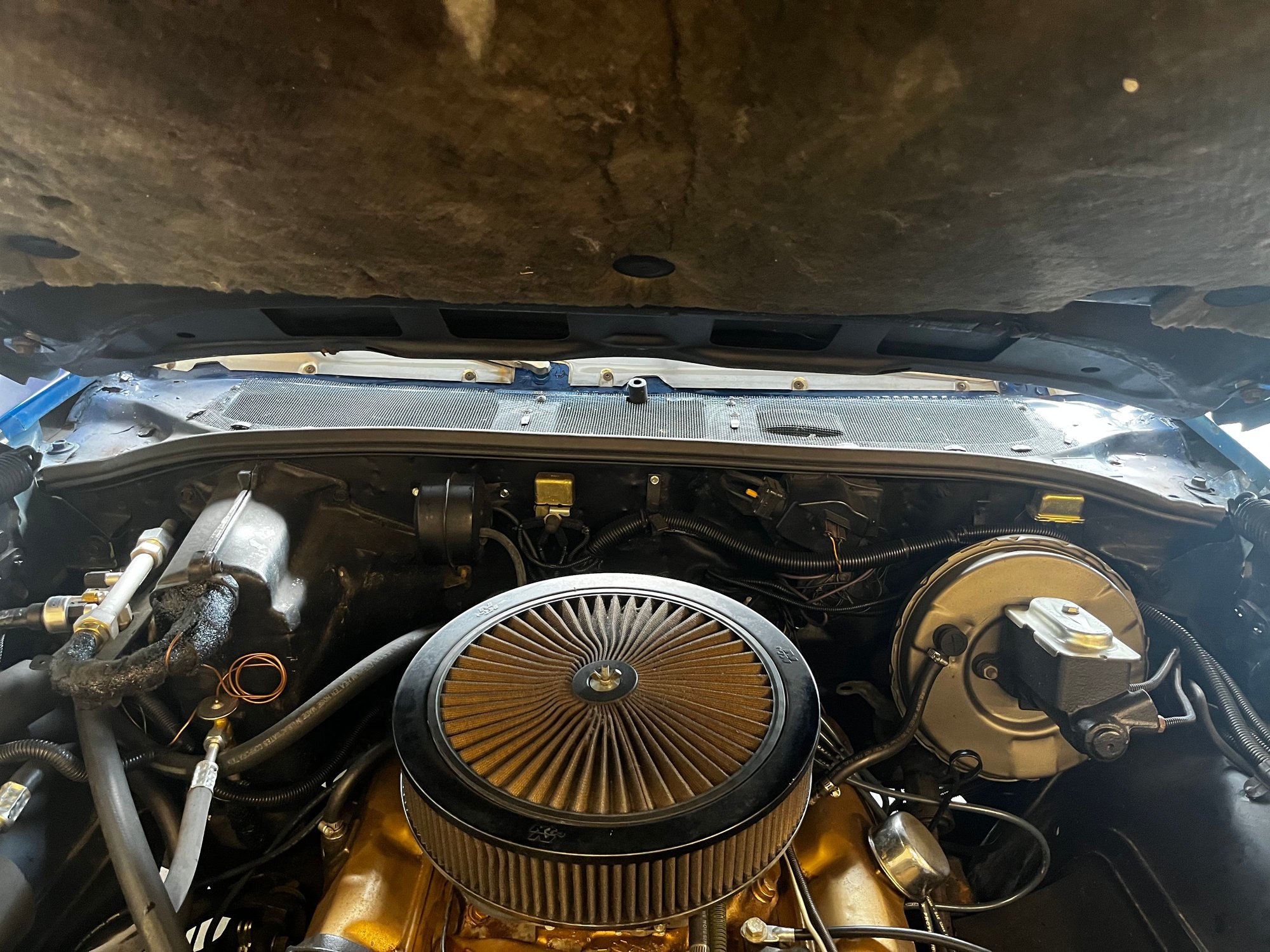

This is what I am seeing under my hood.
and this diagram doesn’t show a voltage regulator anywhere and I can’t seem to find one either. Any help on locating this elusive voltage regulator would be very helpful. I am fairly confident that is my problem but I can’t fix it if I can’t find it. Thanks all

These two gold color guys at the top are the defog relay and AC relay (I think) but no voltage regulator to be found.

Ah right. So, I "think" you probably have an internal regulated ALT - VR contained in the ALT. The reason I mention this is because you said you have a 403 engine (not available in 1972) - the 403 was 1977-1979. With that said, it's likely, not necessarily true, but most likely the case you have an internally regulated ALT. What I'm trying to say is there's a "chance" an external VR could be located elsewhere (since your engine is a transplant) and won't follow the normal 1972 OEM standard locations. Most likely guess is the ALT has an internal VR. A picture of the alternator would help. Since we don't know how the engine was wired, you'll have to do some digging.

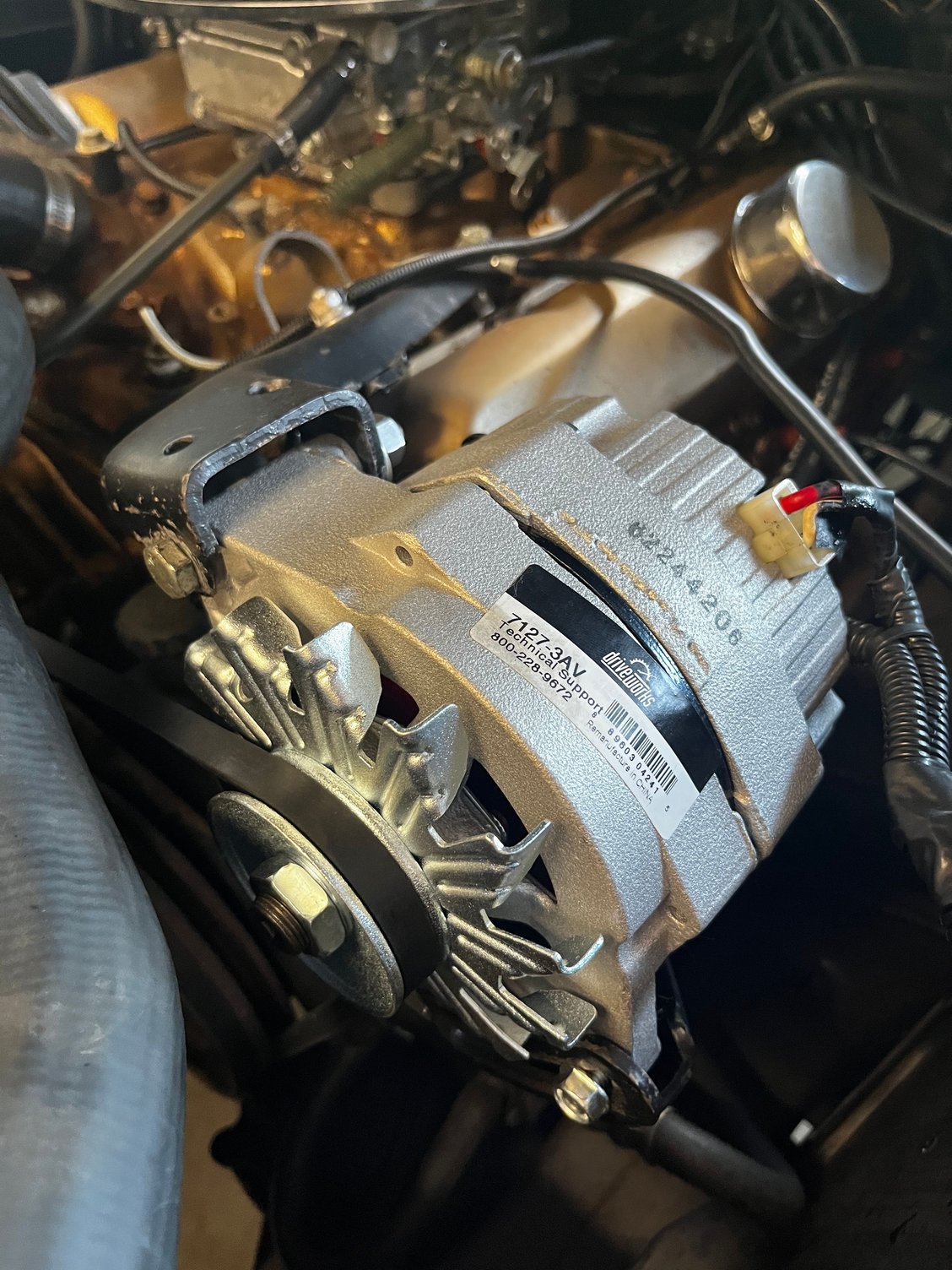

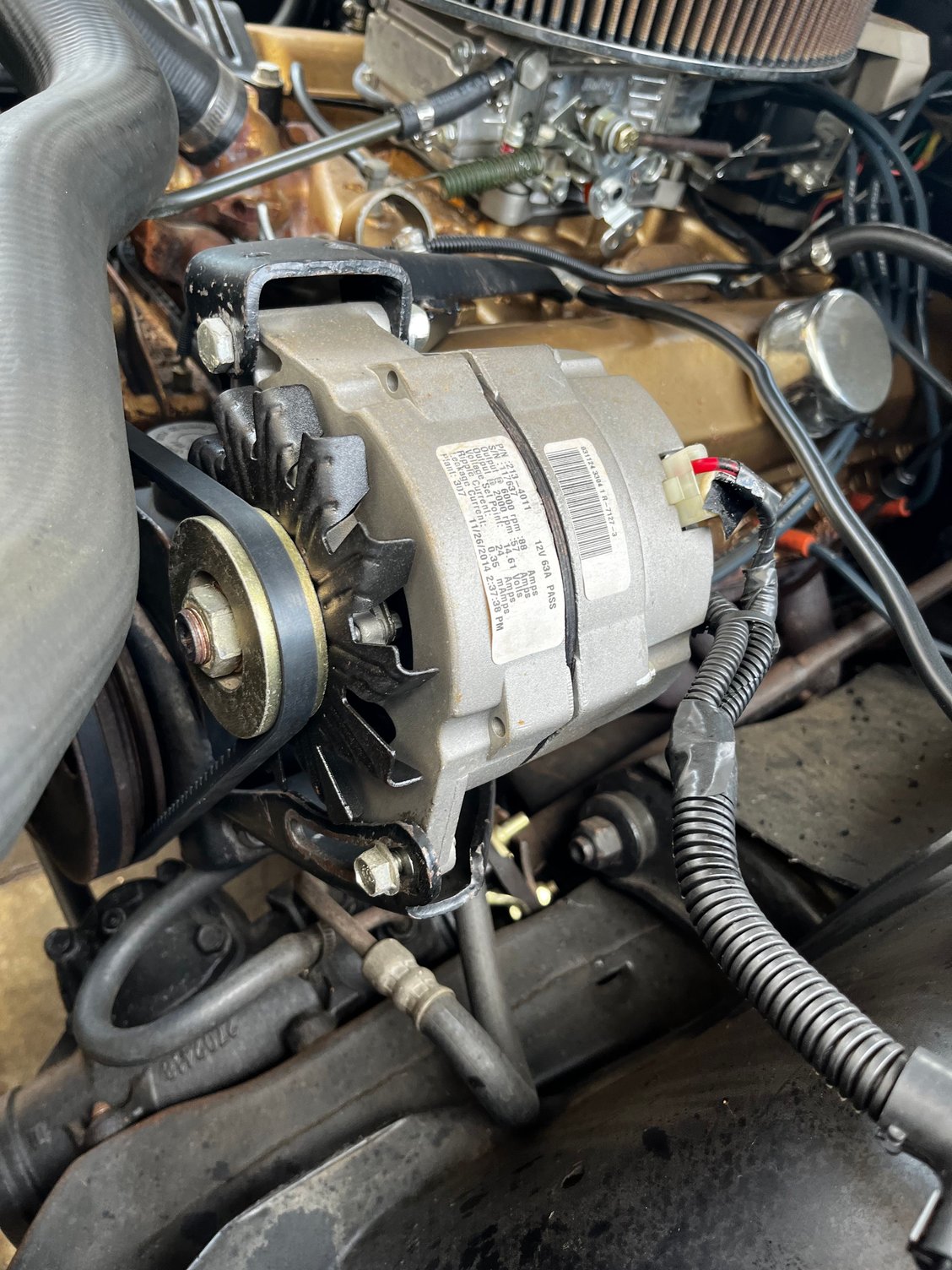

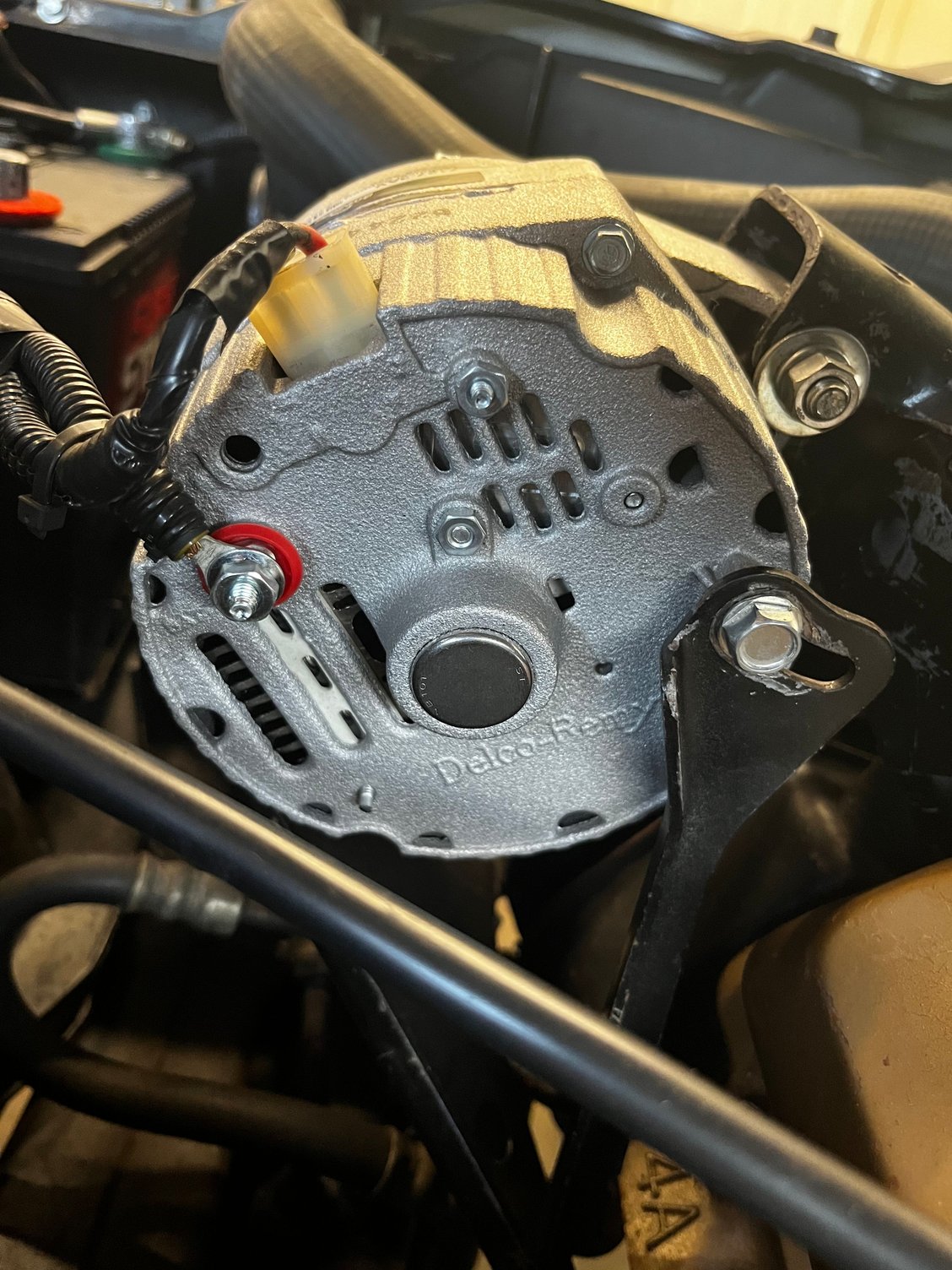

Ok, I think we are making a little progress. This is the alternator I replaced the old one with last night. It has an internal VR
https://shop.advanceautoparts.com/p/...-3av/5030250-P
I am going to contact the previous owner and see if he can direct me on how he wired it when he put in the engine.

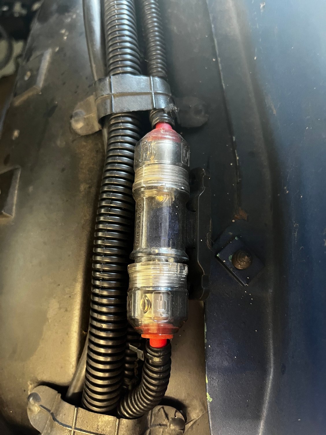

Please forgive my ignorance. What is this?
could this be an in line regulator?
That's OK. I don't know what it is. It looks like a more or less standard type in-line fuse (of some type) - has red ends (both ends) indicating a positive power cable, aside from that I don't know. Can you trace the wire this device is inserted into? It has to have a beginning and and end point. Looks more like an in-line fuse I've seen on a marine application, but all this is not bad. You're going to struggle a tad trying to identify the wiring since you now know what you're up against. Good time to get a notebook and start making some drawings with notes on wiring.

It is part of the wiring harness for the amp (stereo) in the trunk.

I'll just point out one thing I noticed from your statement. You said you replaced the old one (alternator) with this new one. Are you CERTAIN the old one (ALT) was internal VR or was it external VR? That in itself is going to be significant in terms of wiring. You have a picture of the old alternator?

Then it's nothing more than an in-line fuse (most likely) for the amp electrical. Doubt it's an in-line breaker, most likely just an in-line fuse (of some amperage rating).
EDIT: I'll point out in case in the future you have an issue with the stereo amp, that type in-line fuse should be able to be opened by unscrewing it from one or both ends. Inside you should find a circuit protecting fuse (of some amperage). You won't hurt anything if you want to open it up and review it yourself. But knowing what it is will help in case you do have an issue with amp electrical in the future. If the fuse ever blows you'll know where it (at least this one) resides.

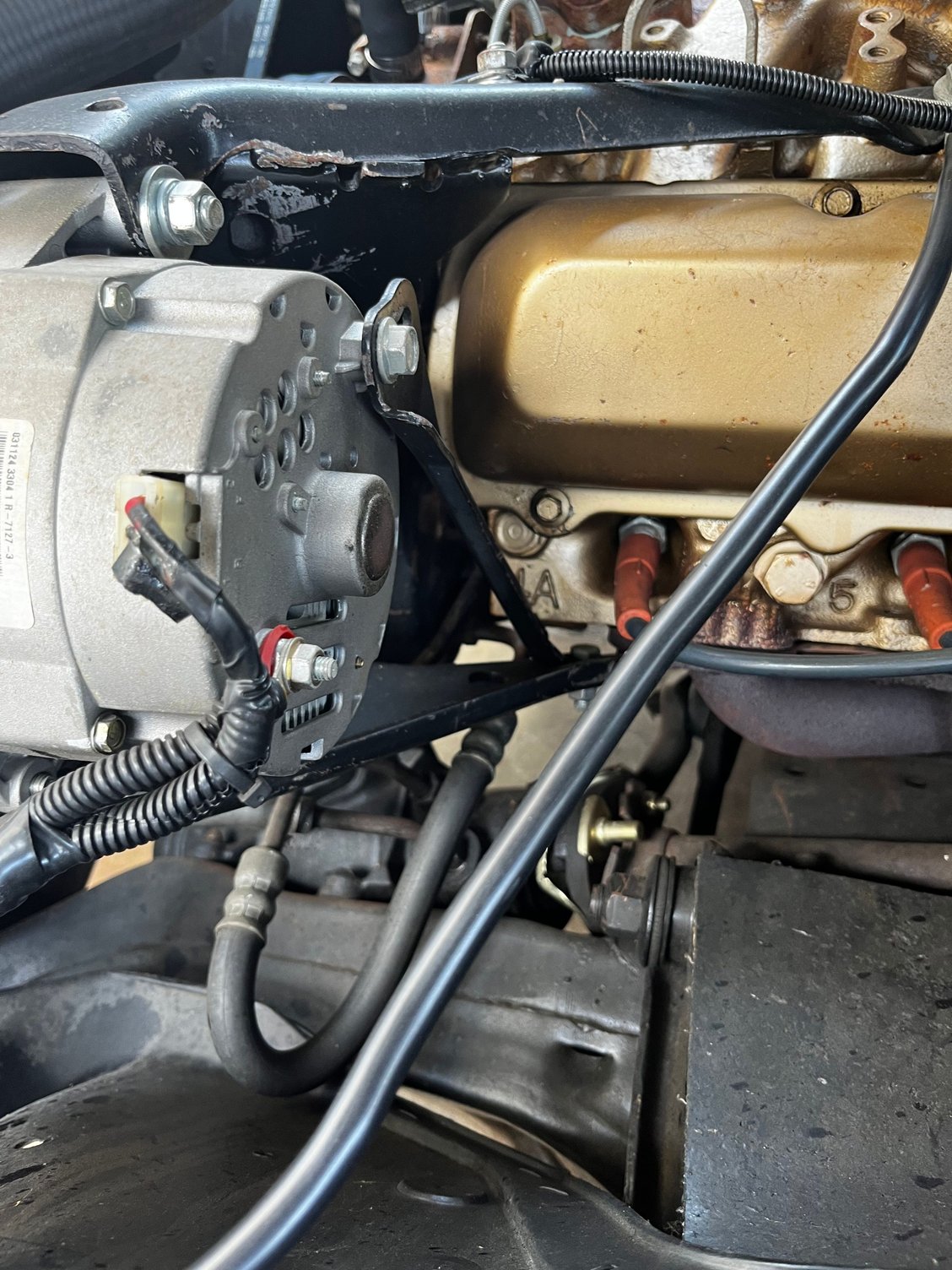

old alternator
sorry, uploaded wrong pictures at first.

Googled one of the part numbers. Pretty sure this is the old alternator.

Yes, I found both alternators - they're both internal VR. Therefore, the ALT is wired with no external VR. Again, this resides outside of my wheelhouse regarding knowledge on how that ALT is wired on a 403 sitting in a '72 A-Body. The PO or others on this site will be able to provide more additional assistance to you. Good Luck! Do start writing down some wiring schematics in a note book for future reference.

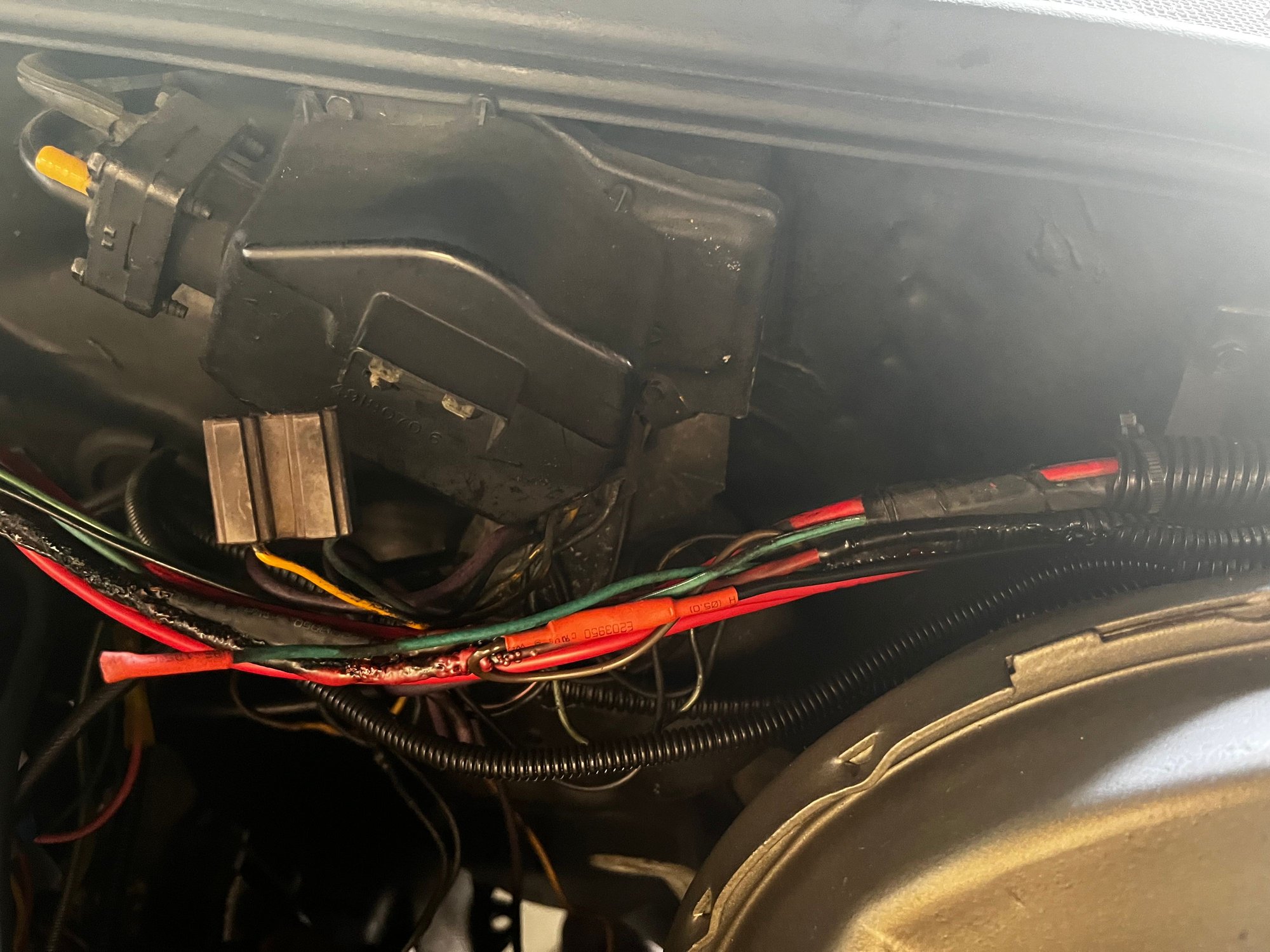

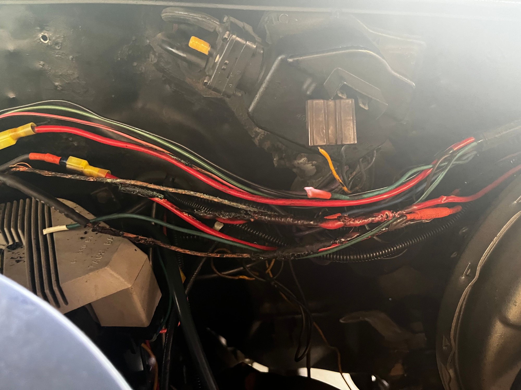

Alright y’all, I figured it out. I drove it from NC to GA and during that drive the alternator went bad (in particular the internal voltage regulator). It was sending 16+ V to the battery which during the 4 hour drive got overcharged and boiled. There was a 12ga wire run to the positive on the battery which ran over the the power distribution post on the fire well. That wire got too hot and melted causing a couple other wires to melt and short together.
I replaced the alternator and fixed the burned wires and all has been well the past three days. I’m watching the wires and voltage but everything has been good to go.
