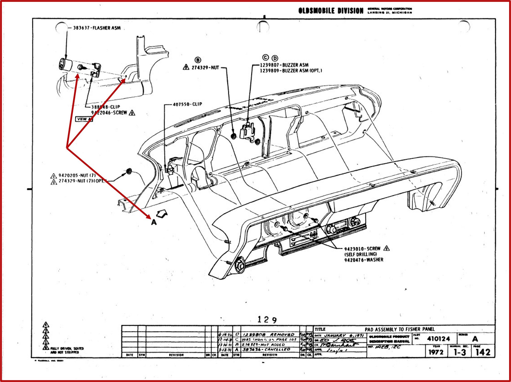

Old Aug 11, 2022 | 01:29 PM
Posts: 25,963

Posts: 9
Thanks to both of you for the info. I found and replaced it.
