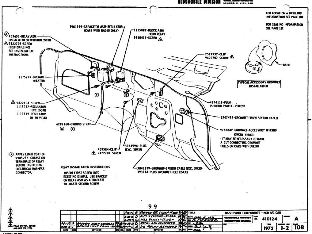

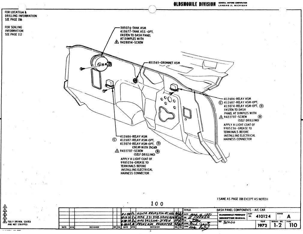

Hello! Good morning. I am trying to figure out which relays are mounted to the firewall and where they are mounted on the firewall. Do any of you have a car that you can take a picture of and send it to me? Or have a diagram of some sort? Thank you!

The voltage regulator is the square black box nearly dead center on the firewall.
The horn relay is just to the driver's side of the regulator.
The A/C relay is outboard of the wiper motor on the far driver's side.

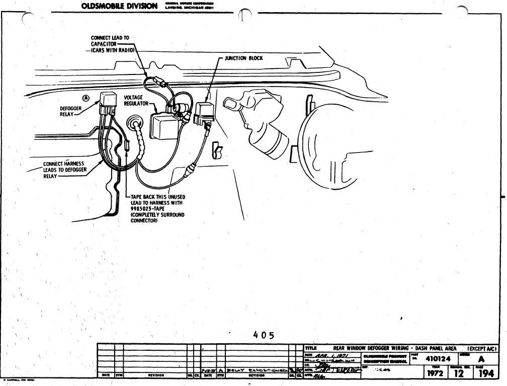

If you have the electric grid rear window defogger that relay will be below the regulator.

OK. I won't bang my head against the wall doing a comparison of that Power Top circuit breaker location vs. the A/C relay between years, but I will toss up the diagrams for non-A/C vs. A/C firewall diagrams to accommodate what Joe has already stated.

Here's the rear window defogger relay diagram, FWIW.

The rear window defogger relay is the only one that changes position with A/C vs non-A/C, and since the OP said that he has A/C, I only provided that info. And yes, there were differences between 1971 and 72.
