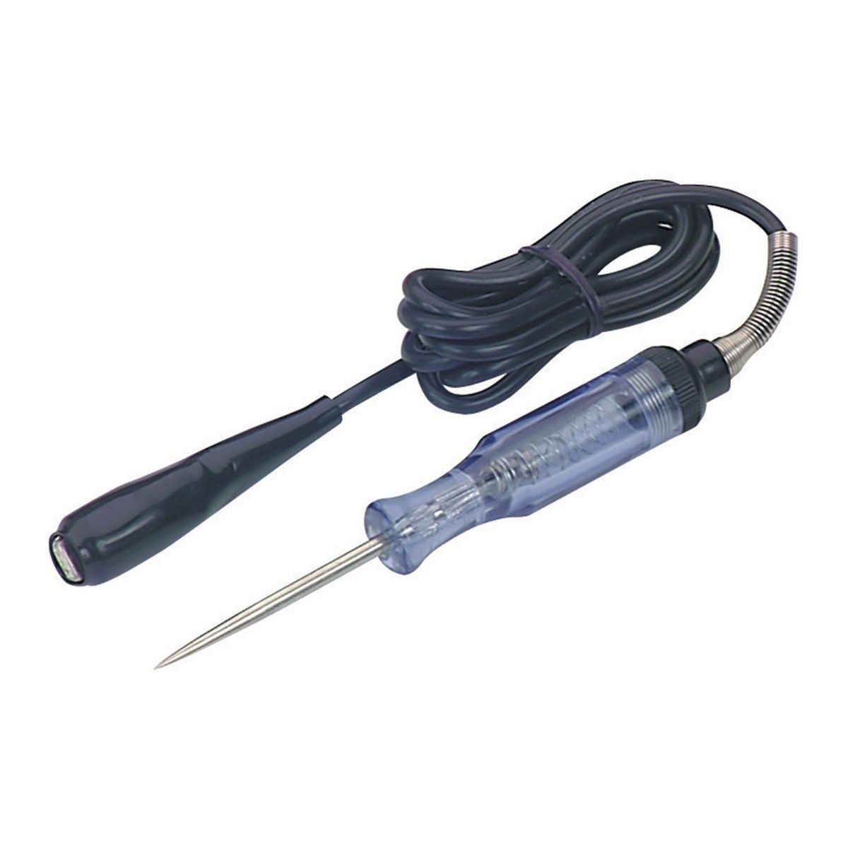

The start circuit runs from the battery to the ignition switch to the NSS to the starter. There aren't a lot of places to check. Get a test light or voltmeter and figure out where the power stops.
The simplest method to troubleshoot this issue is a test light, IMO.

As suggested get a test light, look at the ones with a voltmeter built-in. OTC is around $30. On a car of this vintage it will be a very useful tool.
Also look for a wiring diagram for your car. The advantages to testing vs throwing parts are that you gain an understanding of the car, it saves time and the car keeps more of its original high quality parts.

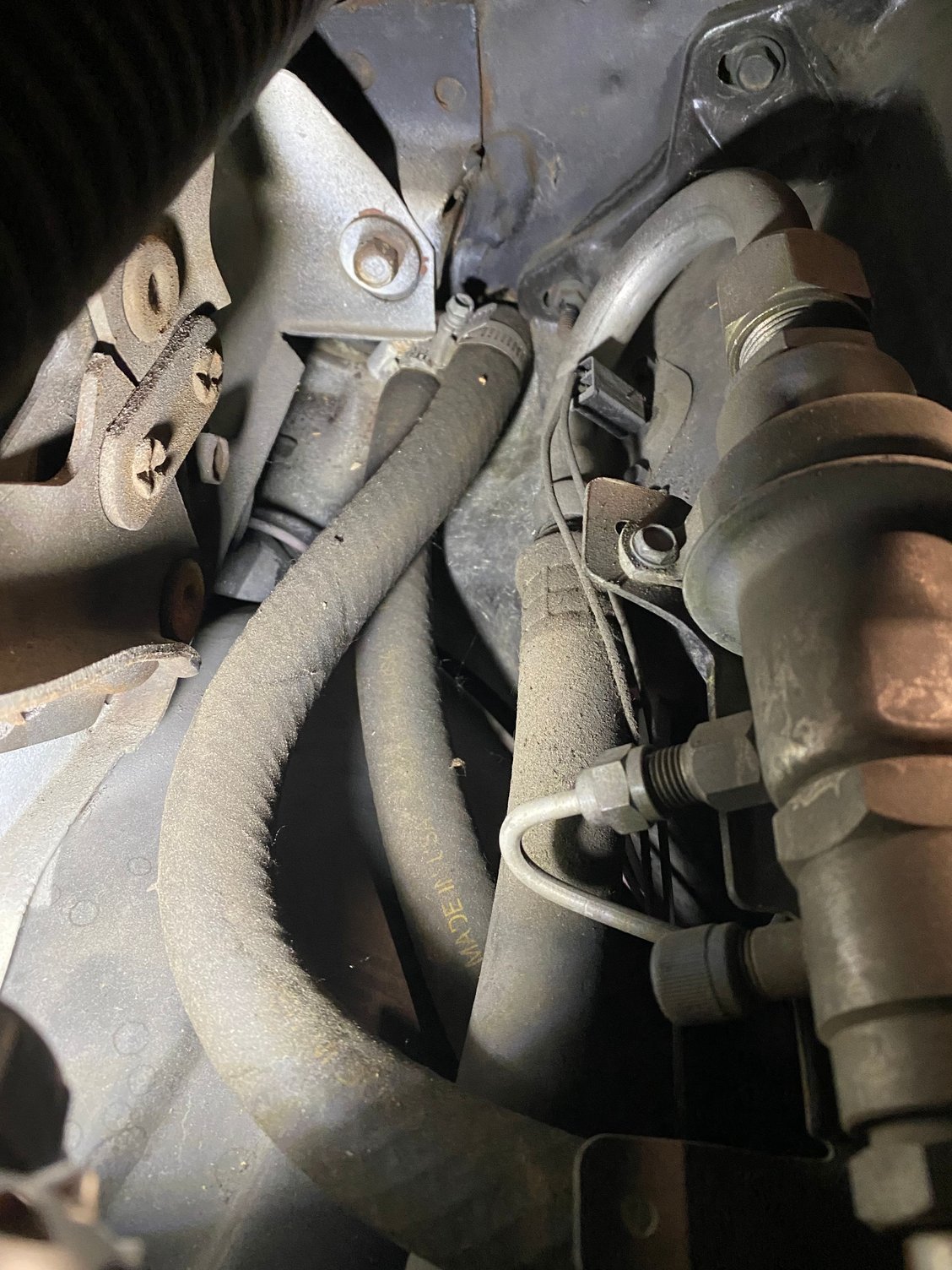

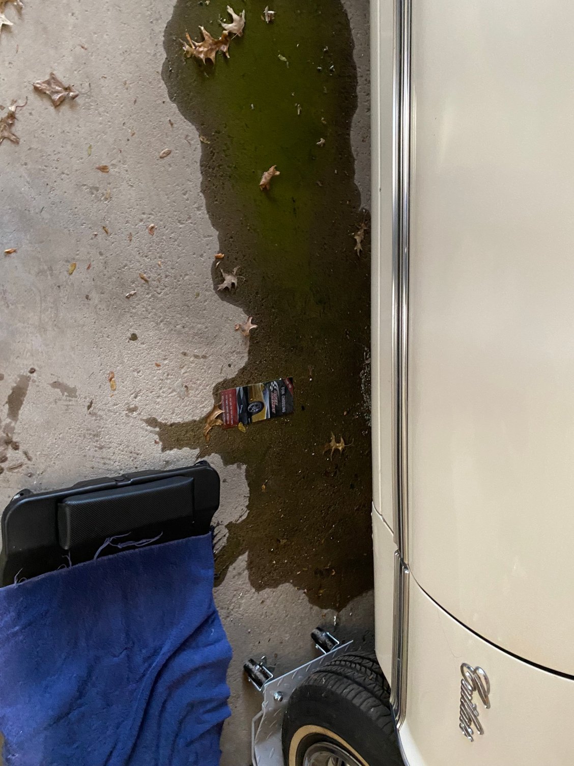

Here are a few pictures that I said I would post. I finally was able to get the car started after 10 years. After the neutral safety switch fix I found that my fuel pump was bad. After replacing the fuel pump it started right up. Now I have an issue with white smoke coming out of the exhaust. After turning the car off I noticed antifreeze leaking from the bottom of the heater core housing. Any advice on next steps?

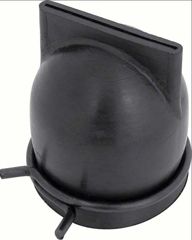

The AC Evaporator Core on my 1971 CS 350 was bad when I purchased the car three years ago. Antifreeze leaking from "under" the car via the drain hole (which has a rubber grommet). The AC was also faulty - would not hold a charge and no cold air. I replaced my Evaporator Core which resolved the issue. Generally speaking I believe if the heater core is faulty, you'll have fluid leaking onto the passenger floorboard. Take a good look up from underneath the car and see if the fluid is leaking from that rubber grommet - sometimes the rubber grommet is lost and you can only see the hole itself, but in any case if it's the Evaporator Core you'll see antifreeze leaking from that hole. Are you having any issues with either the AC or the heater?

The antifreeze leak fix will most likely be a hose or the heater core. I would not worry about the white smoke until you've driven it for a little while.

This is what the Evaporator Core box drain grommet looks like...

Yes the antifreeze is leaking from the plug in the bottom. The A/C stopped working right before the last time I drove it around 10 years ago.

That antifreeze puddle on the floor is not a little a/c oil leak.

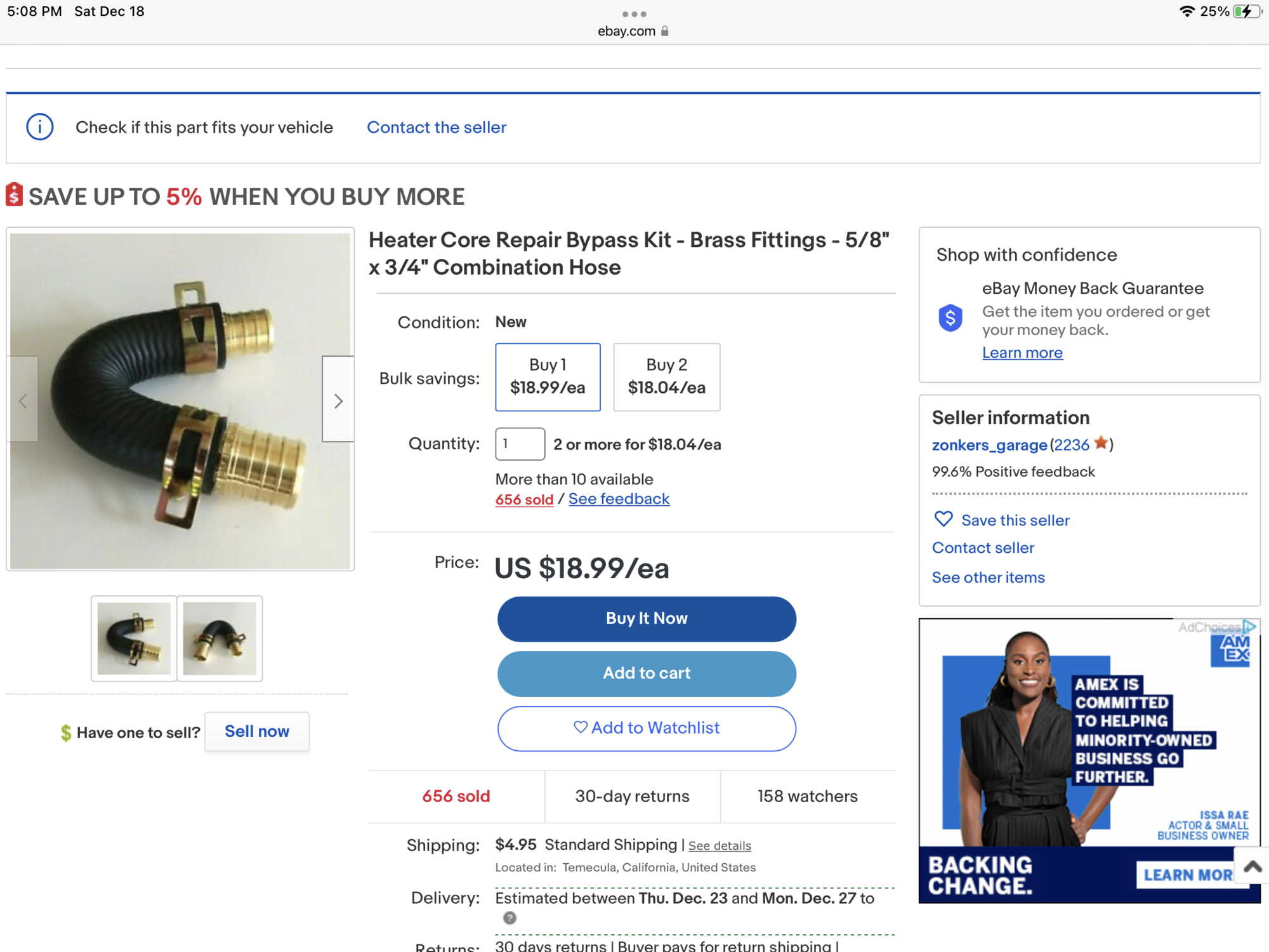

It seems that I either have leaky heater core hoses or a leaky heater core. I have never taken the housing off before. Is it relatively easy to take it off and check for hose leaks? If it’s a bad heater core has anyone ever temporarily bypassed the heater core with an elbow connecting the input to the output so the car can still be driven without heat until the heater core replacement can be done?

I found a bypass hose on EBay. Am I correct in thinking that I can temporarily bypass the heater core by attaching this bypass to the two hoses entering my firewall?

I had antifreeze leaking from the evaporator core/heater box - located inside the engine compartment - that big box which enclosed both the heater core and evaporator core. The antifreeze was leaking from the bottom of the evaporator core/heater box. But, I also had a faulty AC evaporator core. I had antifreeze leaking from the drain plug of the evaporator/heater enclosure box in the engine compartment mounted against the firewall. There was no antifreeze leaking onto the inside of the car anywhere. I pulled the evaporator/heater core enclosure box and antifreeze was leaking into the evaporator/heater core enclosure box and the antifreeze was flowing to the bottom of the evaporator/heater core enclosure box. As stated, I was having issues with the AC not holding a charge and not producing cold air. There was however an issue with the AC evaporator core, which was the issue with the AC system (although, I did replace the AC compressor at the same time since I had just bought the car and since I was replacing the evaporator core I thought I'd replace the AC compressor, as well). Then, I noticed an issue with the heater core valve AFTER I replaced the AC evaporator core. After I replaced the AC evaporator core and put the system back together it was then I noticed an issue with the heater valve - the AC system was now working flawlessly. You're correct, the AC evaporator core only contains freon coolant. So, then to be honest, when I noticed an issue with the heater valve - I sought to correct the heater valve issue and I did this in the following day or two. I never really waited to detect any additional issue with the heater or AC system other than that heater valve wasn't working correctly. If I could only recall exactly how I came to find out that heater valve wasn't working correctly I might better provide some clue as to why antifreeze was leaking out the bottom of that evaporator/heater core box but I can't recall. Without any question of doubt however, it was antifreeze leaking. I never replaced the actual heater core itself - only the evaporator core and the heater valve. I can't recall replacing a hose from the heater valve.

Yeah, you're correct Eric. And, it sure looks like the type of leak I had on my car after I bought it. When I got it on jack stands and had a good look, the antifreeze was coming out of that rubber drain plug. Since my AC was bad, I simply initially assumed it was a bad evaporator core. So, replaced the evaporator core but I also replaced the AC dryer and the AC compressor since the car was new to me and I was all about addressing the AC system. Add to the fact I don't own AC charging equipment, etc. Then, after it was bundled all back up, I noticed the heater valve wasn't working correctly, so I replaced the heater valve. I really can't recall and I don't believe I replaced any hoses for the heater core itself though just the heater valve.

Assuming those are the correct hose sizes you can use that bypass. You can also just bypass heater core by running the smaller hose from the water pump to the back of the intake manifold and making the smaller diameter hose fit on the larger fitting. Accomplishes the sane thing, then when your ready replace the heater core ( if you passenger floor is wet too)
