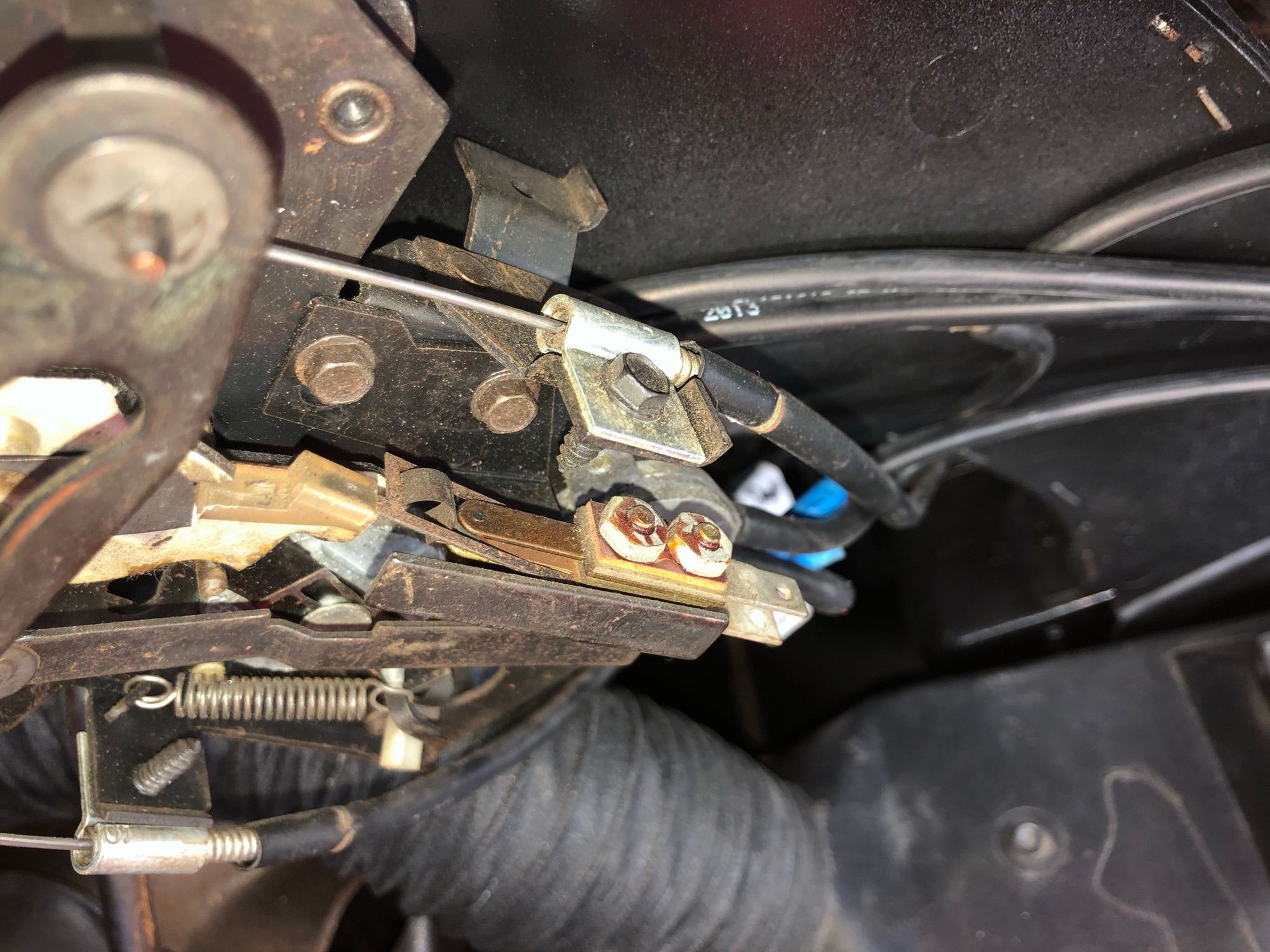

Picture of connector bottom right/passenger side of ventilation A/C controller
Picture of connector top left/drivers side of same controller
Since these are both two stab connectors, does anyone know the wiring colors that go to that specific spot?
Does any one have a wiring diagram?
Thanks Brian
Old Jul 8, 2021 | 07:05 AM
Posts: 50,802
The switch on the bottom right is the compressor clutch switch. It gets the connector with brown and green wires. The other switch on top is the master switch and it gets the connector with the brown and tan wires.

All the wires are hooked up
Got the wiring hooked up, now the rest of the dash to go, thanks all.
