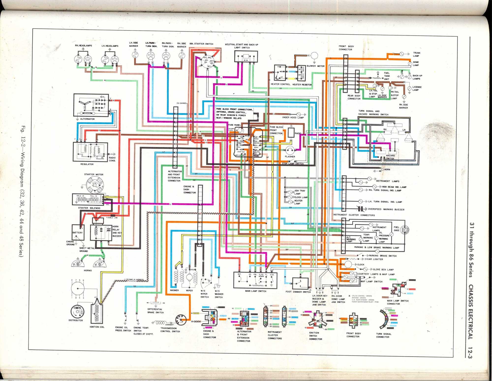

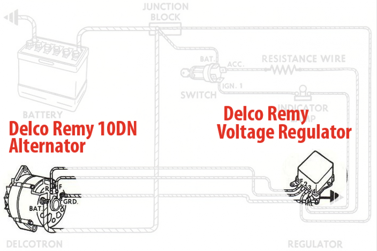

Assuming you have a 10DN (55amp) alternator (many folks convert alternators) and you have the correct external VR:
(1) Double check your ground wiring - nice & clean from (-) battery post to engine block & engine to firewall. Remove hardware (screws, straps, etc.) brush w/ sandpaper or otherwise to ensure good ground(s). VR gets its ground from the firewall.
(2) Double check your wiring is correct - blue and white wires are correctly oriented per the wiring diagram & ensure wiring is same as wiring diagram (color wiring diagram is in the 1968 CSM).
(3) What was the reason for installing a new ALT & VR? Because the dash GEN light came on? Which did you replace first (if this is the reasoning) ALT or VR?
(4) VR's are well known to be either the incorrect or simply bad new ones - it happens more often than you can think of.
Here's the 1968 wiring diagram - double-check your wiring. If you have the part number of the alternator and the VR that would help to identify any possible mismatches. If you have a picture of the alternator case and the wiring plug harness leading into the alternator that would assist since many folks here have seen it all - alternators rebuilt incorrectly, wrong wiring, incorrect case, etc., etc.
10DN Alternator
1968 Wiring Diagram

Unplug the regulator, leave it unplugged, jumper the F terminal to the 3 terminal on the regulator plug. Start the car and check the voltage.
If 14V or more bad regulator,
If no increase in voltage, bad alternator or a wiring problem to the alternator, see the wiring diagram Norm supplied.

As per what Sugar Bear suggested to (test) jumper F terminal to 3 terminal on the VR plug, here are the terminal numbers F,2,3,4.
