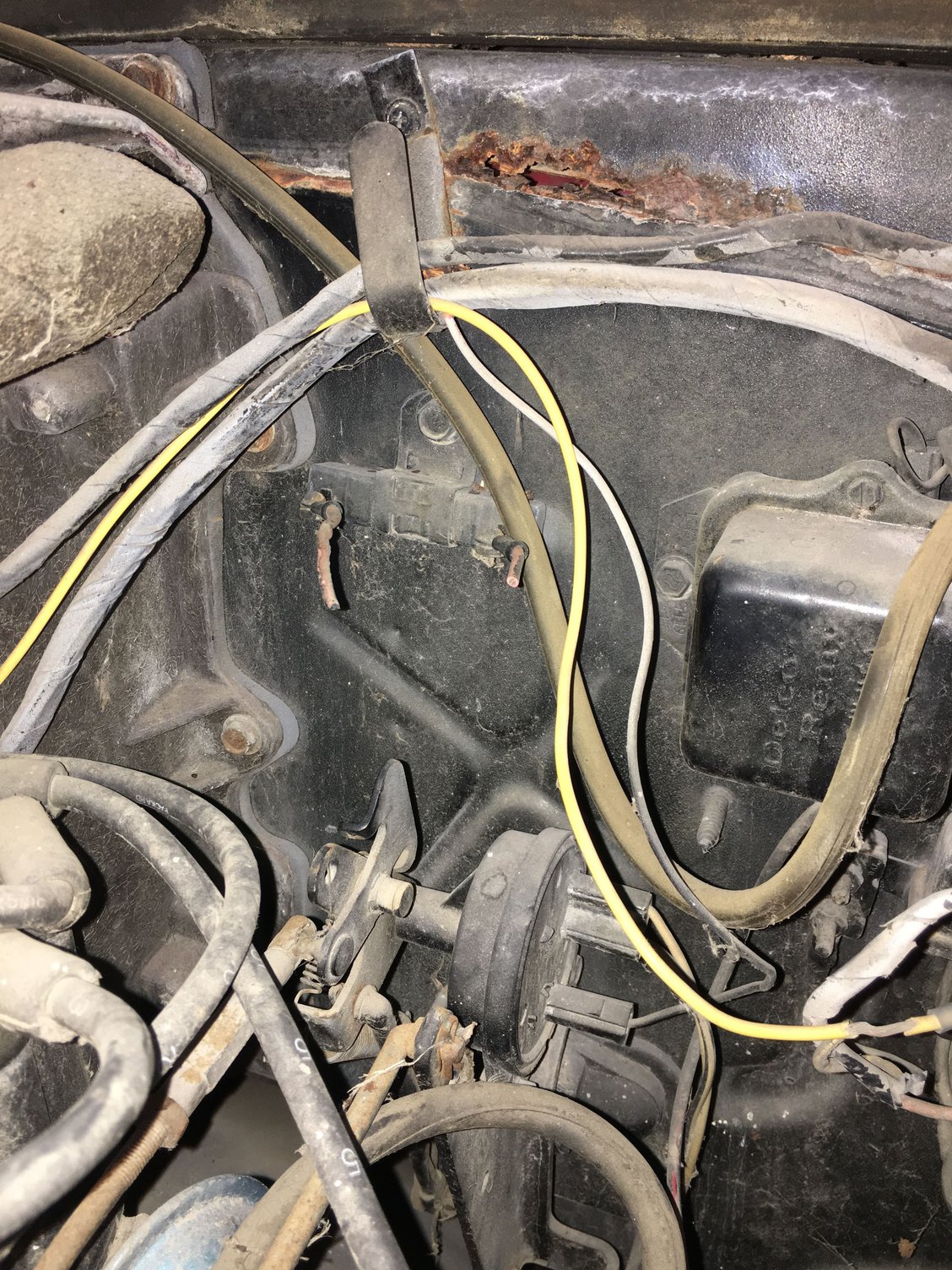

1967 Delta 88 - what’s this disconnected thing on the firewall?
Old Nov 30, 2017 | 09:21 AM
Dolores's Avatar
Joined: Nov 2017
Posts: 30
In the Center of the picture, a squared off (fusible link?) that has both wires disconnected.
Thanks!
Old Nov 30, 2017 | 09:23 AM
classicmuscle442's Avatar
Joined: Sep 2012
Posts: 1,413
From: Water Wonderland MI.
It's voltage reducer for the points.
Old Nov 30, 2017 | 09:25 AM
Its an ignition ballast resistor for a points distributor.
Old Nov 30, 2017 | 09:27 AM
TripDeuces's Avatar
Joined: Jun 2010
Posts: 3,613
From: Rogues Island, USA
It's a ballast resistor. I know in 67 the resistor wire was used by GM. Has it been removed or did it change from model to model?
More to the point, it isn't factory. Someone added it. Olds used a resistor wire in the harness, not an external resistor, for point distributors.
Old Nov 30, 2017 | 09:30 AM
Dolores's Avatar
Joined: Nov 2017
Posts: 30
Thanks all. I’m pretty sure this has a non-points dizzy, one of many things I need to research (I assume setting the timing will be different). Subject of another thread for sure.
Old Nov 30, 2017 | 09:37 AM
The coil (and thus timing) neither knows nor cares if the spark is triggered electronically or with points. Initial timing depends on CR, cam, gasoline quality, and the current mechanical and vacuum advance curves. It does not depend on points or electronic triggering.
Old Nov 30, 2017 | 09:43 AM
Dolores's Avatar
Joined: Nov 2017
Posts: 30
good points (pun intended!). I have no idea at this point what kind of advance provisions are in the distributor so I was guessing (maybe wrongly) that setting initial timing may have a different procedure.
