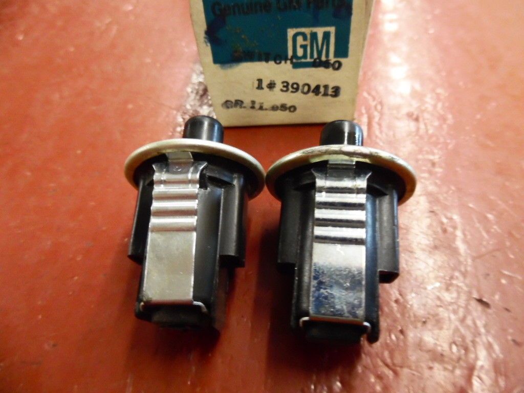

This is what the original switch looks like. The fins/wings go all the way under the switch. Oldsobsolete has one, but they're trying to get $95 a pop. Kinda seems ridiculous for such a simple switch.

Okay, I figured it out. The replacement switch I bought, despite looks, was not self-grounding. I ran a wire from the grounded side (thanks oldcutlass) to the body and voila! it works now.
