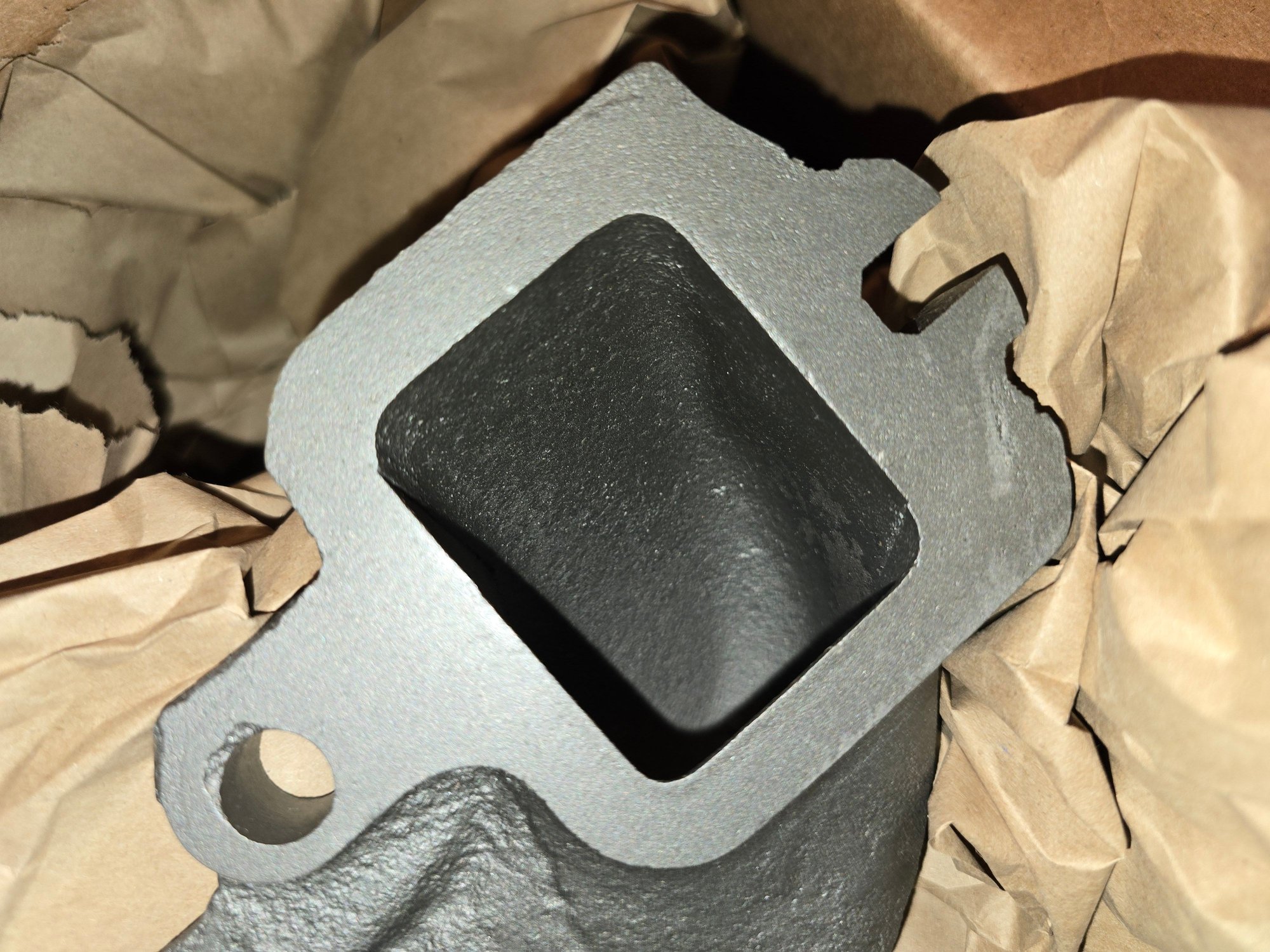

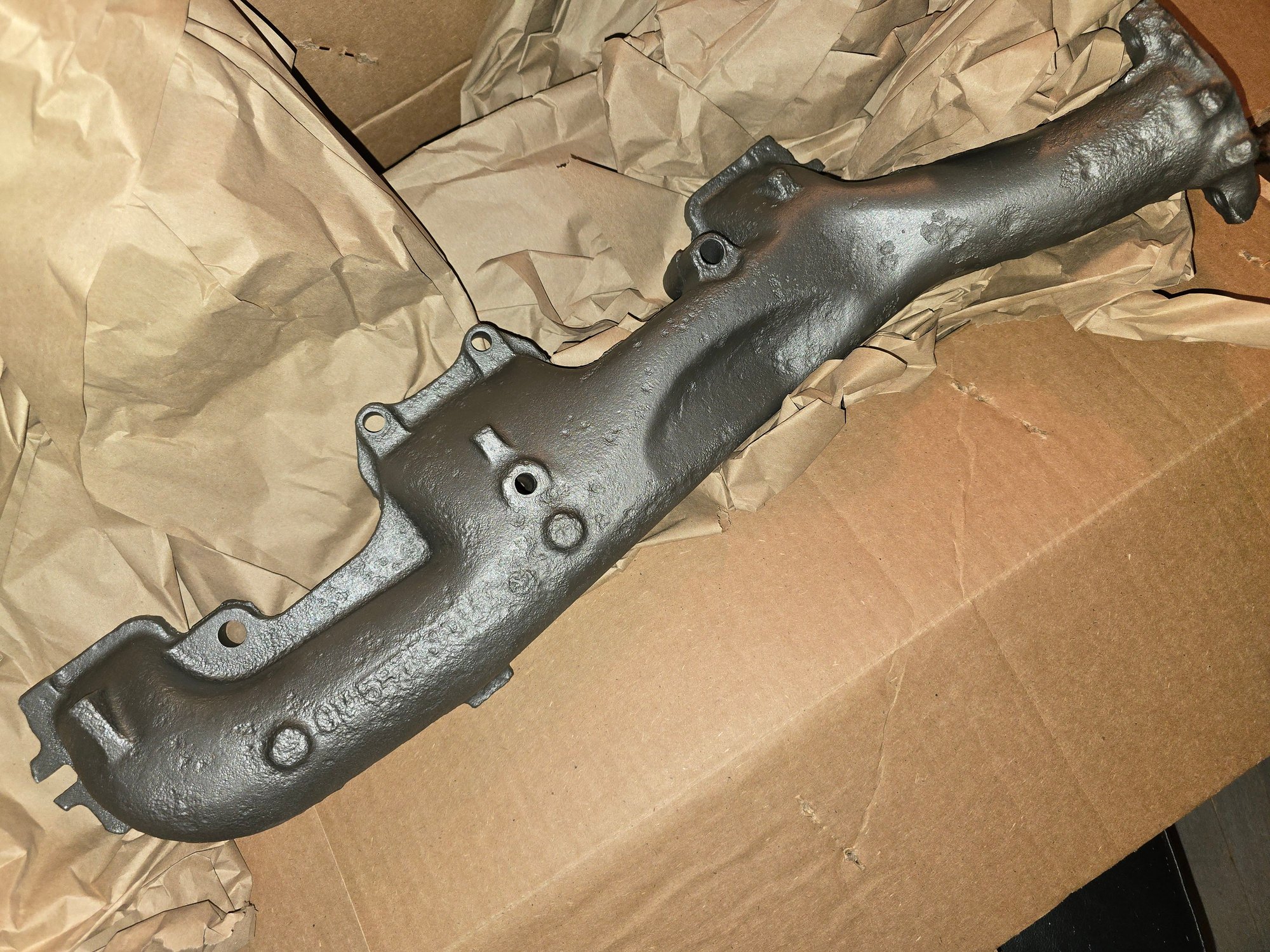

It's sold because I bought it! I guess I'm going with dual exhausts... it's only another grand, more or less anyway...
This thing looks pretty good for a 60 year old exhaust manifold, I think
Check out those ports
Can you say
Can you say "Clean"?
Cmon- I know you can... say it with me....
C'mon- I know you can... say it with me....
"Clean"... that's right, just like that....
oh so clean.... the threads are even clean. Clean threads- dont you love clean threads?
oh so clean.... the threads are even clean. Clean threads- don't you love clean threads?
So- stainless steel or aluminized? Is SS worth 2x the price? I can get aluminized exhaust for about $700, SS is easily $1300. I'm thinking OEM sound- quiet. It's a big old car, after all. Who would delete the resonators for a louder exhaust? Just curious- I'm almost certainly going for the factory sound

If it is garaged, kept out of salt and isn't short tripped, aluminized will last a very long time. Stainless has a different sound to me, aluminized may sound different also but I've not noticed a difference.
If it is a HC engine the duals will sound great and still good if LC.
Please post audio/video when completed.

You will also need a heat riser if you hope to connect to a stock exhaust pipe.
There is this one here;
1963 1964 OLDSMOBILE DUAL EXHAUST MANIFOLD HEAT CONTROL VALVE GM 588008 NOS | eBay
You will also need a large mill file to file the flange absolutely flat, so it mates to the heat riser without leaking.
