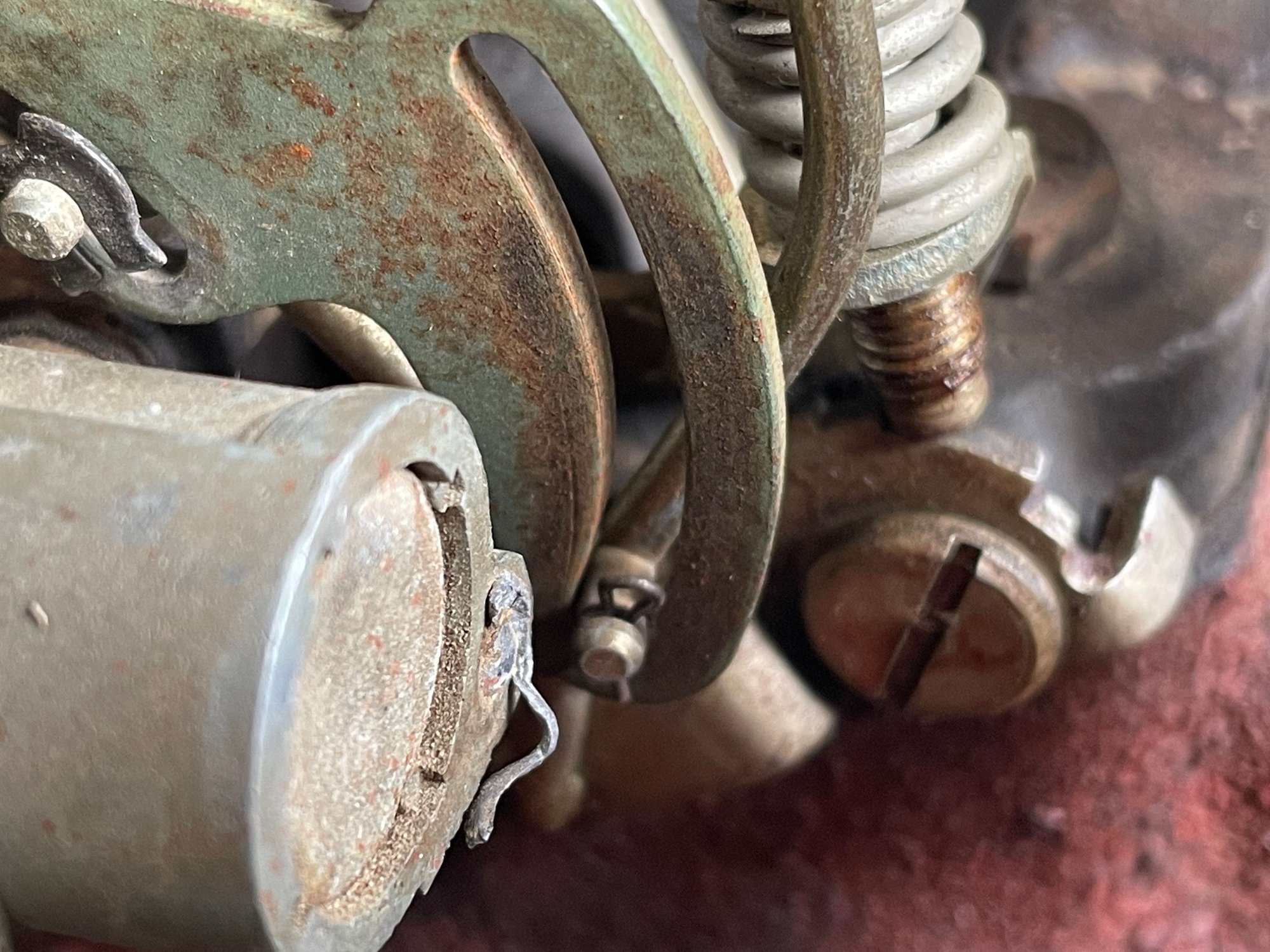

Ok well I went out to mess with it the other day and noticed that the choke was wide open and the lever was limp and I can’t seem to figure out if I’m missing something. I’m uploading some pics and videos. Could whatever is causing the choke to be wide open also be causing the bowl to flood and leak gas ?

Old Nov 27, 2024 | 01:54 PM
Sugar Bear's Avatar
Posts: 4,109
Throttle needs to be depressed to let the choke close, give it a try and let us know.
Post a picture of the black round disc/choke thermostat face so we can see it's index position (7 lines/hashes),
No to the cause of the leak.
The choke setting is dead center. I’m not home right now but I’ll try when I get there.
I'm only familiar with the QJet on my 74. Once cold it stays tensioned and mostly closed until the pedal is depressed which allows it to snap fully closed.
This 2barrel one though is completely limp with no tension whatsoever and wide open and I just don’t know if that’s normal or not.

Does the choke move freely? If it feels stuck at wide-open and you determine that it is rubbing the inside of the air horn, then your air horn may be warped and could possibly allow leakage from the float bowl. I had this happen from tightening the air cleaner bolt too tight which pulled-up the center of the air horn pulling in the sides causing the choke flap to bind on the ID of the air horn. Take the air cleaner hold-down bolt out and tap the hole with a hammer to see if that frees-up the choke. You might need to remove the air horn and see how flat the bottom surface is.
If everything is moving freely, then check the clocking of the thermostatic spring behind the round black dial. As you turn it counter-clockwise (I think), it should apply spring pressure to the green slotted choke lever and close the choke (you may have to blip the throttle to prevent the high-idle cam from limiting movement of the green slotted choke lever). If turning it does not close the choke, then the spring may not be engaging the choke lever on the inside of that round housing.
On another note, it appears that you are either missing a small washer under that choke rod w/ the cotter-pin, or that cotter pin needs to be a round C-clip like that other rod in your photo.

X2 on JohnnyB's post...look into the throat of the carb for polish marks on the sides from a sticking choke plate. Overtightened air cleaner housing will cause this as stated.
Thanks man!! The choke plate moves freely there is no sticking, but I haven't messed with the dial yet and will do that this am. And yes I noticed that it seems to be missing some hardware in comparison to the other similar parts. I’ll look into replacements.

Ive been looking for a fuel line all morning just in case haha. I know inline tube and have used them before but didn’t know I could send one in so thank you!!
I don’t know if I need to rebuild the carb if this fixes the leak, it seems to be running great other than this leak! But it’s a great idea if I donor if it remains stuck

Update
Ok so I couldn’t get either end of the pump to carb line to come loose so I twisted the top end and snipped the connection at the fuel pump.
I ordered a new stainless steel line along with choke tubes for this car and my 74 Cutlass. None of the choke tubes fit either car but I was able to tweak the 455 fuel line to get it to fit BUT now I’m having a few other problems.
1. The fuel still seeped out where the fuel line inlet meets the carb (my original problem) despite replacing the gasket and using teflon tape and tightening best I could.
Three observations about problem 1
a. The fuel inlet threads in mostly by hand: it is not very tight, seems pretty obvious liquid could seep back through loose threading.
b. The little orange gasket is very thin and hard. it’s difficult to see how it could do much of anything if it’s the only thing standing between seal or leak.
c. The Teflon tape seems to dissolve immediately when it comes into contact with fuel. This was obvious because it took a few tries to get things reconnected and check for leaks. Is there something else I should be using to wrap the threads? Perhaps I have the wrong type of tape?
All this being said, where it’s at right now is that the fuel inlet stopped leaking for the moment when I made like 10 passes on the threads with Teflon tape. However I can’t see how this would be sustainable considering I was only able to run the car for less than a minute because of my next issue.
Problem 2
The fuel line connection to the fuel pump adapter leaks no matter what I do. The flare doesn’t seem to be mating perfectly to the male end inside the little brass adapter because it is leaking up from in between the line and nut, through the threads as far as I can tell. Do these things truly have to be perfectly aligned like an interstellar space dock haha? It’s been a struggle trying to tweak the line to get both ends to fit, don’t seems like a tall order to have the angle be perfect.
I googled around and ordered some little 3/8” copper flare gaskets for flammable liquids but I don’t know if they’ll do the trick.
any ideas?

I don't think the threads on the filter housing-to-carb were ever intended to be sealed (I don't think these are NPT threads), the "seal" is at the little red / orange gasket. I would use a thin layer of Permatex black on both sides of that gasket before assembly to the carb (leave the fuel line to filter housing disconnected so that there is not external stressing on that assembly preventing squared-up engagement of the filter housing threads into the carb). Don't over-torque this since the threads here are cut into aluminum and are not the strongest. Let that set up a bit before attaching the fuel line. Get these lined up the best you can by tweaking the tube. Always torque the fuel line at the carb filter housing by holding the filter housing with a wrench to prevent disturbing the seal between the filter housing and carb.
That fuel line on my car had a twist in it next to the filter since before dad sold me the car in '81. It never leaked until about 2 years ago. Inline Tube had the replacement for this application,, but it still required a little tweaking to fit at both ends properly.

You can try to double gasket the inlet nut and putting sealer/tape on the threads do nothing. Sometimes the sealing surface on the inlet nut get damaged or out of square and need to be resurfaced. If need be I have a guy who can helicoil the inlet threads and resurface the sealing surface. The sealing surface is on the airhorn not the nut.
Thats not a bad idea !! Since finding my original leak at the inlet, this will be my last attempt to fix it without a rebuild because otherwise it’s running fine. If I do end up rebuilding I might reach back out to you about your guy

Update, the copper flare gaskets worked at the pump end of the line and the permatex black at the fuel inlet in the carb!!
it’s been running great ever since but yesterday day I noticed a few drops of fuel coming off the throttle side so I’m just gonna call it and pull it off for a rebuild.
