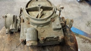

FIRST, as Joe suggested, get a very small funnel or a syringe, or whatever, find the vent stack of the carb., and pour in gas until it starts to overflow.
In this picture, the vent stack of the 2-Jet is located in the bottom edge of the airhorn, sitting slightly diagonal, pointing toward the fuel inlet:
THEN give it a good crank and see if it'll run for 30 seconds or a minute.
If it stalls, fill it again. If you don't pull up gasoline from the tank in 2-3 tries, you're probably not going to, and other possibilities need to be investigated.
