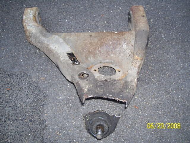

Here's a photo of the broken arm. Looks like the break started at the front edge.

Yeeeeouch!!!
Typically minute cracks will start due to the stamping process and these grow over time due to road vibrations.

Joe's right about the need to have 'used parts' inspected before using them. The cracks start out nearly invisible to the naked eye, and if you do not know what indications to look for, even with a magnifier you will miss them. The 'magnetic particle' inspection (often refered to as 'Magnaflux') will reveal both minute surface AND sub-surface cracks.
Well worth the extra expense vs. a failure on the road (results vary )
