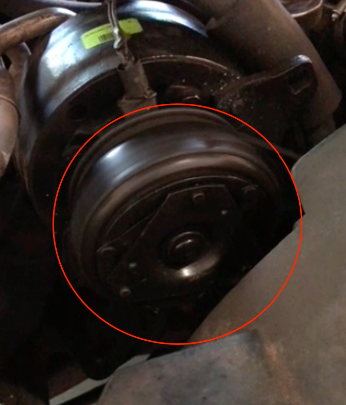

Here's a dumb question can I replace justice front portion of the compressor clutch assembly instead of replacing the whole compressor? I have a little tool that I put my ear to it's like a doctor stethoscope and it really seems like the sound is coming just from this clutch assembly.

Maybe if you engage the clutch with the engine NOT running and remove the nut in the center, the front part of the clutch should slide off the shaft. At that point, remove the pulley and bearing. The magnet is then exposed. I don't think the clutch is the problem though. And if you grenade the compressor, all the debris will go out into the system. Not good.
It isn't a dumb question. Here's what you're looking at. I see no reason to replace the dryer, shrader cores, receiver, accumulator or orifice tube. I didn't hear you ask how to upgrade from R12 to R134A.. What you've circled is basically the pulley which a new clutch kit should come with. If you're the type who gets some enjoyment from DYI projects go for it.
Basically, this is what you're looking to address. Sometimes they'll let you borrow the puller or you can rent it cheap. On GM R4 compressors you'll need a puller - they don't just slip off.
http://www.watdahel.com/tutorials/r4...sor/repair.php
