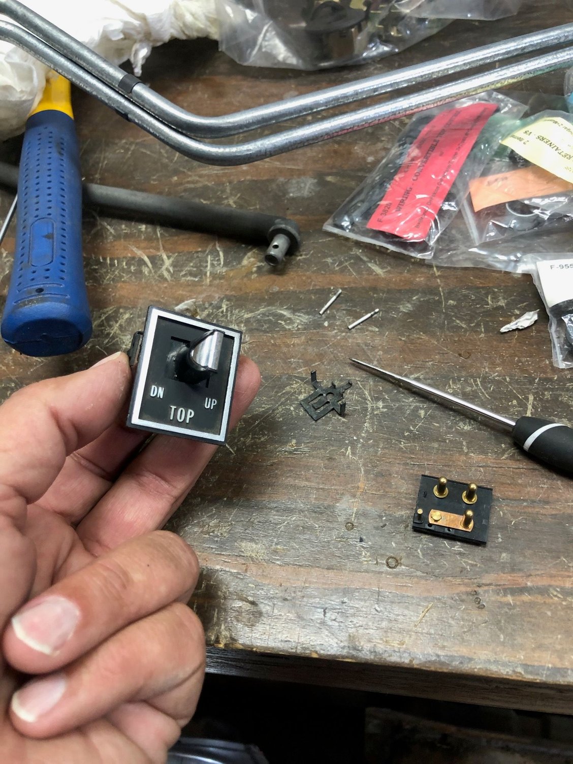

My top switch quit working today. It feels loose and is no longer functioning.
I pulled it apart and can't see anything that is obviously broken. Are there any guru's on the board who can possibly explain what is wrong with this thing?
I've attached a pic of the switch apart. Is anything missing?

Figured it out! It appears there are two tabs on the switch lever that broke off. Drilled a hole through the lever and installed a metal pin. Reassembled and installed.
Works like new again!!
