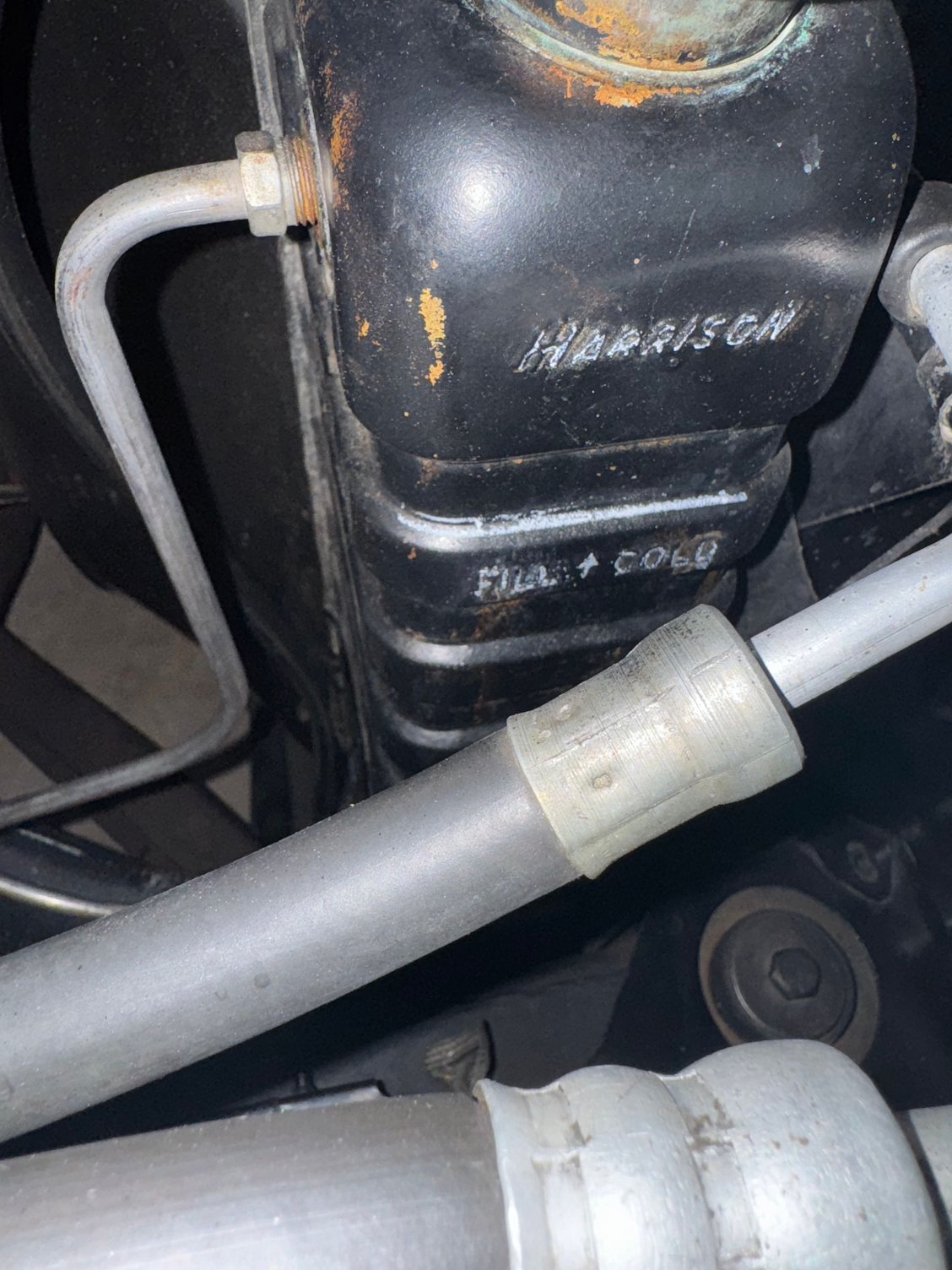

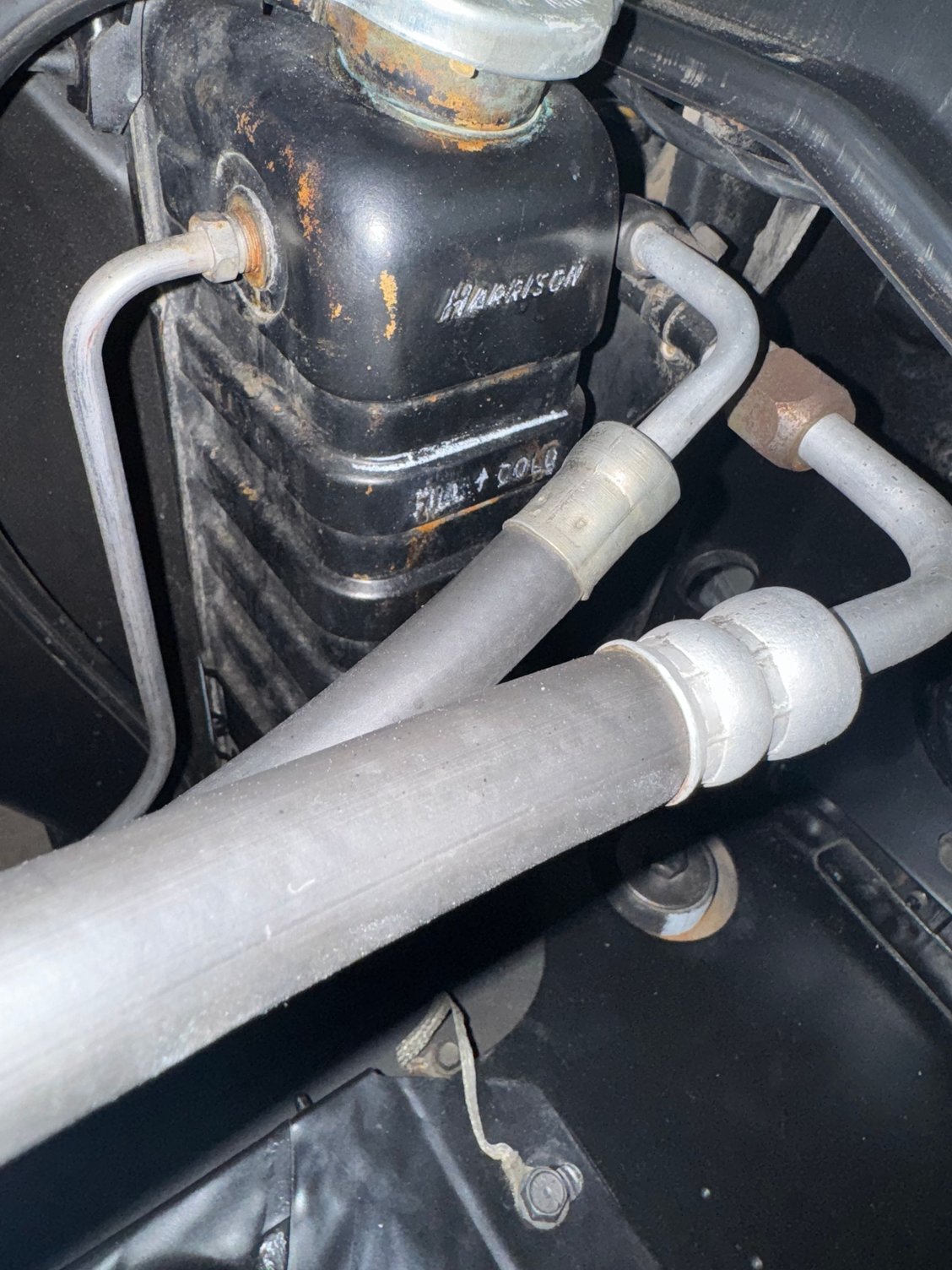

Hi, as it’s been stated you don’t want to fill the radiator…but leave some space for hot expansion. Assuming that the car still has the original Harrison radiator and it’s not overheating and holding proper pressure…it shouldn’t really be much of an issue. I have 3 68s with 455s and original radiators and none of them puke except on rare occasions, even then it’s just a few drops. The original radiators are marked on the side as to the “full” level. Kind of hard to see but here are a couple of shots from my Delmont…I used a white grease pencil to help highlight the marking. Hope this helps. Dave
