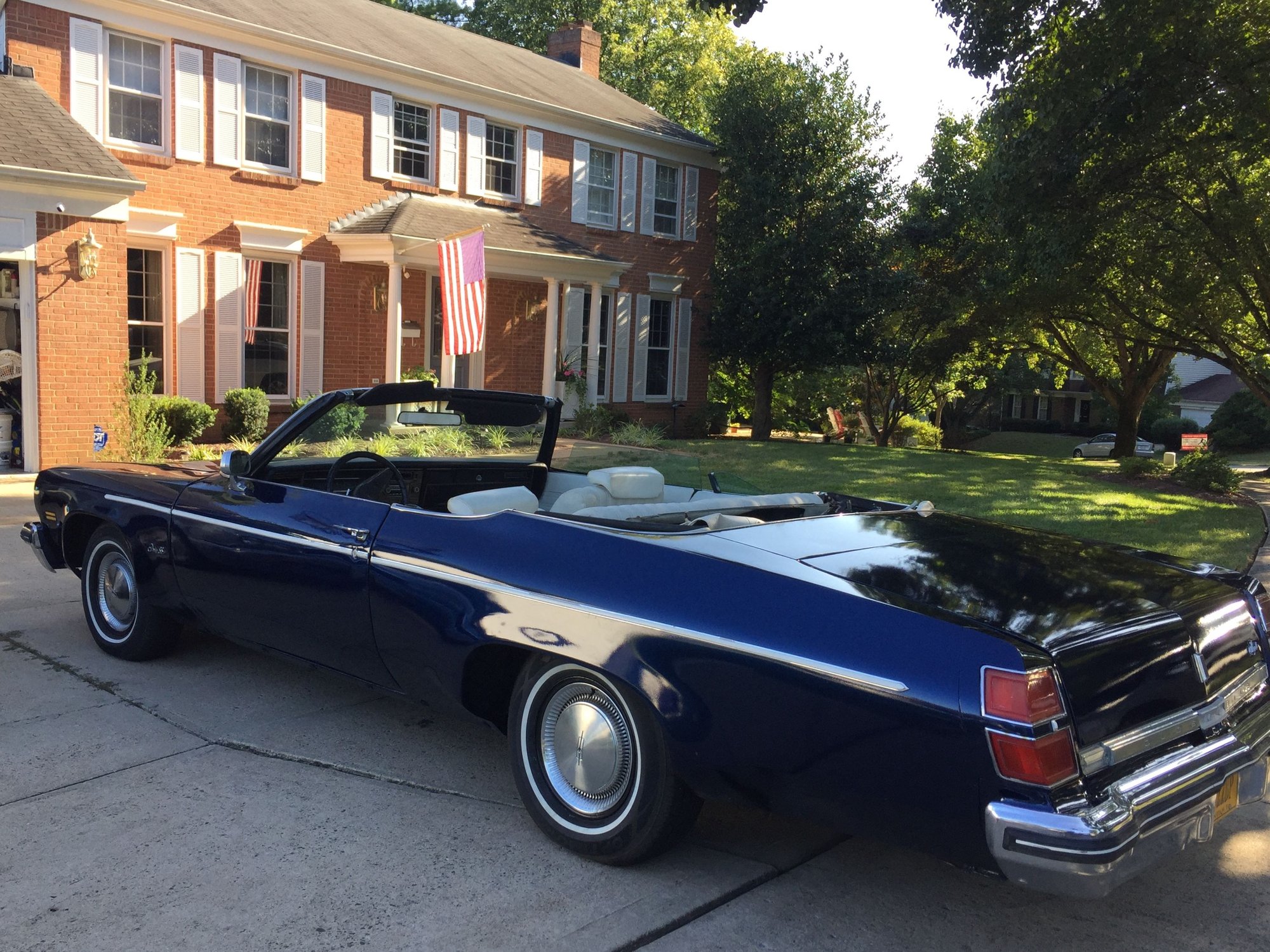

My 1974 Delta 88 Royale. The passenger door will no longer open. Handle button depresses and inside latch pulls but door will not budge. Lock mechanism appears to work as it goes up and down with normal resistance. Would welcome any suggestions. Thank you.
1974 Delta 88 Royale, Second owner, purchased in 1992 in northern Virginia.

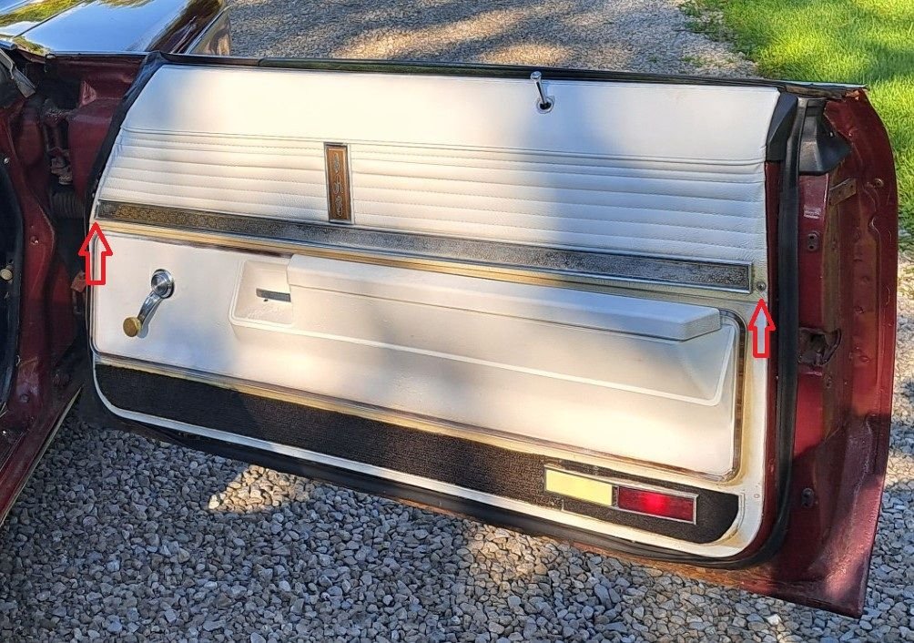

Here's a photo of the passenger door. You're going to have to remove the inner door panels, of which there are two, an upper and a lower. The upper one is removed by removing screws along the bottom edge. I've indicated with red arrows where they are. Your problem is going to be getting at the front one because it's up behind the door jamb when the door is closed. I looked again at my car just now, and it is simply impossible to get at the front screw with the door closed.
If pushing and shoving on the door doesn't get it to open, you might take the car to a collision repair shop. They might have some experience in getting stuck doors open and might have some ideas.
