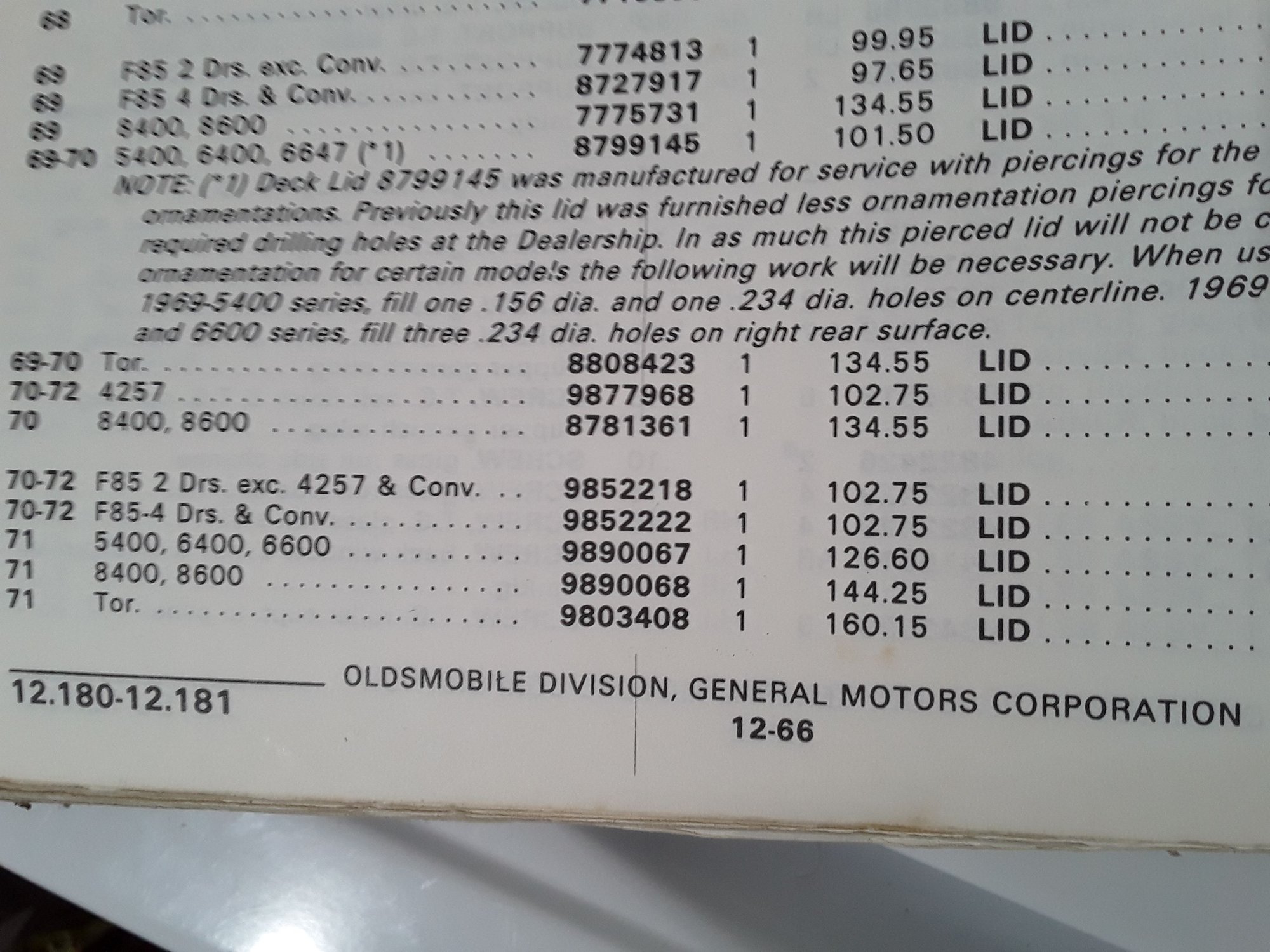

Originally Posted by seansw-31
Is a '72 88 convertible trunk lid the same as a 2dr hardtop? I'm trying to find a decent replacement for a friend's project and not having much luck. Thanks
From Dec 73 factory parts manual. This tells me 1971 and 1972 are different, but each year the same decklid fits all 88 bodystyles.
1971. 5400- 88, 6400- Custom, 6600- Royale
1972. 5400- 88, 6400- Royale

The '71 had the louvers for the ill fated ventilation system, '72 that was gone. So they may be the same except for the louvers.
