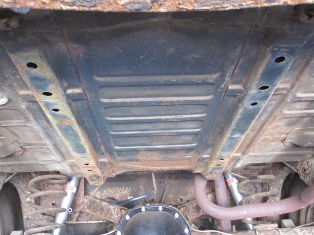

Up date on gas tank GM61A, It's close!! It will require some mods, the mounting locations, the stamped protruding pieces welded to bottom of trunk are too wide, (2") on the car to fit the tank indentations, they would have to be modified, or moved, The tank straps will also be ok AFAIK, maybe a slightly longer bolt, Tank center to center about 15", car is about 17", IMHO, I think its doable, filler neck seems ok also, but did not have tank all the way up do to the interference, I think I'll send mine back, knowing it's an option, and continue repairing my og. tank my new sending unit fits this tank and the tank is baffled,FYI
GM61A Outside to outside mount slot
72 D88 outside to outside mounting pads
72 D88 center to center mounting pads
Possible to modify mounts by narrowing here, Remove narrow and replace??
72 D88 tank mounts.
