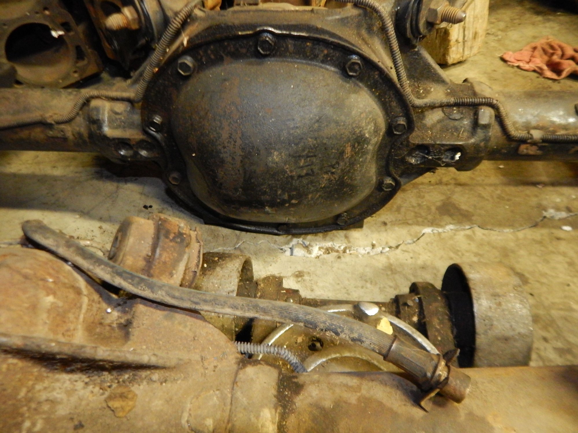

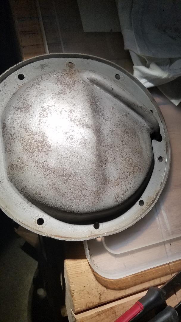

The inspection cover is not shaped the way I would have expected. I'm not an expert, but over the years all the corporate covers I've seen had the notches at the 3:00 and 9:00 positions.

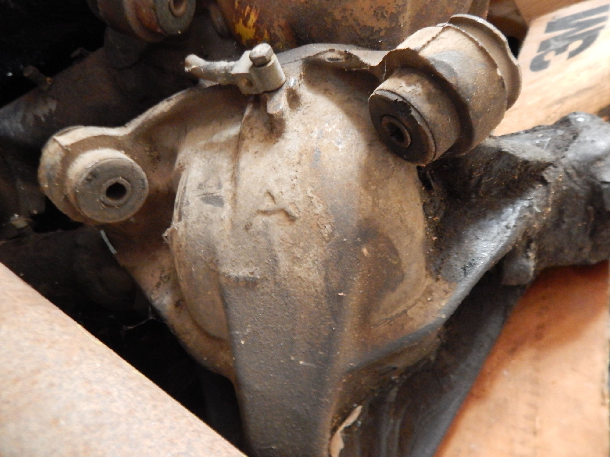

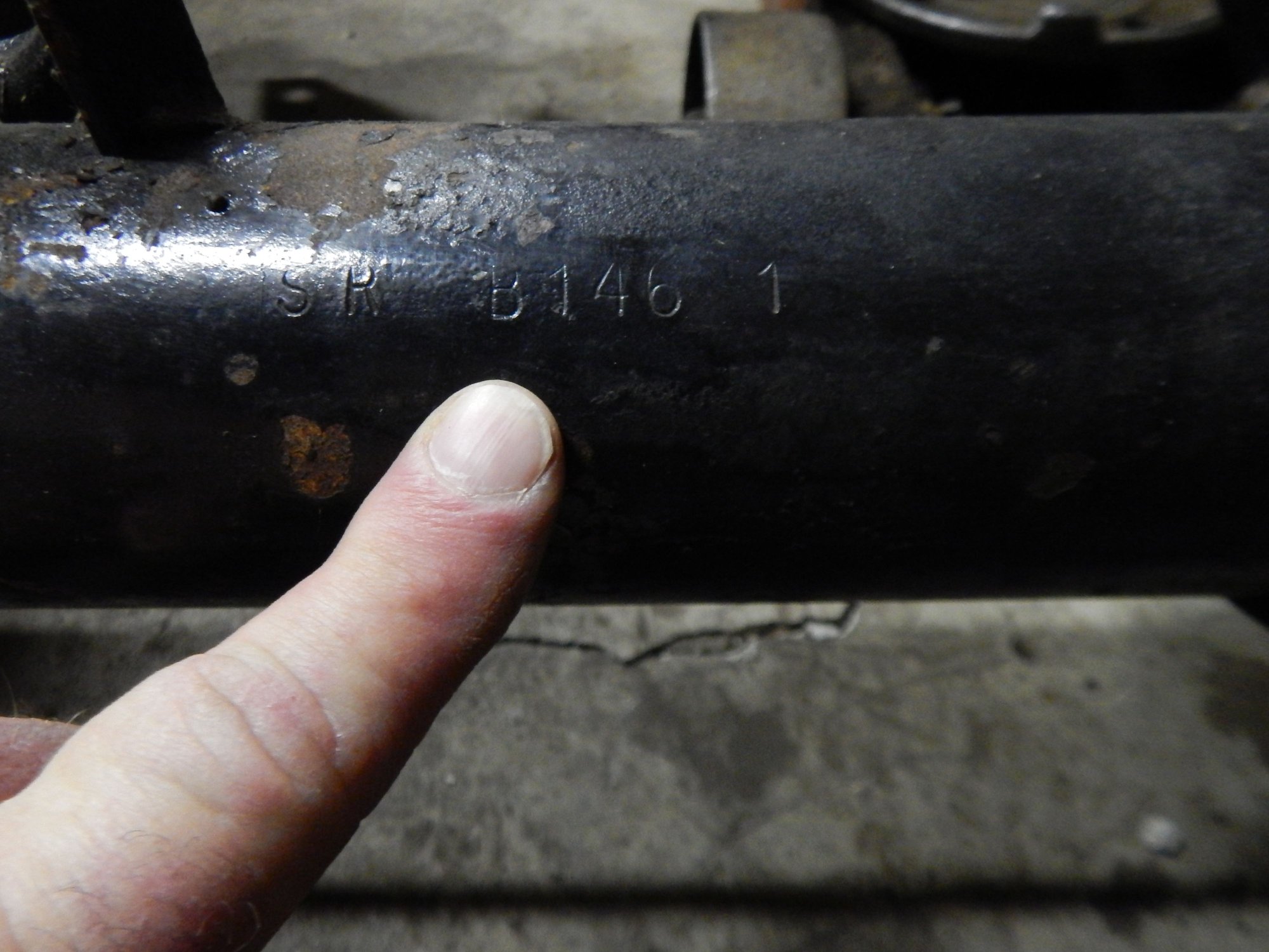

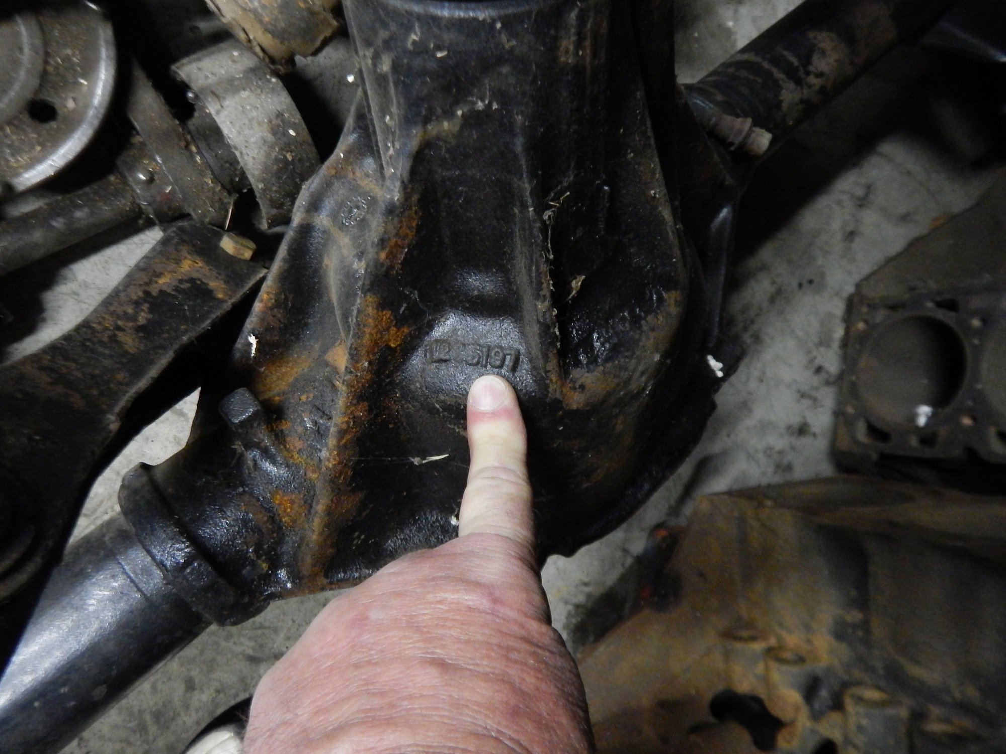

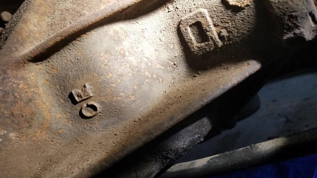

Well, to a rear axle guru it probably would but I don't recognize those castings. Here's some pictures of a rear end I pulled from a 1972 Cutlass. Note the shape of the inspection cover, casting number, stamp in the passengerside tube. If you can't find these things on yours try taking photos of the front of the pumpkin. The location of the raised ridges might help others key out the rear end. I could be leading you down the wrong path as I'm not an expert with these. But I do feel we need to confirm which rear end you have before knowing which wheel bearings it needs.

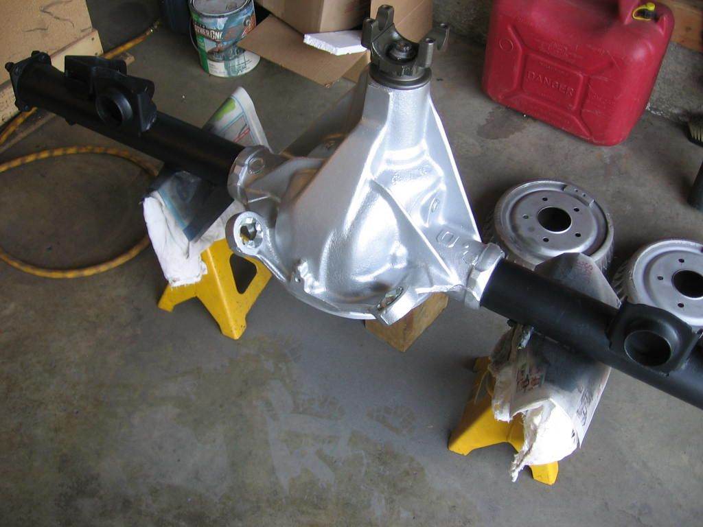

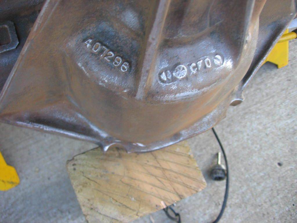

I also have a 1972 Cutlass. Probably the same axle as you since my car is a corporates rear 8.5". These are the castings (prior to painting)
Same as the picture you posted
This one is the part number. Other one is simply the casting from the CFD (Casting Foundation Division - which served all of GM)
The axle bearings look very much like the ones you have in your link
John, I suspect your pictures show a differential from a Skylark. That's just a guess since the axle you're pointing to is a Buick one. Could be someone did a swap into a Cutlass as they would be straight across swap, and IIRC code SR is a 3.23:1 axle; a desirable gear for moderate performance instead of stock axle 2.73 or 2.56. Just spitballing on that.
My Olds Axle is coded SA O 101 (2.73, Olds, produced ordinal date 101 which is spot on for my car being built the same day) But it's now changed out to a code TM (3.42:1 Posi). That required a new carrier I got from Jim Mitchski (JD Race aka Monzaz this site. He even set up the carrier bearings before shipping)

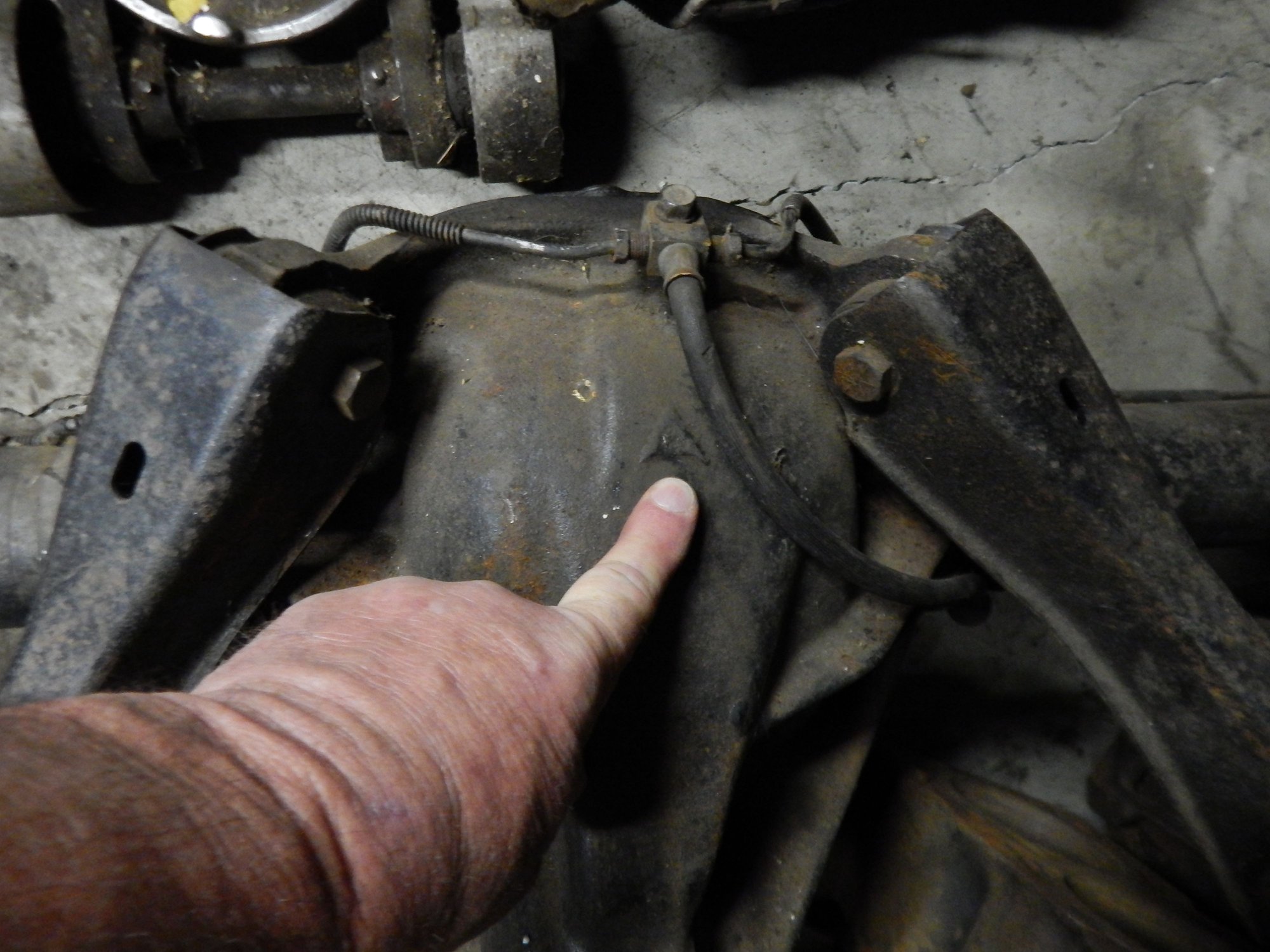

Here's a picture of the top of my differential, clearly no A cast onto it. If you can check your parts book for that axle housing in your picture??

Don't bother with the cover since there are different versions, and the cover can easily be swapped.
