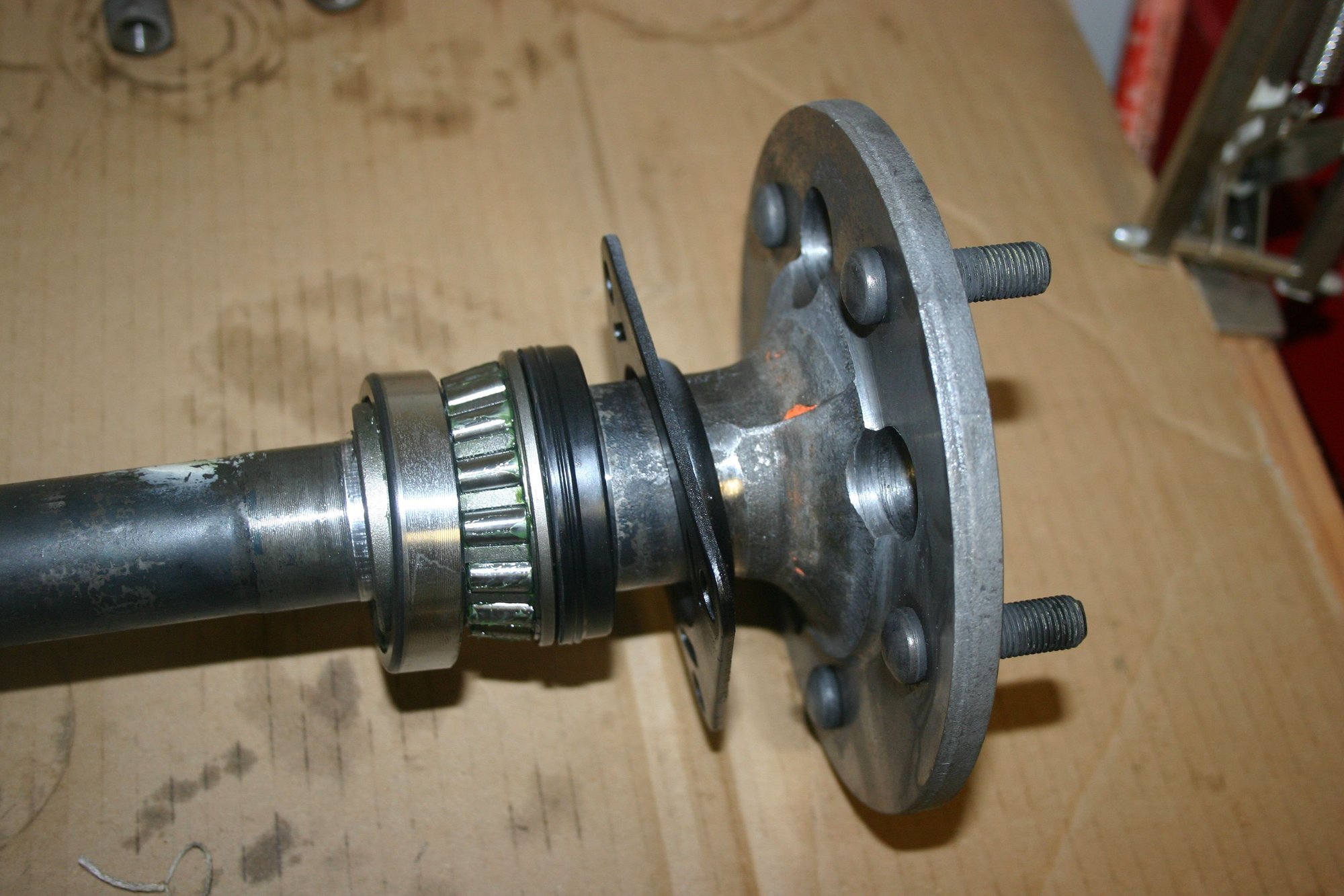

If you have a 1970 rear it will have oiled axle bearings ...12 bolt cover 10 bolt guts AKA 12 bolt Olds 8.5 rear) this was the only year they had oiled bearings for this rear. 67 68 69 were sealed bearing with oil seal in the housing tube end like a dough nut.
From his first thread.... it only sounded like to me from the words is that he wants to refurbish what he has clean it gear maybe bearings and gaskets seals etc that he MAY need to restore this rear to good working condition. NOW what I am trying to get through is NUMBERS are only so good for buying parts for any mechanical item. Different parts can still be in the housing like axle bearings and seals even though the housing is stamped 70 it could be early or late housing which means it could have sealed bearings if it is a early 70 and ot oiled bearing if it is a late 70... ALL depends on the plant. WE run into this ALL the time in rebuilding diffs engines transmissions body panel Everything... lol. Plants will keep the cars rolling because it is money when the line stops... Taht is why I am so on the physical inspection on this thread. ...from his first post. I think we covered it pretty darn good for him ...were good. Jim

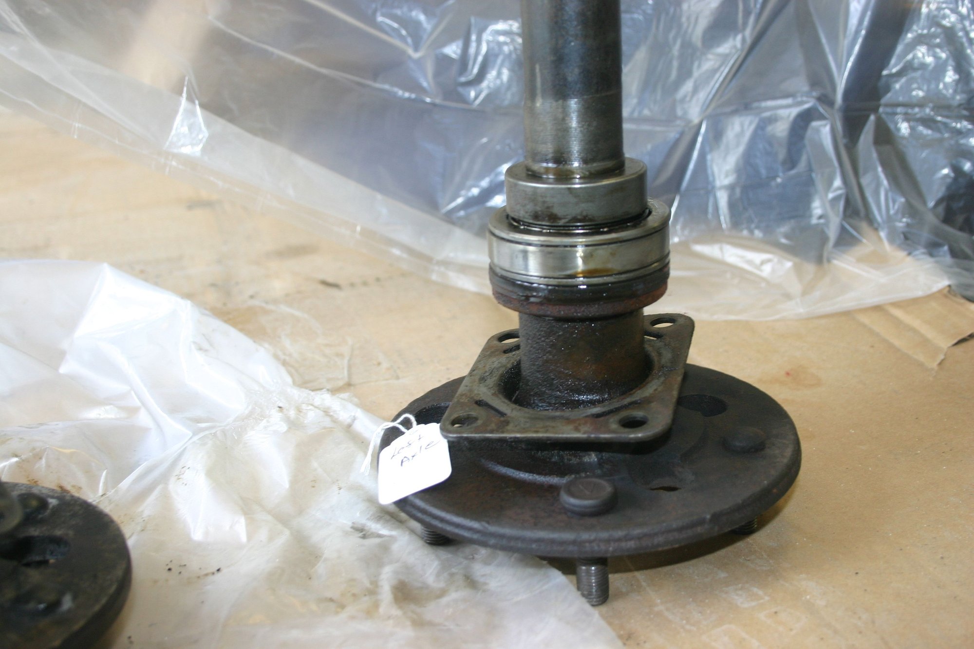

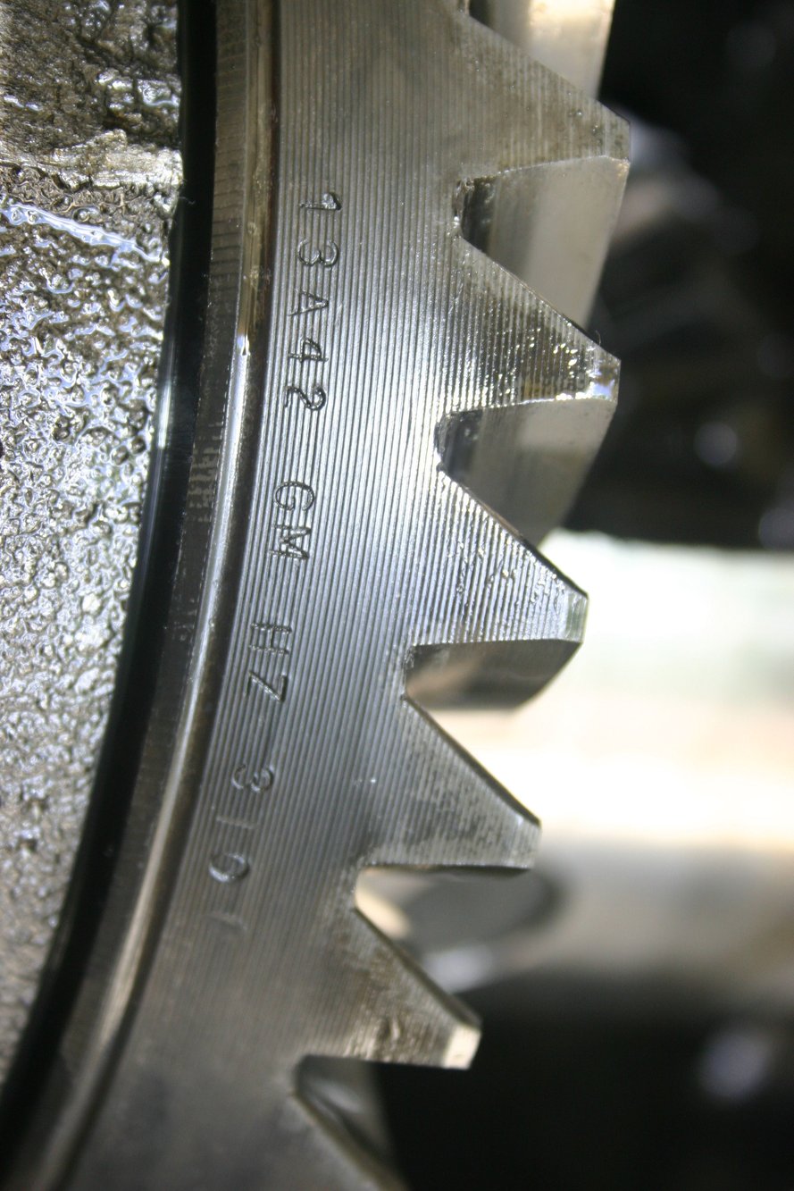

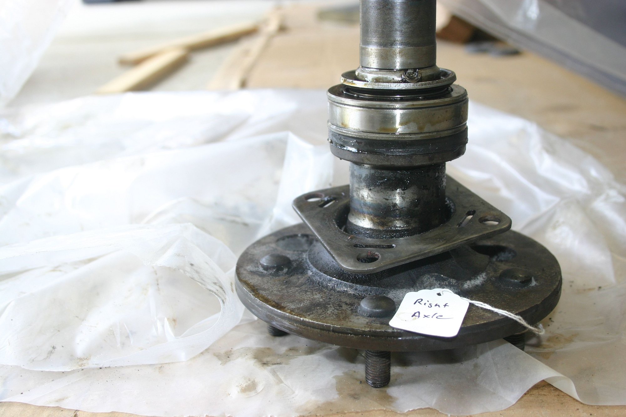

I know it has been a while since I started this post, but got wrapped up in doing other areas of the car. This week I decided to start on the rear end. Started Media Blasting but then decided to Removed the cover to verify the numbers.
It does appear to be a 3.23. Does have a 12 Bolt Cover and 10 Bolt Guts.
Also, pulled both axles. I am going to assume it has been apart before as the left and right axle bearing retainers are different styles. Also, if you look close at the right axle between the seal and axle retaining plate, it appears to have gotten very hot as some point. I would think that is not a good. See below pictures.
I am thinking I may as well continue with the disassembly. It will certainly make it easier to media blast the case. So, I guess I am back to my original post. I am looking for any advice and recommendations on needed parts for refurbishment. The Axle seals were not leaking when I pulled them out. I am not sure if that axle is any good.
I am hoping Jim (Monzaz) will pipe in as I would like to get his advice and buy any needed parts from him.

Looks like a nice clean 3.23 rear
It is a 1970 rear as the axle bearings are oiled type.
The right axle is STOCK from the factory crimped retainer and the other left was probably change way back in the late 70 -early 80 as it still has the Bower straight roller bearings which I BELIEVE to be superior to the newer tapered bearing in the trouble free area. The straight roller bearings have not been available for 20 years. ...UNLESS some one found one on ebay but the looks of the seal it has been on there for a while.
You can take the axles to a machine shp and chuck them up in the lathe to determine straightness.
check the splines for roll or twist.
looks like some studs were replaced on the LEFT axle as the one stud is not seated all the way.
Jim
