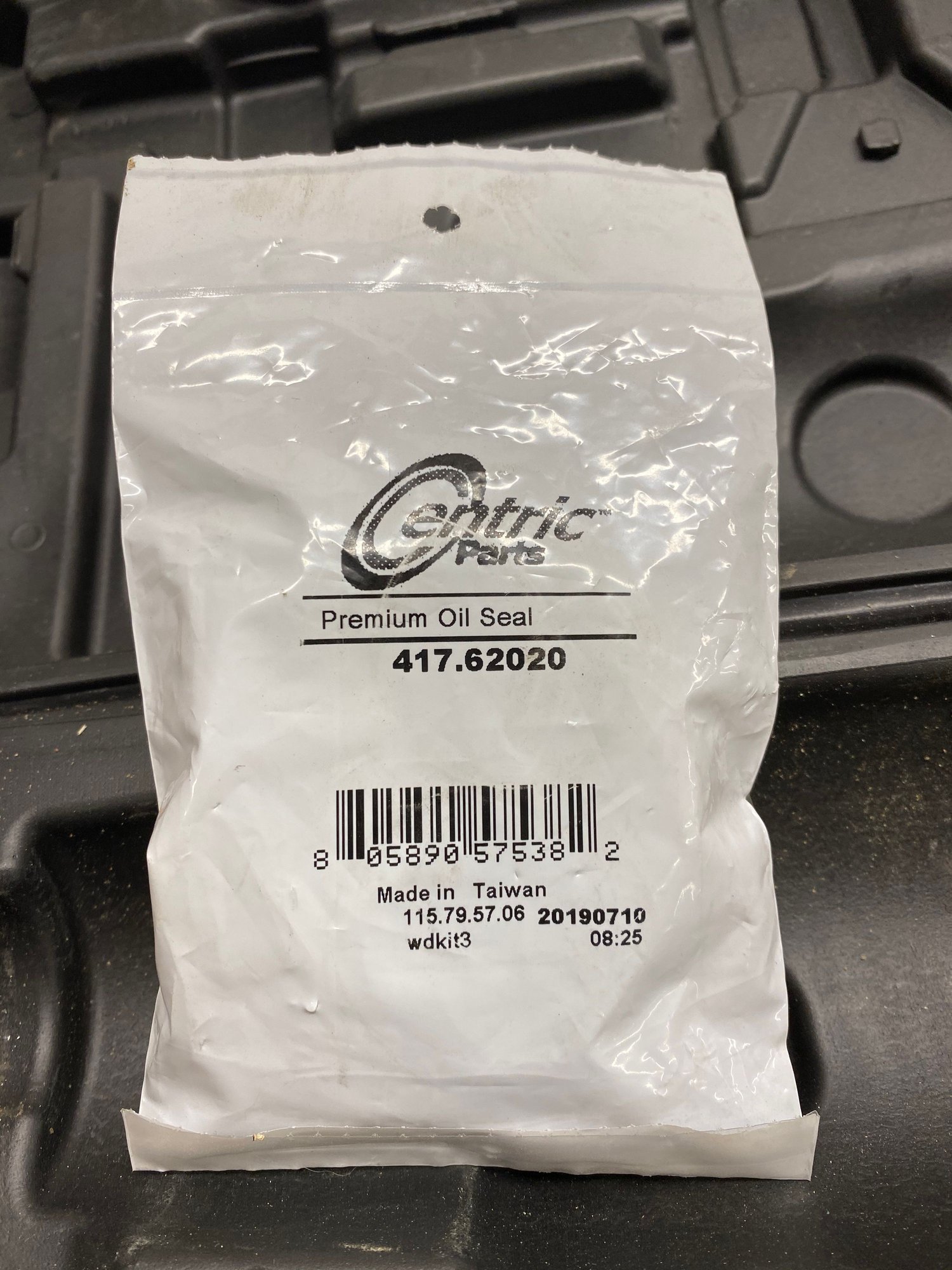

I have a leak on the axle, it was there when I bought her. My question is do I need anything else other than the seal that I was given with the car as if I read posts correctly doesnt the bearing need to be replaced when changing this?
Is it a difficult job for someone with reasonabe skills?

Ok that is a sealed bearing axle seal ... It is the type that gets pressed into the housing flange end and your axle shaft will slide through the center of the seal doughnut hole.
YOU DO NOT NEED to replace the AXLE BEARING ON THIS type of rear differential UNLESS your bearing is bad.
THE oiled beaRING axle where the axle seal is on the axle shaft and then the bearing is pressed on after the seal goes on the axles is the one where you have to do both .
So hope that helps
1964-1969 are usually all sealed bearing system and your seal will fit those housing rears.
The 1970 - 1976 BOP rears will have the oiled bearing and your seal is not correct for them.
Hope this helps.
Jim

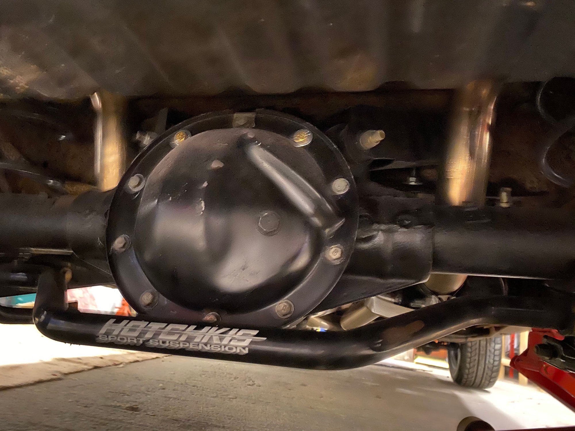

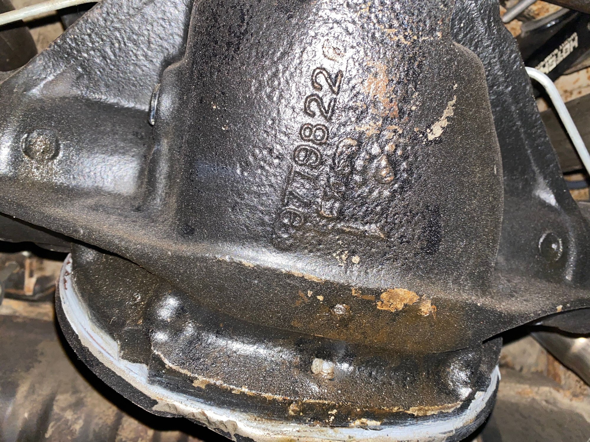

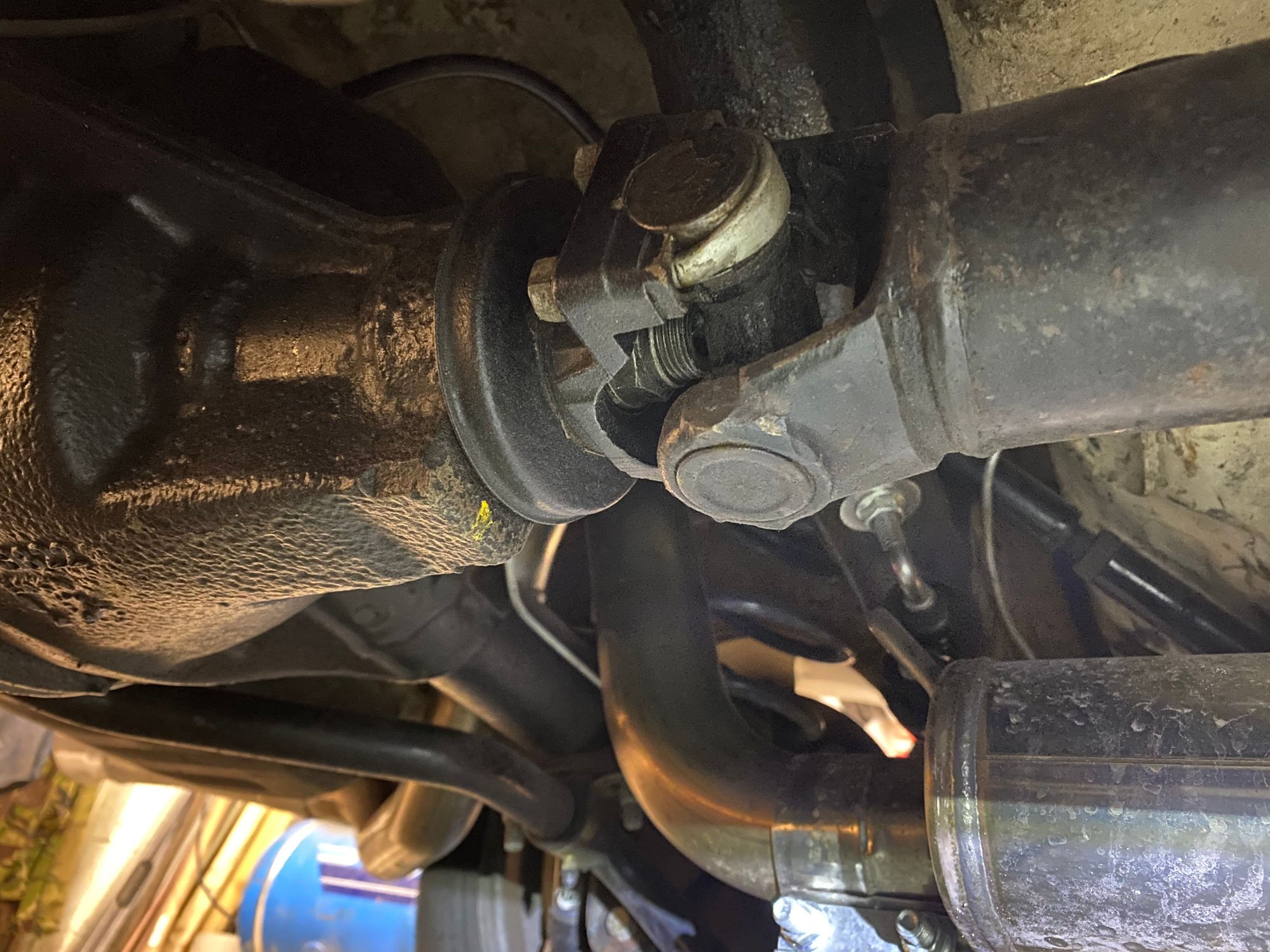

Do any of these help?
Old Jan 19, 2020 | 03:13 PM
Posts: 15,394
I am not certain, but I think that is a Pontiac 8.2 inch 10 bolt. Hopefully someone who knows a bit more about rearends can verify that. If it is, then you have the correct seal per Jim's earlier post.

Rear id
The casting is a 1965 Pontiac rear
10 bolt 8.2
It is the early NARROWER housing 54.25 wide or 60" over all
So it is NOT an original rear.
The cover is also wrong ...That cover is for a 1971-1977 GM 8.5 or 8.2 chevy... Some one probably redrilled the cover a bit to fit.
YOU want to buy a BOP early 1964-1970 cover for Buick Olds or Pontiac with the scalloped cut outs at 9 and 3 o clock example picture for you.
The rear is a good rear and you should not have any trouble finding parts for the rear if you need to fix or upgrade.
The seal you have will fit this rear also.
Jim Mitschke
