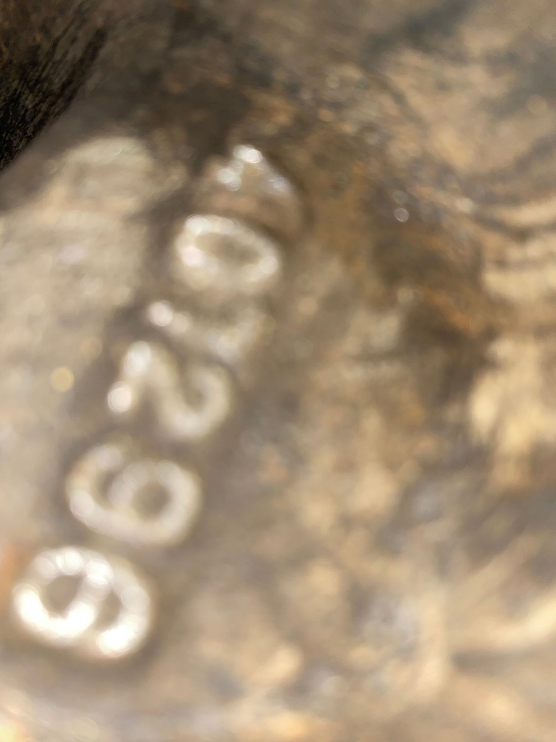

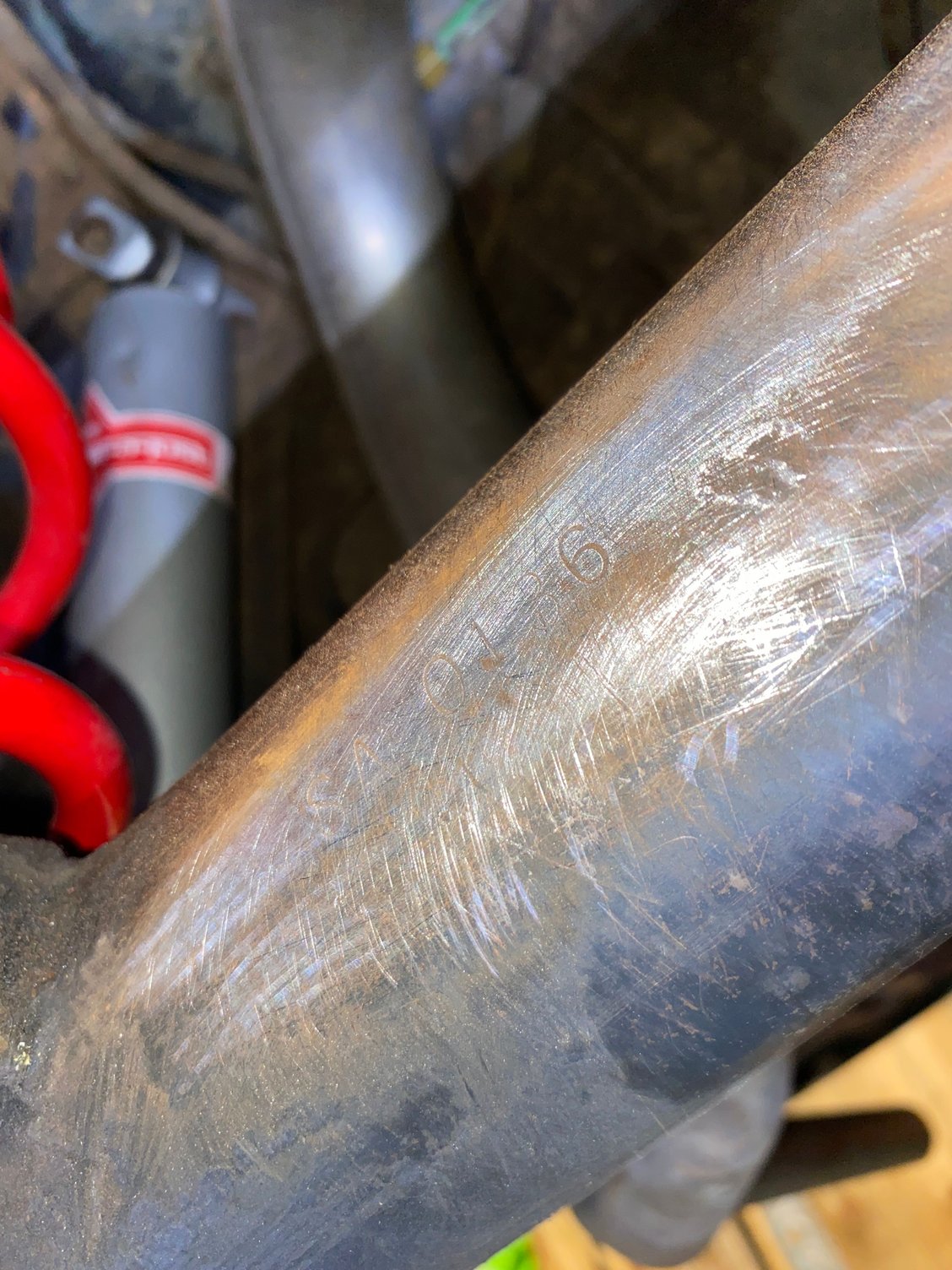

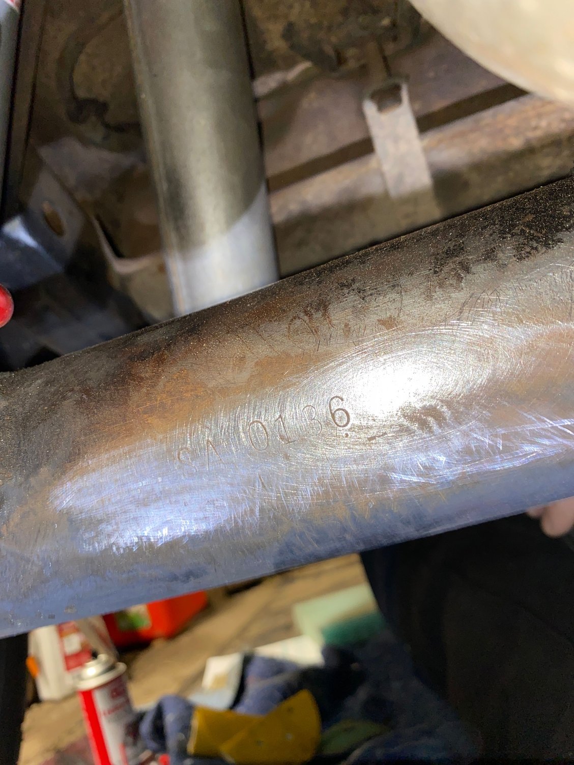

Can anyone help identifying what I have? Thanks in advance.

407296 casting = Olds 71 72 8.5" 10 bolt rear end.
SA code = 2.73:1 gear ratio (I think).

Norm, the casting number identified it as a 1971-1972 Olds A body 8.5" 10 bolt rearend, which is independent of what vehicle it currently calls its residence (this rearend would fit under any GM A-body car from 1967-1972). Note that the CSM does not provide this information.
