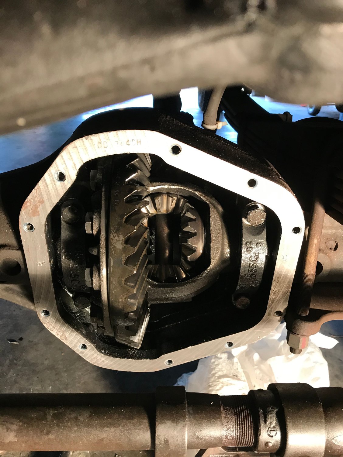

You need to clean both surfaces - cover & differential - be careful - no gouges. Stuff some t-shirts or similar inside the differential in case you have old gasket material flying everywhere while scraping off old gasket. T-shirts are nice because they don't shed lent material & they soak up the old cruddy oil nicely. Once you get to about the final stage of cleaning the mating surfaces, you can use some brake cleaner to wash them. I have bags of steel wool. I use steel wool embedded w/ some brake cleaner to give the mating surfaces a final cleaning rub-down. Clean the bolts well w/ a wire brush. Here's something else I do which is overkill most likely. I put the bolts I removed back into the same holes I removed them from.
Image of the front differential on my F250 4x4 to give you an idea of amount of gasket sealer. Something to note regarding gasket sealer(s). I never tighten bolts to torque value right away. I put on sealer, let sealer set thirty minutes, install cover w/ gasket, hand tighten all bolts, torque to 1/2 torque value, let valve cover set at 1/2 torque values for one to two hours, then apply the final torque. You get a better seal when the gasket sealer has a little bit of time to cure before final torque. Easy peasy. I'm getting ready to change my transfer case fluid in a week or so. This was the 4th time I changed front differential fluid (image). Truck has 200K miles.
