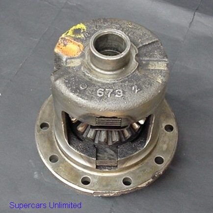

A friend is looking at an Olds "O" Type Rear End. Pulled the supposed posi carrier out and unbolted the ring gear.
No identifying numbers on the carrier. Can anyone help with identifying this?

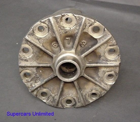

Couldn't agree more, but don't have a picture. Carrier has been removed and ring gear removed from carrier. No numbers in the casting, front or back. Supposed to be posi with 3.42's for an "O" type.
I am slated to purchase this posi carrier and gears for my 70 Cutlass with "O" type rear. Everything I have read and viewed, SuperCars site as well, says carrier has numbers cast into it identifying what series the carrier is.
Has anyone seen a GM carrier without casting numbers? I am beginning to wonder if it is something other than an "O" type?
Please help! I am going to have to make a purchase decision fairly quickly.

No Casting Number = Not Olds "O" type.
YMMV,
Good luck with your decision.
Old Feb 25, 2016 | 08:48 AM
Octania's Avatar
Posts: 7,286
Anyone who cannot tell a posi carrier from an open has no business touching the assembly with tools.
That said, no, I have never seen a GM carrier with no cast-in ID numbers, indicating it may not be a GM part.
Surely the ring gear itself has the tooth counts stamped into it, from which the most basic of math will reveal the gear ratio?
Not that this info would ensure that this part fits into and works in a '70 Type-O rear end... Sounds like a gamble. Can you take it to a local gear shop and have it looked at by folks who do this all day every day? Just based on how hard it is to find '70 Type-O parts, I would say, "not likely".

"A friend is looking at an Olds "O" Type Rear End. Pulled the supposed posi carrier out and unbolted the ring gear. "
This still has me puzzled.
If it was an entire rear end, why not just buy it and be happy?
Why pull out the carrier, and having done that, why remove the ring gear as well??
There's a lot of red flags here.
One can spot a posi immediately after removing the cover. Or, by simply turning one axle vs the other. So, that should not be an issue. Either it is, or is not, a posi.
If it was assembled, and working.... "if it ain't broke, don't 'fix' it" as they say.
To an extent, who cares if the carrier is a #673 real GM or aftermaket Eaton with no PN on it? If it works....

Surely when the cover was removed, the posi parts were visible, so that should be easy to verify.
In my limited diff internals experience, I have found that the 67-70 type O units do not interchange parts with others, and even within ratio ranges. You would be wise to have the experts such as mr trick take a look, tell you what to look for, etc. Maybe at least measure the OD and spacing of the carrier bearings.

What all the others said! its not Olds type O without the casting number. prob 10 bolt chebby

Probably not the same seller but I just drove up into Michigan today for the exact same thing. 3.42 posi o type. I noticed you don't need to pull the carrier at all to see the casting numbers. The one I looked at was a TM code 3.42 with a 588 carrier. All right out in the open with the diff cover off.
