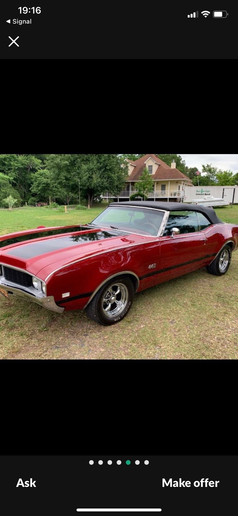

Hey folks, excited to be able to buy my dream car. A 1969 442 Convertible. I bought it with a 455 bbo from a 71. Previous owner said that the motor was rebuilt but once I saw the J stamped on the heads I knew that the engine was not built by a guy who knows Olds. (Either that or it was a budget build).
Anyhow, I plan on pulling the engine in a couple months but one of the first things asked was what gears am I running out back. I googled and googled and could not find out what damn gears came with. Its a 69 442 convertible with a 3 speed auto. I looked underneath and it is a 12 bolt. Can anybody enlighten me? Did they come stock with posi?
Please don’t bash me for being a novice. My dad had a 69 Olds Cutlass and I remember riding in it as a kid and he loved it. I would remember him punching it and I’d just chuckle. I knew one day that I needed one of my own...
below is a pic of my ride..

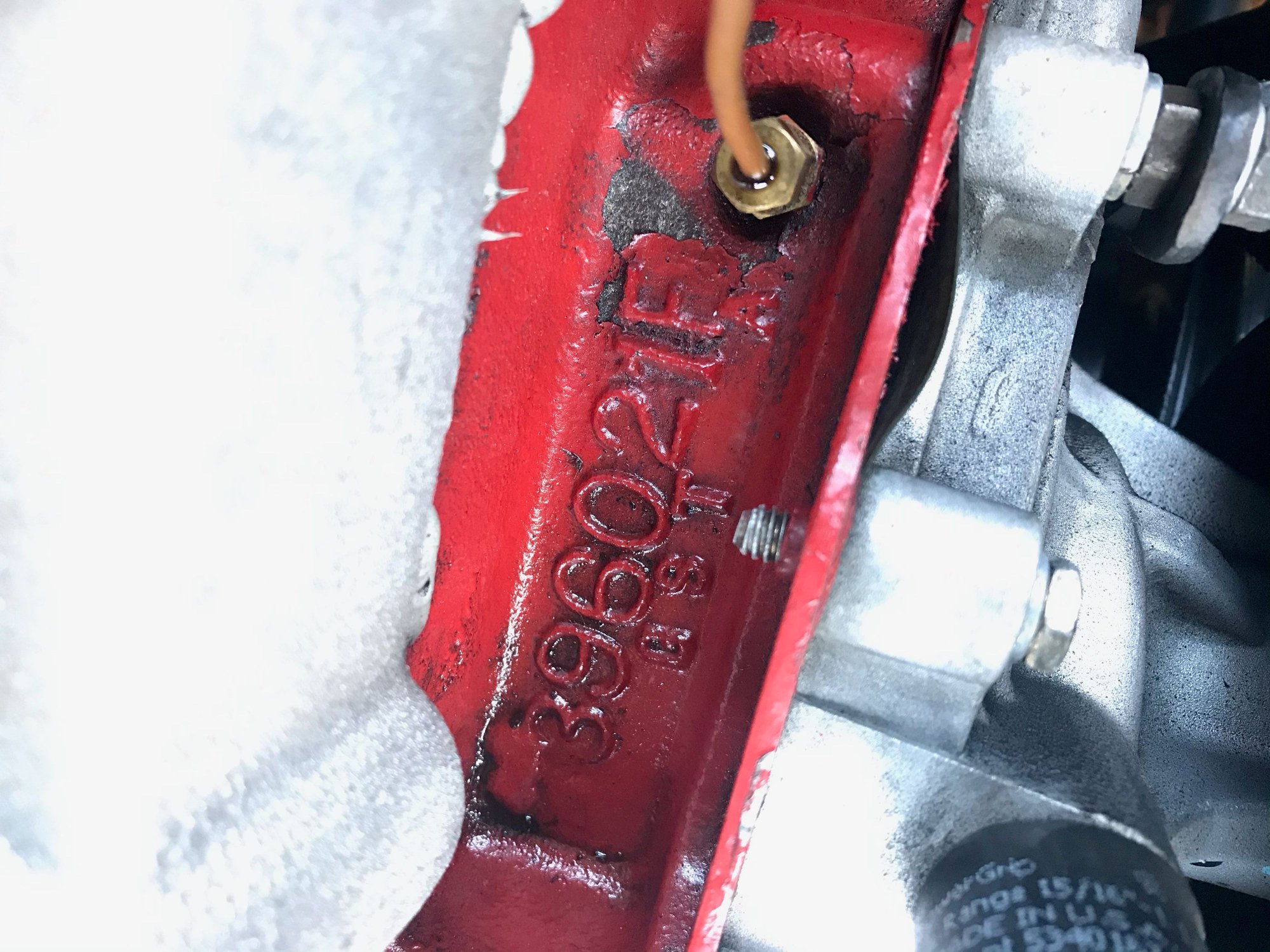

hey thanks for the reply. The stamp on the block was 396021F (with no A). From what I read, that seems to be correct..but again, I’m no Olds guru. And yes, I will definitely look before buying the parts for a differential rebuild! Anybody recommend a reputable site to purchase rear end parts?
The first thing you need to learn on your quest to become an Olds guru is that much of what you may read, especially on line, will be incorrect. Despite what the notorious FAQ says, there are documented cars from 1973 and 74 with "F" (not FA) blocks from the factory. I personally have an "F" block with a 1973 VIN derivative stamp, and it's a san-serif "F" which supposedly was only 1968-70. The VIN derivative stamp on the block will tell you exactly what model year that block came from, with no fuzz on it. The second character is the model year.

That is an FA block, so consistent with 1973-up heads. Check the VIN derivative stamp.
hey thanks. So block is consistent from the boring era as well then right?

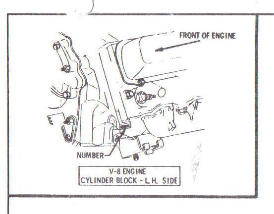

If the VIN derivative hasn't been machined off, you can determine the year of your engine block by that number. It will be stamped into a raised pad on the driver side forward on the engine block just below #1 cylinder. It's usually hard to see because it is somewhat covered by the power steering bracket and/or the alternator bracket. I strongly recommend buying a '69 Chassis Service Manual and a '69 Product Information Manual (PIM - also referred to as the assembly manual). As well, a handy little book that Supercars Unlimited puts out, titled "4-4-2 By The Numbers" is pretty good quick reference guide in checking a number of things on your 4-4-2.
