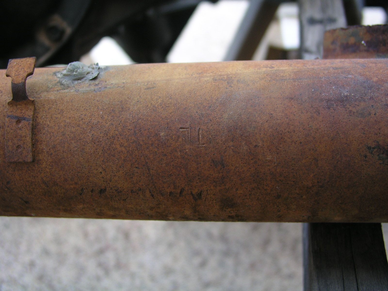

Axel code TL ?
Any one tell me what a TL code on the axel tube is ? Thanks Matt
Old Oct 29, 2019 | 06:18 PM
Posts: 15,394
On my 1968 O-Type it means 3.42:1 ratio, open diff, HD 31 spline axle shafts.

From: Fredonia,Wisconsin
Thanks, that verifies my axel is original wish it were posi though, poo!!
