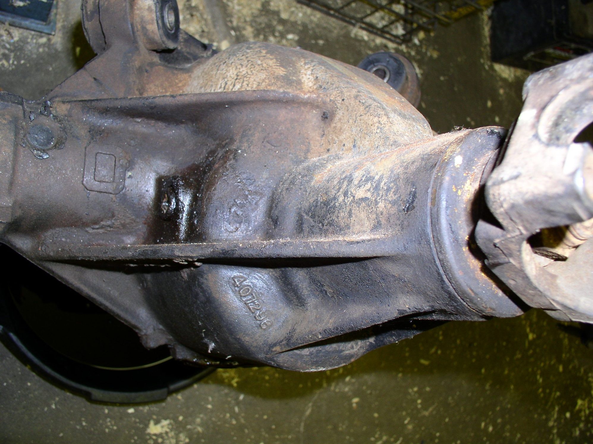

Here's a pic of my 1971 8.5" 10 bolt:

Posts: 15,394
At $100 each I would buy them. I appear to be a hoarder, though.
