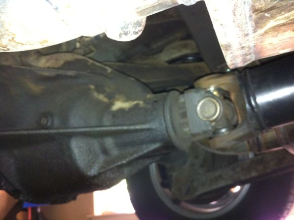

Old Sep 21, 2016 | 07:30 PM
Posts: 42,475
I believe I have 3:08's. A friend put this same kit in his 66. I'm going to get under the car and see whats stamped on the housing and take a pic.

On the side of the housing there are ribs. B type has one single rib -, P type has 2 ribs that converg to a forward facing point

Quick and simple, the Type O has 12 bolts on the cover and its roundish. The 8.2 only has 10 bolts in the cover and at the 3:00 and 9:00 O'clock positions a C shape portion cut out of the cover. I agree with the other guys that in 1967 it could be either one.

Here are the pics:
Old Sep 22, 2016 | 08:39 AM
Posts: 16,688
That's a Type 'O'. The parts on Ebay are not what you want.

I sent Jim a PM and pictures. I had never in all my years of tinkering messed with the center section of a rear end. This is a learning experience for me. I figure I need to replace the pinion seal, cover seal, and rear control arm bushings. I MAW upgrade to a posi and a better gear. Axle bearings are all good, replaced a few years back.
