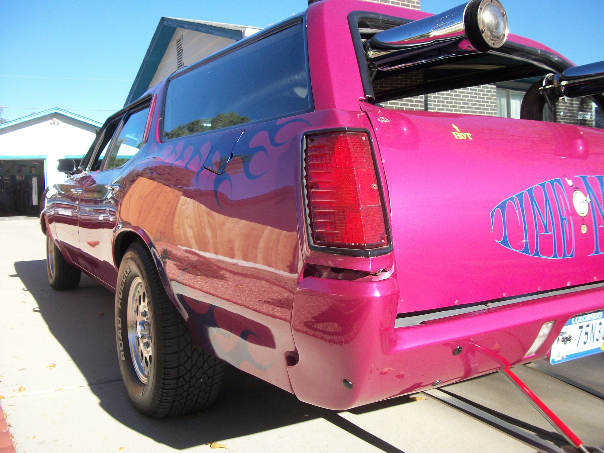

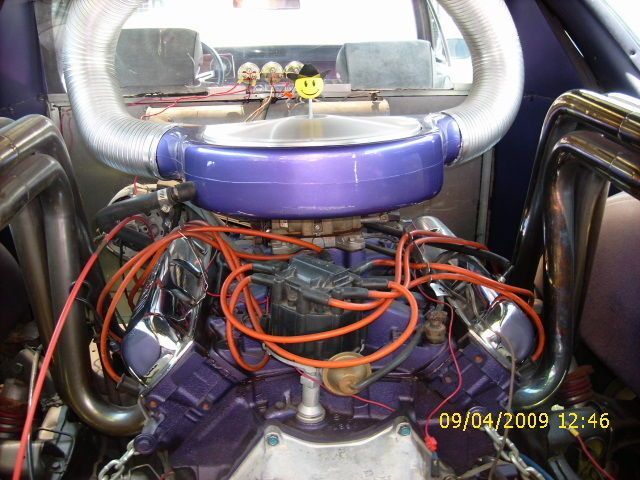

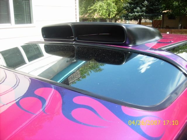

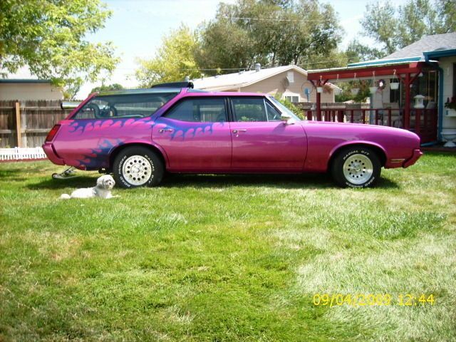

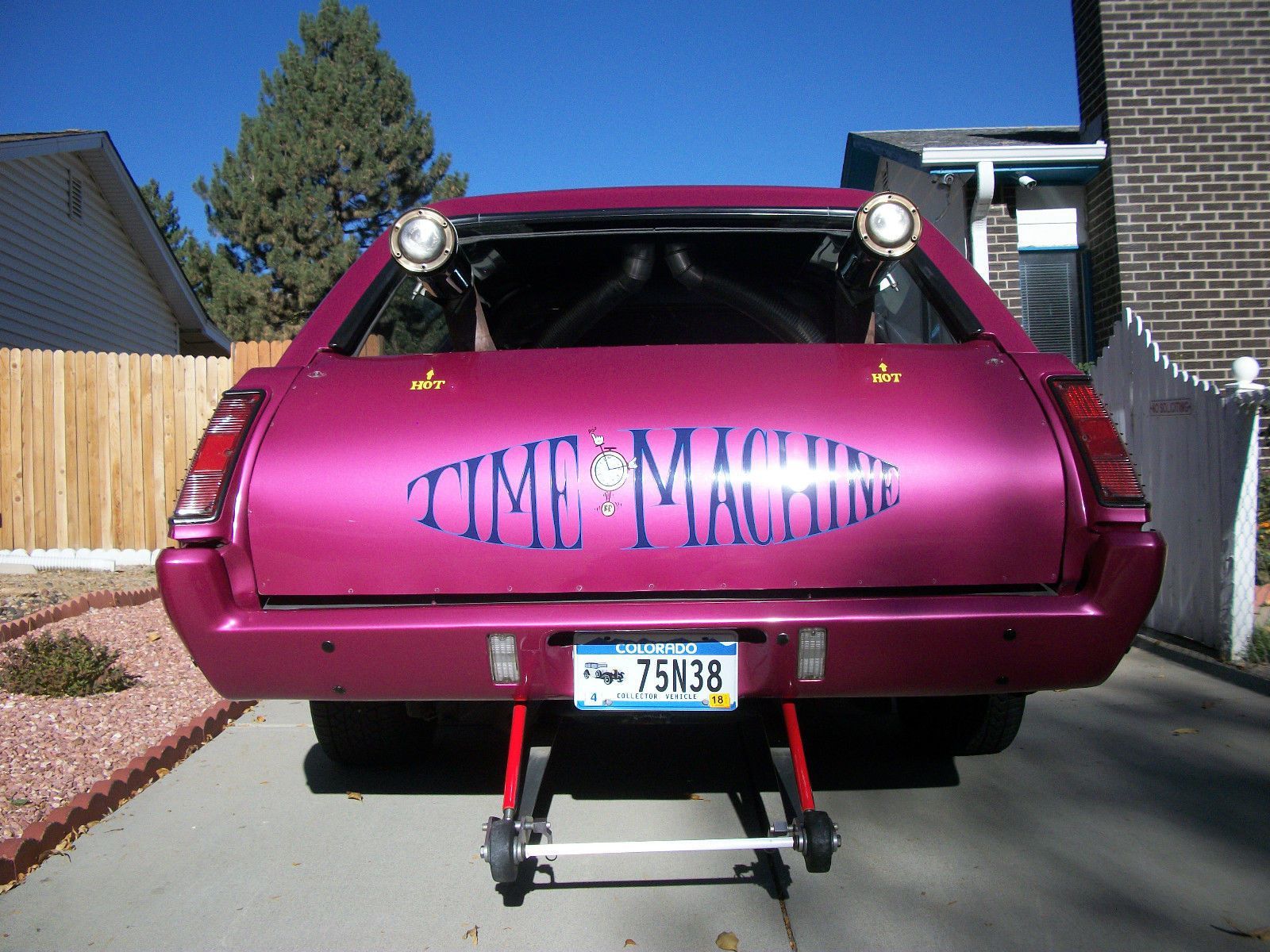

I probably will go for a 3.42 or 3.55 depending on availability. It's for my project vista that I bought a few years ago and haven't gotten very far on. I rebuilt the motor and trans but need to redesign the rear suspension for better safety. The previous builder took the frame and drivetrain from a 71 toro and cut the vista frame out of the back of the vista and put the toro one in.

Montevaleplace- That thing is amazing!! I'm sure everyone would like to take a better look at it! Why not start a thread on that car, or if you already one have bump it up, I would like to learn more about that one!!
