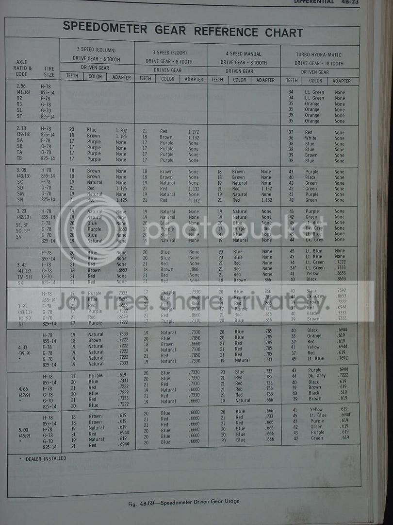

This is straight out of the 1970 service manual.
Old Sep 11, 2015 | 01:29 PM
Posts: 50,815
And since the stamp is usually upside down, I'm assuming the "OS" is really "SO", which is a 3.23:1 axle.
