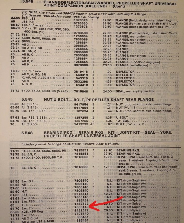

AC Delco 7806140

@joe_padavano Is there an on-line site to lookup cross references for old GM part numbers with new replacement part number? Not sure if you saw my initial reply to the OP, but it appears AC Delco 7806140 is an old obsolete p/n. I would be interested to know how to look up the most recent part number and order it through RockAuto

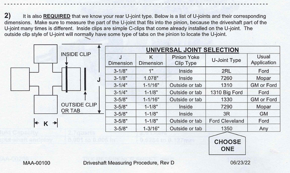

To be honest, I purchase based on dimensions and C-clip location. I typically use the Moog 534G with the grease fitting in the yoke or the Moog 235 heavy duty piece with the grease fitting in one of the caps.

I have a Spicer 3RL on my ‘70. (Greaseable)
