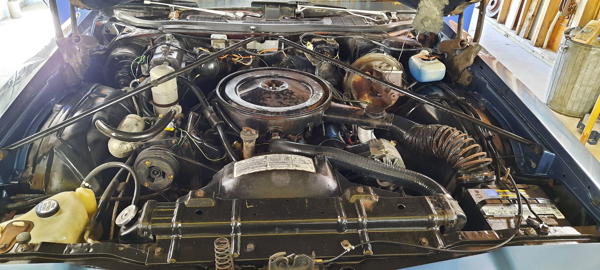

Any better?
If I were trying to sell it I would do some serious work on detailing that engine,

The engine does look better. I would try and find a new hose going to the air cleaner. If I couldn't find one I think I would take that one off. That thing looks bad.
