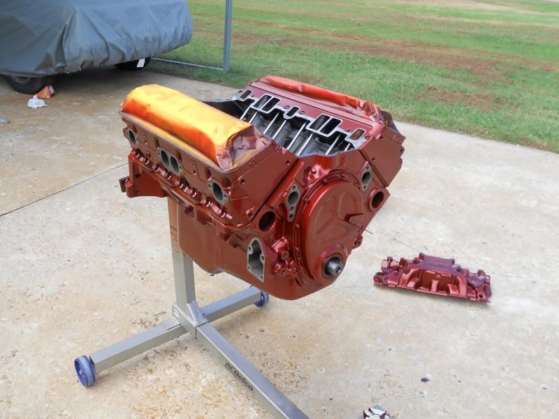

I had traded for a 350 from a 70s model truck. When I tore it down, it was in excellent shape. All standard but 2 bolt mains. I took the stuff to the machine shop for checking and he said he would not bore it and just polish the crank. He was impressed with the lack of wear and so was I. He hot tanked it and put in new cam bearings. I brought it back home and 3 stone honed it and then ball bead honed it. I polished the crank myself. I ended up using X bearings to get it in spec. Its all together with new rings, bearings, Cloyes timing chain, Summit cam kit #1103 444/466. I put on a freshened up set of center bolt heads from an 88 truck. I used a Weiand intake for the center bolt heads. Not going for big power just want it to sound good and pass a car if needed. I'm going to use the pulleys from an 87 IROC with the wider belt and v-belts for the other accessories. Here it is painted body color
