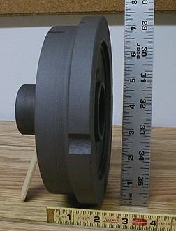

Maybe a W31 balancer? See photo...

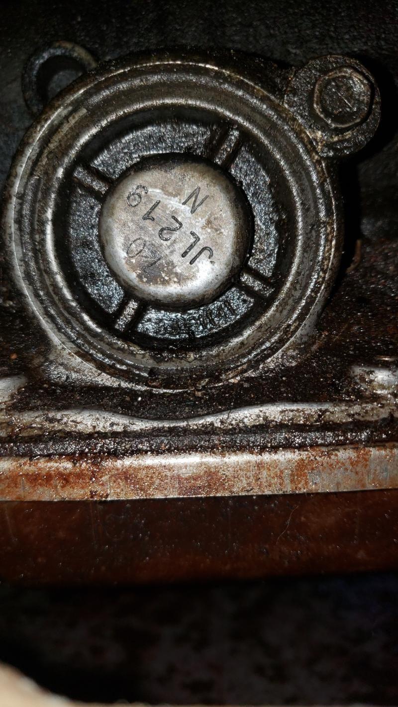

- Transmission code appears to be JL219 as stamped on the servo cover. I have to lift the car to see the vin derivative stamp if it's there, and to look for any other ID plates)

I don’t think that’s a w31 balancer.
https://classicoldsmobile.com/forums...lancer-135471/
https://classicoldsmobile.com/forums.../#&gid=1&pid=3

I'd have to agree. I was having a hard time finding a good description of the W31, and this one was "sorta like" one, and was different from the others in my shop right now. The smaller diameter portion of the W31 photo does look quite a bit chunkier than mine.

And a W31 balancer looks like this.
As compared to this:
