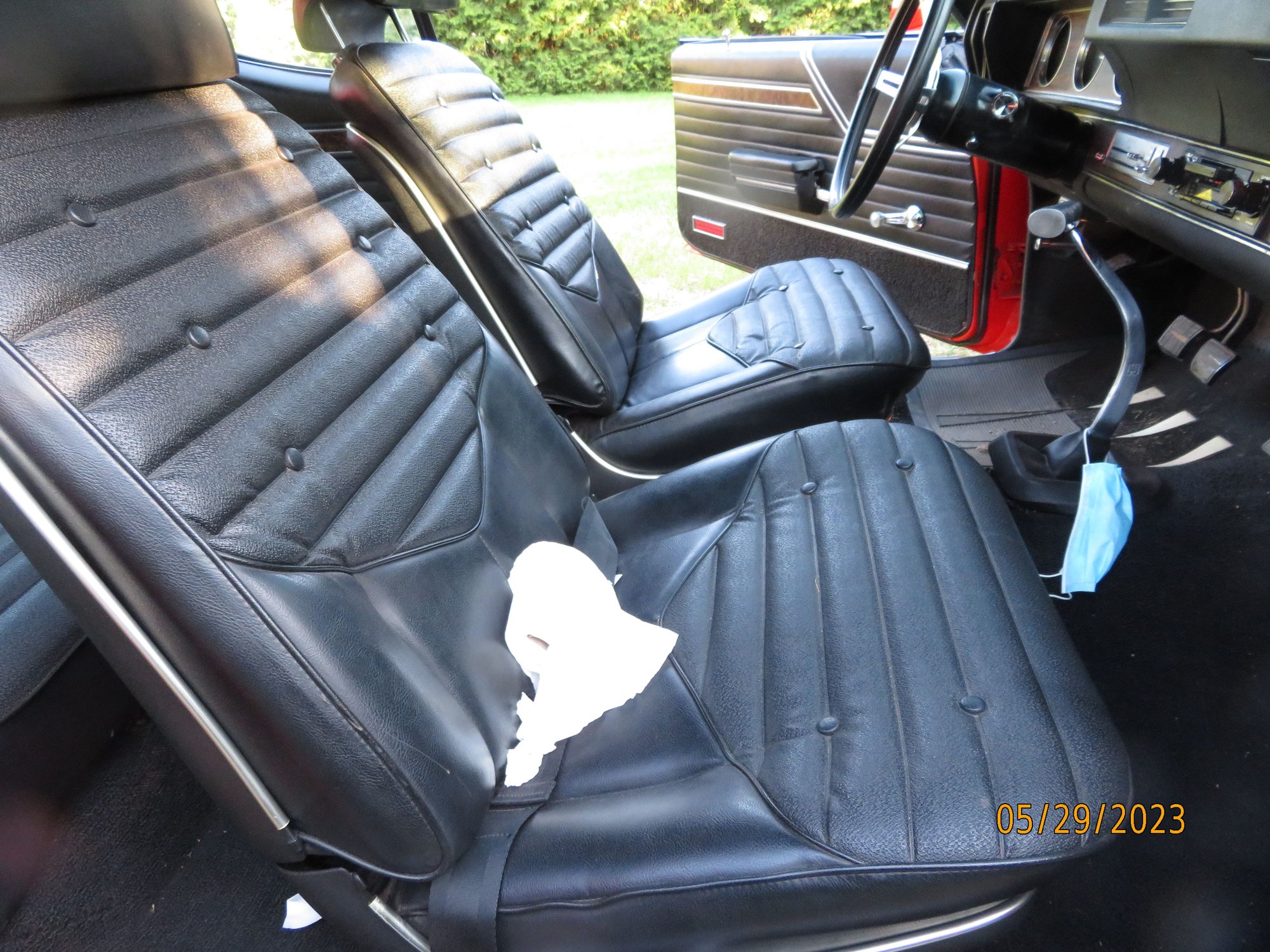

Well this is the car, very nice car but the guy that I was helping with the purchase couldn't come to an agreement on price, and passed on the deal ($62K Canadian.....aprox.$46K US), a friend of his ended up purchasing the car apparently for $61K..
Old Jun 7, 2023 | 01:09 PM
Andy's Avatar
Joined: Jan 2020
Posts: 2,895
From: Sarasota Florida
If its a true w31, correct drivetrain etc, paper trailed car then 46k us is a good price I would think..She looks beautiful..is it staying in Canada?
Old Jun 7, 2023 | 01:14 PM
hotrod442's Avatar
Joined: May 2017
Posts: 127
From: Ontario, Canada
It's definitely a legit W-31, the only large ticket item that I could not confirm as original is the M21 (was not able to get under the car to check)
Old Jun 7, 2023 | 01:25 PM
tnswt's Avatar
'70 4-Speed W Machine
Joined: Feb 2020
Posts: 1,248
From: North GA
Notice the oil sending unit on the engine. Apparently a functioning original.
Old Jun 7, 2023 | 06:04 PM
Posts: 9,479
If it came from the factory with 3:42 gears, then it would have the M20.
Old Jun 7, 2023 | 06:52 PM
v8al's Avatar
Registered Olds Owner
Joined: Apr 2018
Posts: 1,131
From: Los Angeles, CA
Looks like a nice driver car.
Am I correct in saying the TCS should be mounted on the passenger side? Not sure why it's mounted in this location.
Old Jun 7, 2023 | 10:32 PM
  #31
hotrod442's Avatar
Joined: May 2017
Posts: 127
Look closely at the front lower corner of cylinder head, to see the battery cable tube mounted there? (Obviously should be located at the rear of the cyl. head)
The car had a non OEM, replacement steering box, that the owner figured was to sloppy to pass a Safety Check. He (the owner) had the car "restored" (about 4 years ago) at a restoration shop that I'm sure many here have watched on TV. (Restoration Garage on the Discovery Channel) I think he would have been better served to have taken the car to an "Olds Specific" restorer. The striping is not quite right (as is often the case), door fitment needed work (which when corrected, would cause the stripe alignment to be out),the firewall has been painted body color (easy fix but ?), Oh, and there was a fair size "scuff" about 10 diameter, in the passenger side front fender, from hitting the garage door while backing the car in/.out.
Not sure what work was requested to be performed during the "restoration", but I went on the "Guild's" website were they have a few pictures of the car before/during the restoration. They have one picture were the body is off the frame, and mounted on a dolly.......so they had the frame out from under the car, ......yet the frame has not been blasted/detailed it appeared like it got a "rattle can" touch up done to it. That being said, the frame, and under body are in very good condition.
The exhaust was also redone, with the headers pictured, as well as Flowmaster Type, exhaust that leaves a bit to be desired (hangs to low under the car, shitty looking welds on the joints, tail pipes stick out way to far, etc.)
On the more positive side, you can tell by looking at some of the details that this car has always been well cared for, (and stored inside)..........the door panels, carpet, and front/rear seats are original!
It is a definitely a VERY nice car, but I estimate it'll take about $10K to get it right
