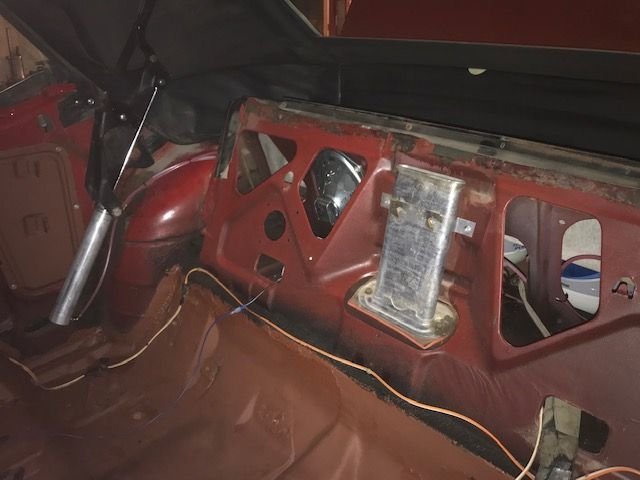

This silver colored thing is in center of back, behind the seat. Still don’t know the purpose of it?

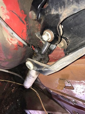

These lower convertible top bracket bolts were all just started in, and never tightened down.
Top of the left hydraulic cylinder shows signs of leaking.
I think that is where the (flat) wiring harness from under the dash comes up into the trunk through.
No - the wiring harness runs along the floor and into the trunk inside the flat BLACK PLASTIC channel shown towards the R side of the pic.
The silver/metal thing has steel fuel lines running inside of it...part of the evaporative "emission" control system used that year.

Like Patton said, that silver tower is the "vent" for the "ventless" fuel system. Basically a big air buffer to allow the tank to be vented to another reservoir, but not be vented to atmosphere. I think there are tubes with sponges in them running up it.

Ah, makes sense. Its been awhile (30 yrs) since I redid the interior of my '70 C/S 'vert, which apparently didn't get this thing. Now that I look closer at the pic, I see this is looking back towards the trunk, I was thinking it was from the trunk looking towards the interior. Either way, seems strange to route fuel vent lines into the interior. Or is this thing sealed off from the interior and the venting occurs from underneath?
Yes, it looks to be pretty well sealed up at the base. Glad you gentlemen replied back. I was thinking of doing an investigative removal, but knowing what it is, I think I will just leave it be.
